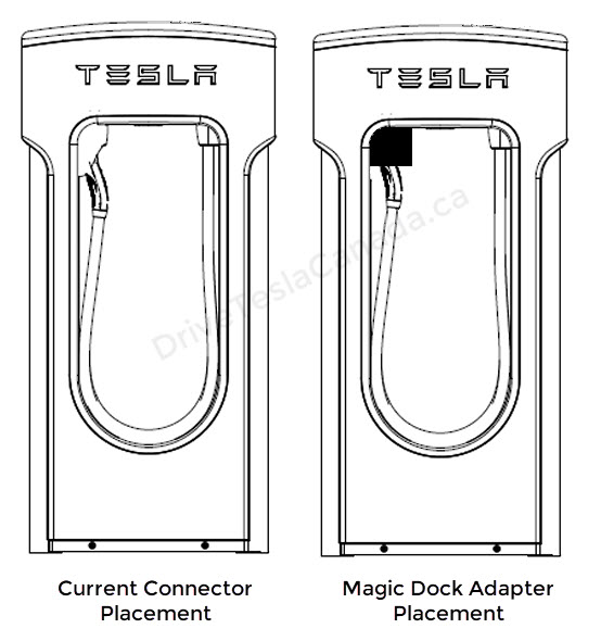

In reality, it sounds more like a cable with a CCS plug called Magic Dock (it's magic because Tesla can fit on the cable with an interchangeable Tesla or CCS plug):
“We’ve already opened Tesla Superchargers to other electric cars in Europe, and we intend to roll that out worldwide. It’s a little trickier in the US because we have a different connector than the rest of the industry, but we will be adding the rest of the industry connectors as an option to Superchargers in the US.”
An adapter would shift the cost to users which would be a financial way to go for Tesla.
In reality, it sounds more like a cable with a CCS plug:
