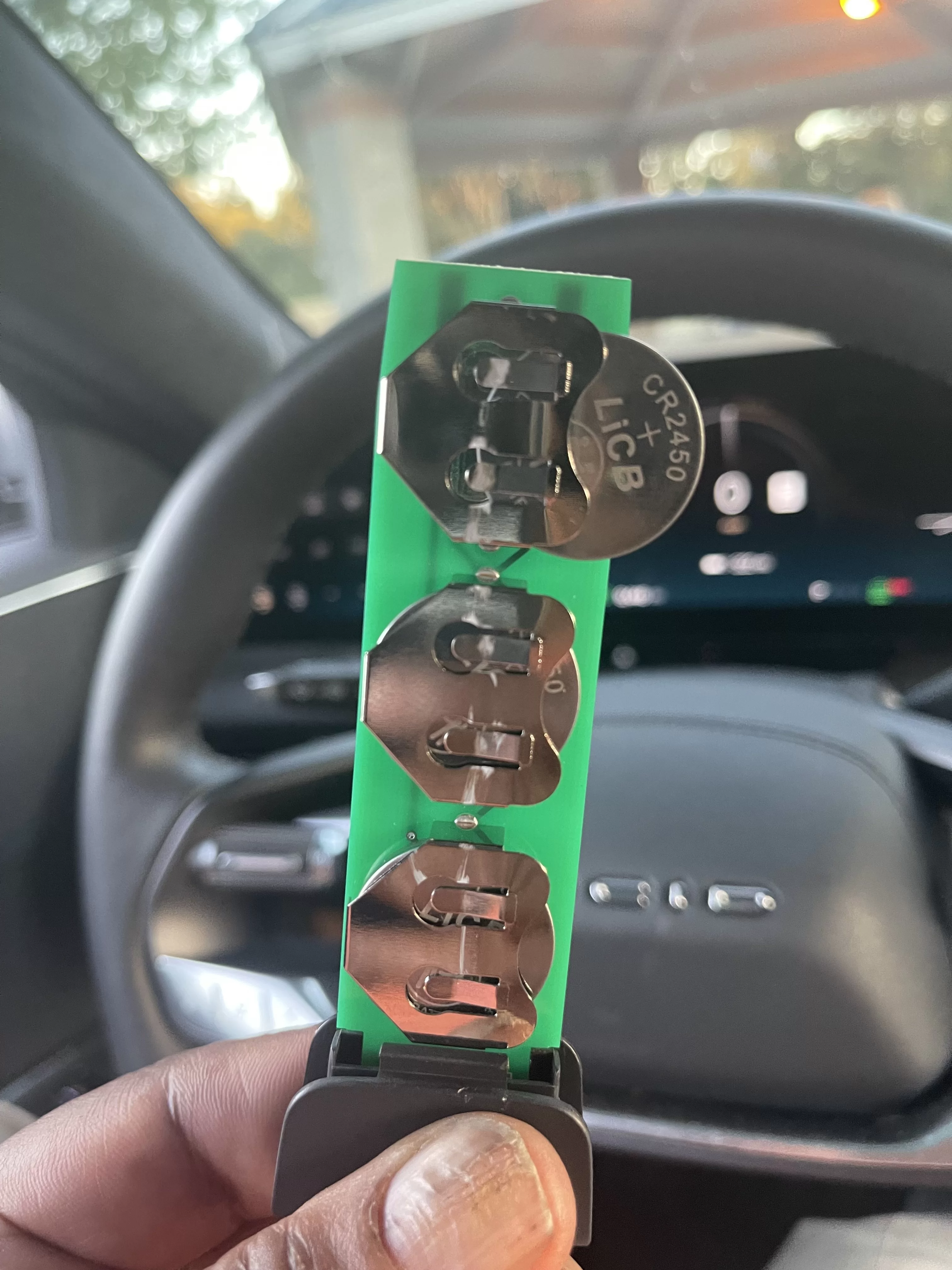

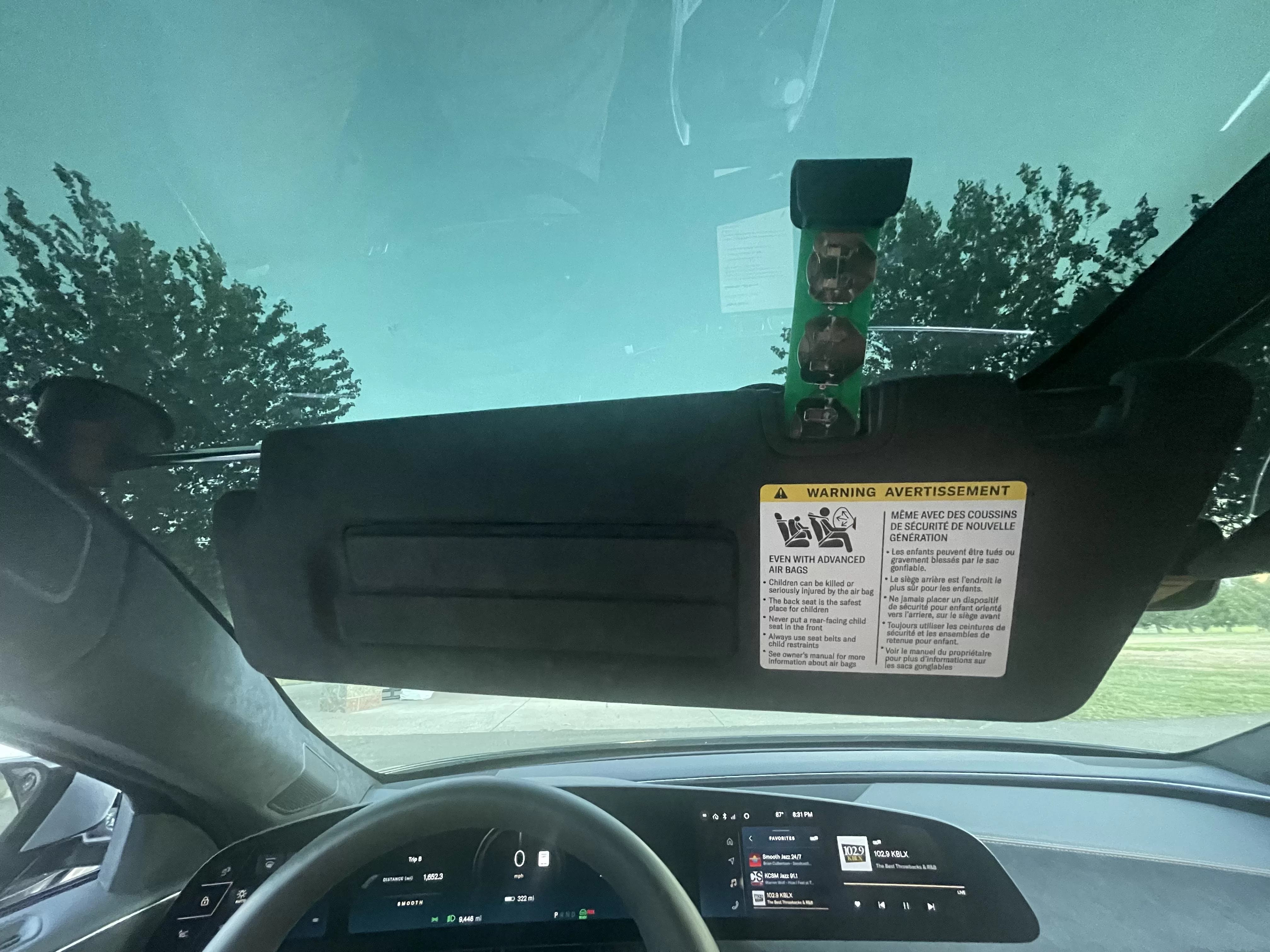

After looking in the user manual without success- nothing on the topic - I was about to contact support to get it fixed. Having studied the design of visor, I found that it had a battery compartment by gently prying it open. Yes, the batteries were dead. To check that the batteries were dead, I swapped out the two battery sleeves of the two visors and my hypothesis was correct. Each sleeve takes three CR2450 batteries

Pull it out. New batteries. Push it in. And, it is in the manual:
okay; thank you, I couldn't find it including the section shown but I will look again...

After looking in the user manual without success- nothing on the topic - I was about to contact support to get it fixed. Having studied the design of visor, I found that it had a battery compartment by gently prying it open. Yes, the batteries were dead. To check that the batteries were dead, I swapped out the two battery sleeves of the two visors and my hypothesis was correct. Each sleeve takes three CR2450 batteries View attachment 13927View attachment 13928
