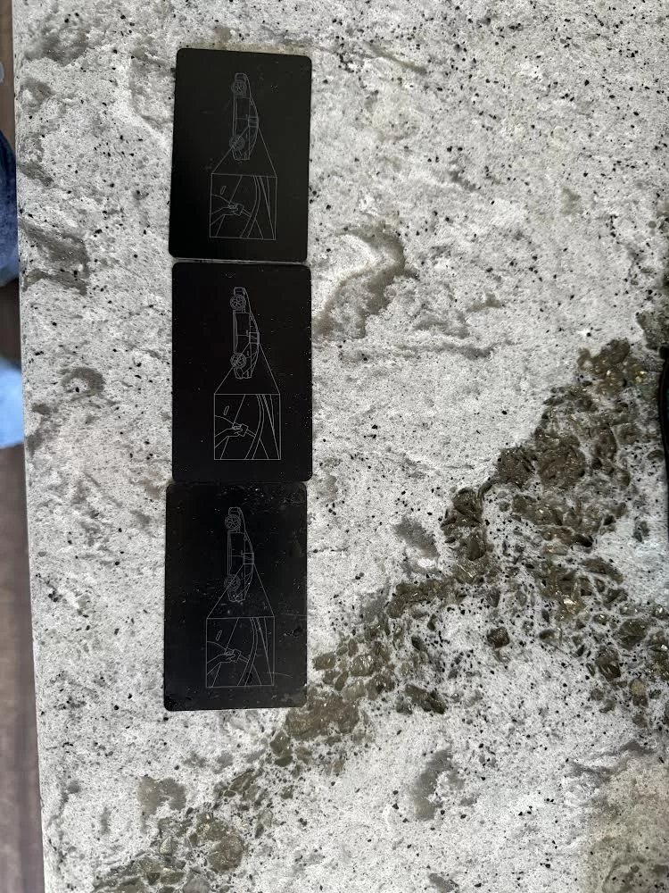

Very late follow-up on this. A few weeks ago I had misplaced my pocket knife. Looked everywhere and decided to check the car and get down and check between and under the seats. Found my pocket knife, I also found a third key card between the passenger seat and center console. Since taking that key card out, all of my problems have stopped. My phone and the fob work flawlessly now.
I am glad that it is fixed but the third card would not do anything since the card is NFC and the Fob/Mobile key are Bluetooth. Does the third card unlock your car?
