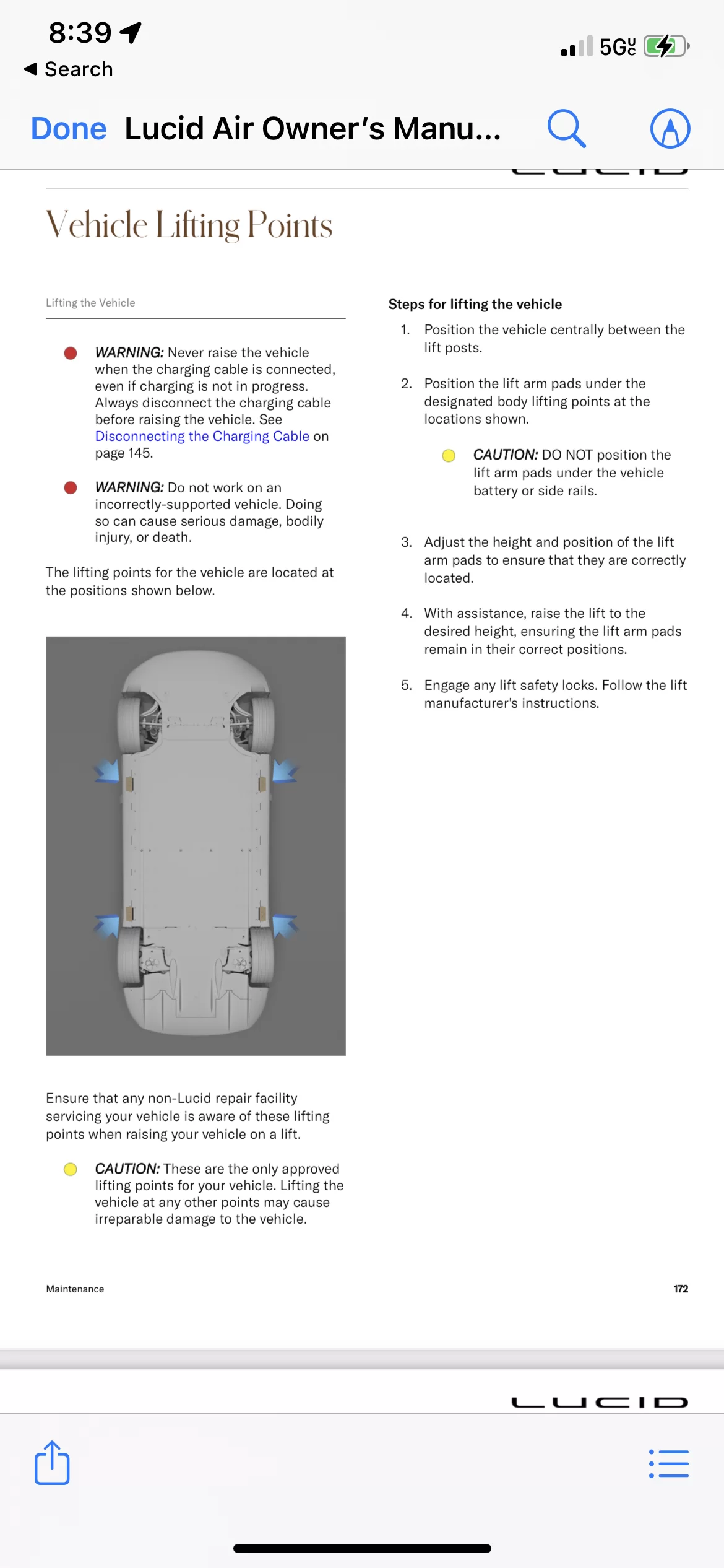

Found this in manual hope it was close. Thanks for the info! Sorry you are stuck!
