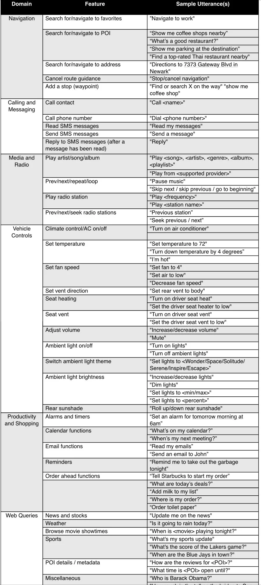

@hydbob and @duc900 , along with the above install instructions, here are the commands I could find. Credit to others on this site for the list. I printed it out and put in the car until I get comfortable with the commands I will be using. I have not attached files here before so I hope it uploads correctly.
I do have Alexa at home. This is not an exhaustive list. Alexa also appears to work on a more general basis like at home, eg, What is the weather?. But it is not Siri or Google assistant. (Interestingly, you can use both Hey Siri and Alexa with the phone in the center console cradle, works well), Nevertheless, I have been using it and it is quite accurate for the commands it recognizes. Hope this helps.
Good stuff! Appreciated.
