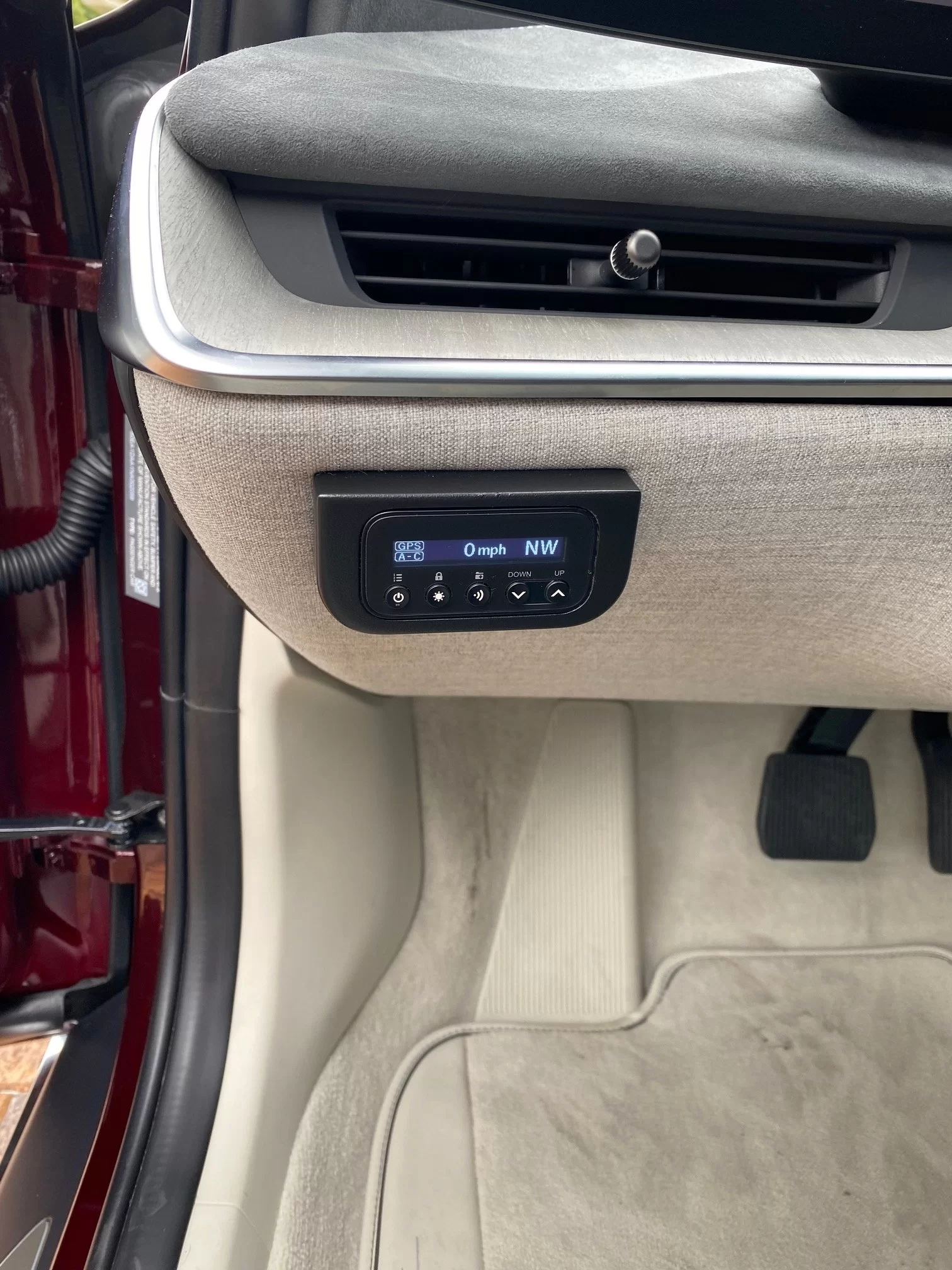

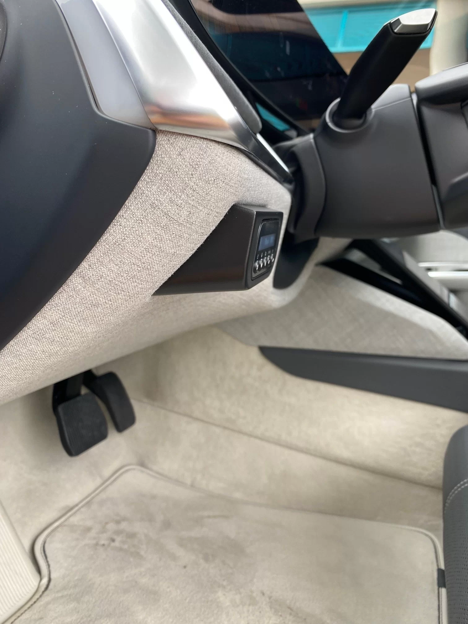

Now, here are some photos of the installation:

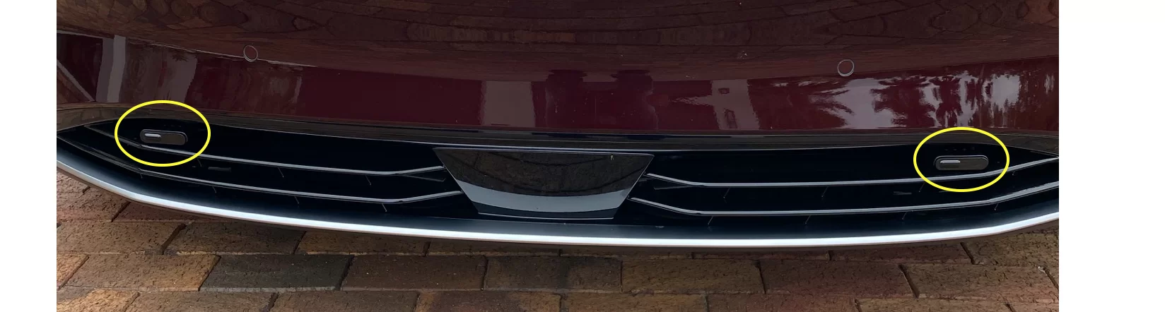

Front Laser Sensors:

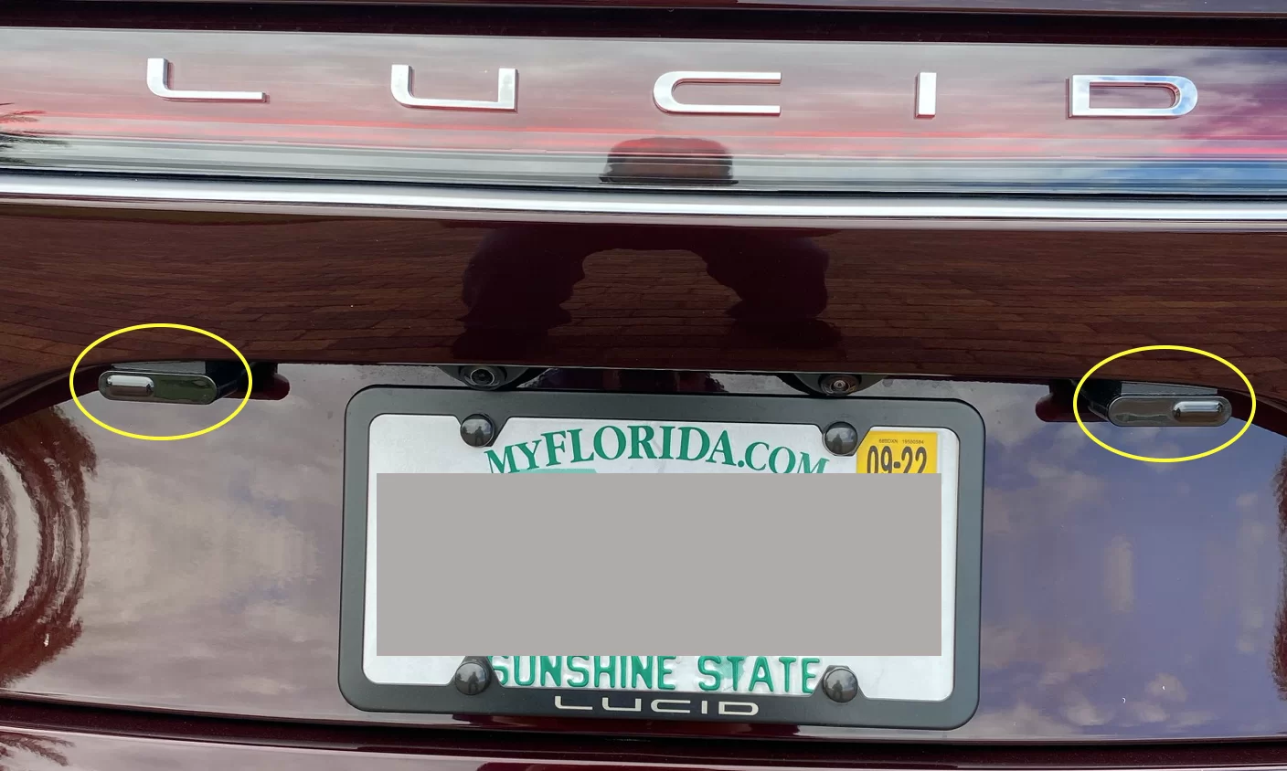

Rear Laser Sensors:

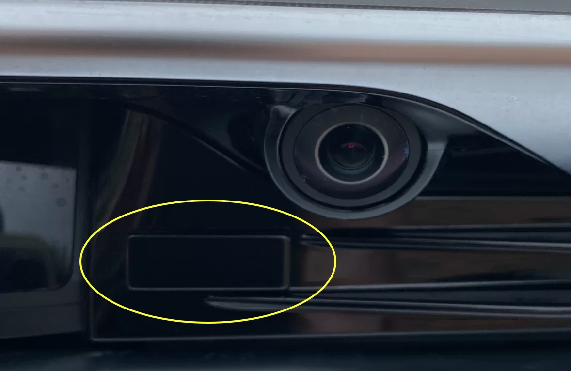

Front Radar Detector (rear detector is mounted behind the bumper cover):

Good to hear. Very clean install

Are you sure that’s the radar detector in the front? That looks, to me, like the TX piece of the ALP/Radenso laser: https://www.alpriorityusa.com/TX-Laser-Sensors.html
Given that radar passes through plastic, I’d be *really* surprised if it isn’t behind your front bumper.
I think you're right. I probably misunderstood what the installer told me.
