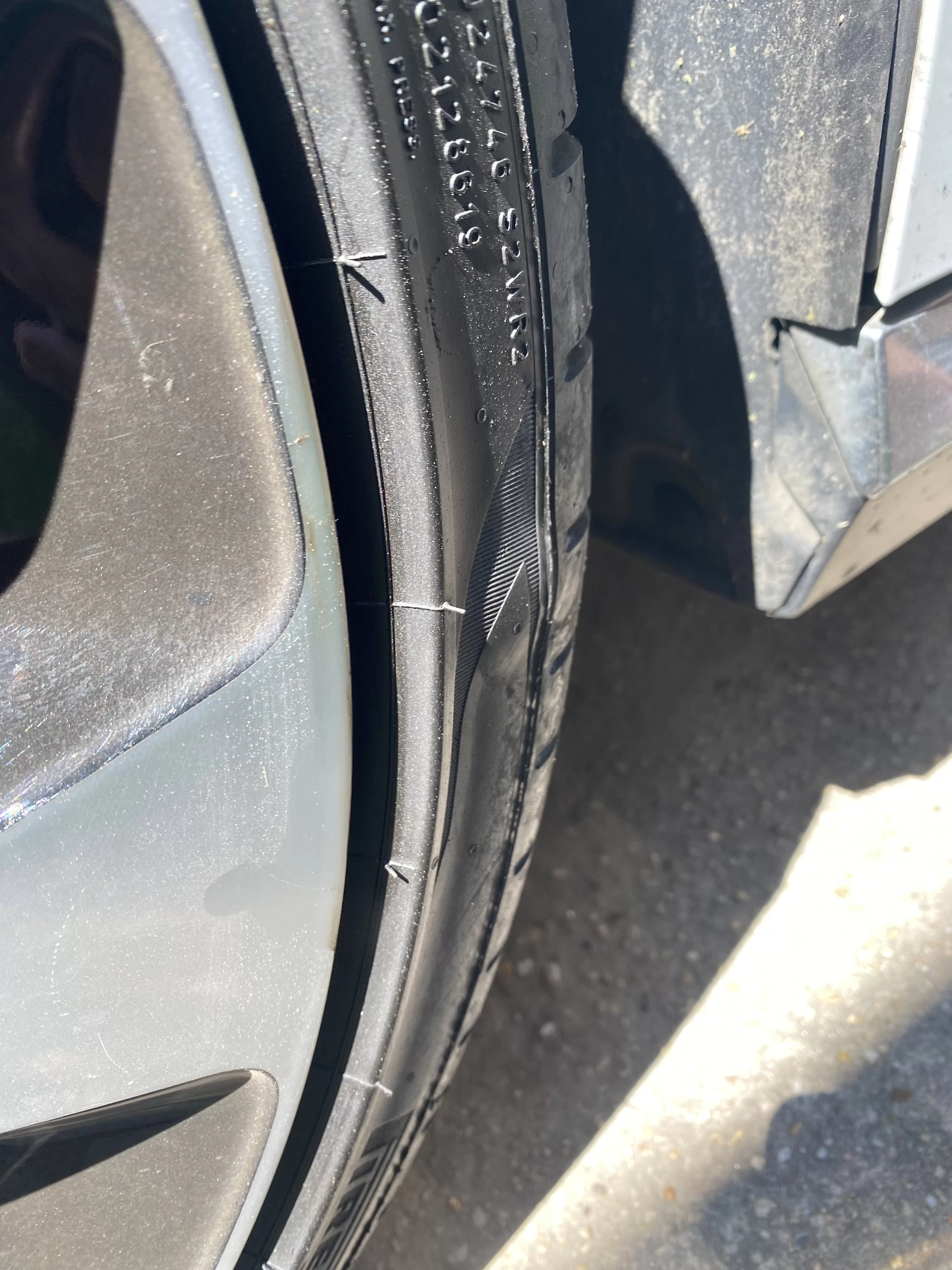

Whelp, my only reservation in buying a Lucid came true, Pirelli tire issues. I went to charge my car and just saw this. I didn’t even hit a pothole.
Can anyone tell me the best way to get Lucid’s involvement in getting this replaced? When I went to register with Pirelli, Lucid wasn’t a named manufacturer.

I’ve never had this problem with any other thin walled tire. It’s not a matter of if it will happen, it’s when, and today my number came up.
Yes. The loaner is the picture above. Here is our car right now:
So it's hard to tell from the side picture like this, but a tiny bump is actually normal as the Pirelli authorized dealer told me. A big pronounced bump is caused by potholes or damage to the side wall as another post above clarifies from the service center. I'd get it replaced.
