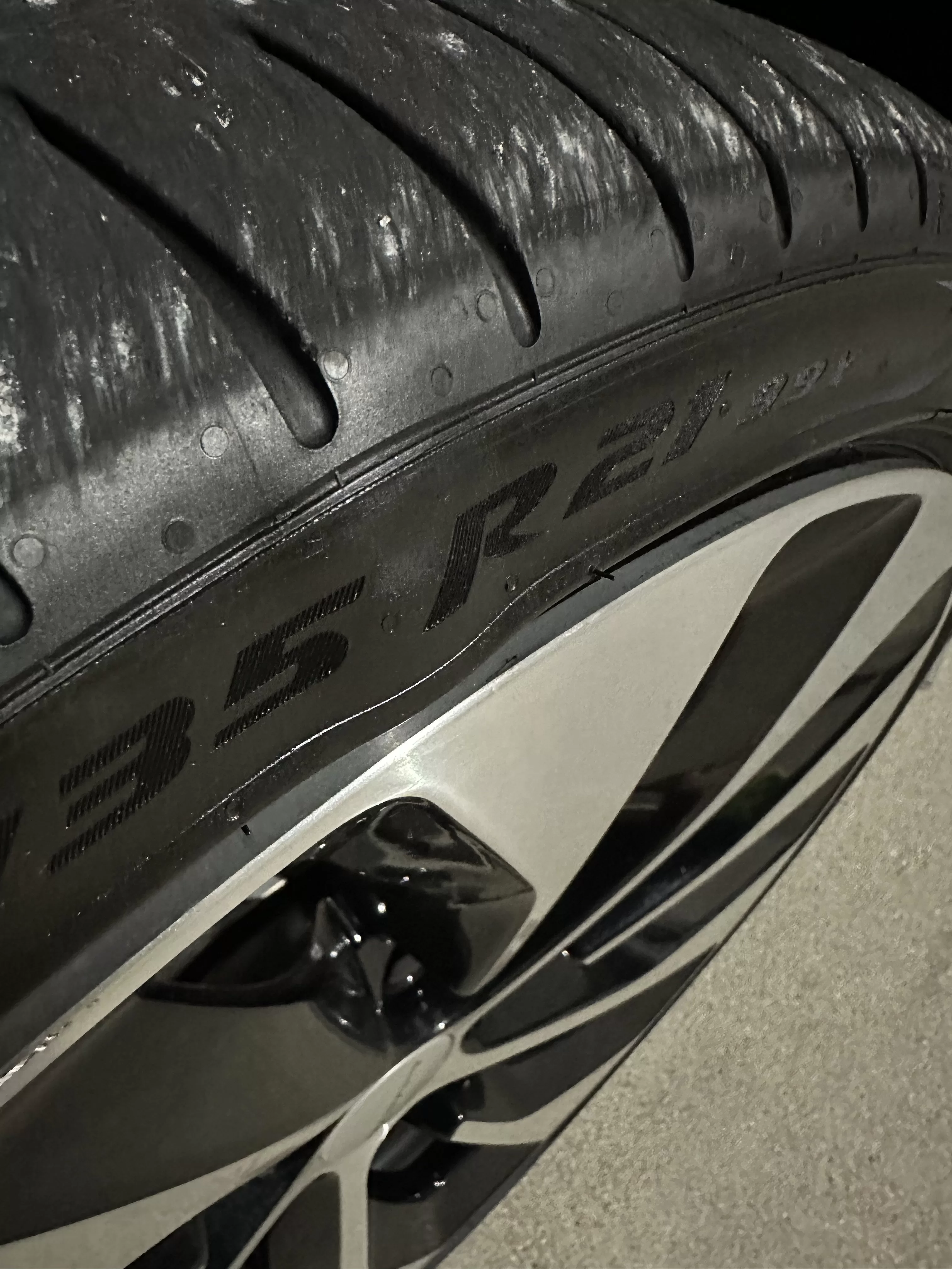

Fabulous idea and just added #17Having the same issue with my Air GT. Both front tires have bubbles. Replaced the front driver because it was terrible, and now another bubble on the new tire. Waiting to hear back from my Lucid Service Center Rep who I connected with Pirelli via email. I have hit a total of zero potholes. These tires are terrible. There should be a recall. Even if just counting the number of complaints on this little forum, we are probably looking at at least a 1 % failure rate which is just too high for such an expensive tire. I'm happy to start a petition to have LUCID come up with a better solution. Paying 150-170k for a car and having poor wheel/ tire longevity is not compatible, specifically when it's a "Touring" sedan without a spare. What does the hive mind think?

Looks like #3 leaves me SOLI noticed two sidewall bubbles on my Pure's rear passenger side 19" Pirelli tire within a week of ownership that made my tire look like it had testicles. I did not hit any potholes, and there is no rim damage also. Here's what I learned:
1. Lucid service centers, at this time, are NOT authorized Pirelli dealers. If you are attempting to claim warranty with Pirelli, replacing your affected tire at a Lucid service center decreases your chances of successfully claiming warranty with Pirelli.
2. The affected tire must be inspected as is on its wheel by a authorized Pirelli dealer. Use this authorized Pirelli dealers locator. Do not attempt to remove/replace the tire off its wheel without an authorized Pirelli dealer, as this can void the warranty.
3. The Pirelli's seem very prone to sidewall bubbling, the warranty covers only up to a 1 year after receiving your vehicle or after 2/32" of usable tread. Highly recommend a road hazard warranty with an authorized Pirelli dealer. I got mines warrantied from America's Tire for $40 per tire.

Wait, is this in addition to the "Same on a loaner recently"?I have a bulge now on the GT….
So to clarify... you had a loaner Lucid with a Pirelli sidewall bulge and now one of your very own Lucids ALSO has a bulge?Yes. The loaner is the picture above. Here is our car right now:
Yes! Crazy! Both had bulges. Both front right, too.So to clarify... you had a loaner Lucid with a Pirelli sidewall bulge and now one of your very own Lucids ALSO has a bulge?![]()
