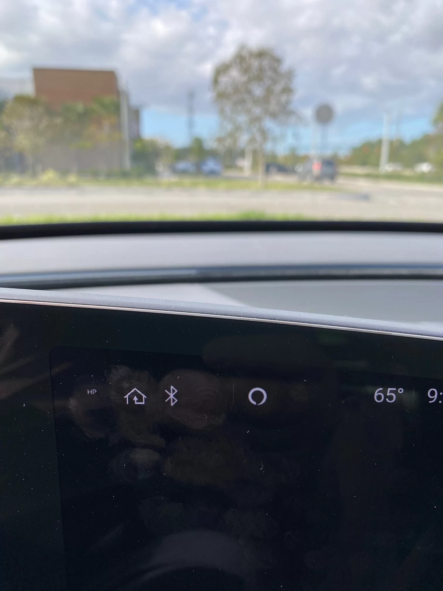

That's good and bad but really good. Sounds like they pinpointed your issue to the module responsible for LTE reception which will hopefully fix your Alexa issues. Glad it's moving along.No. And today, for the first time since the mobile techs flushed and replaced the computer coolant, the Pilot Screen froze again. Also, Alexa, as usual, was declining to call up any music. Although I was in a strong cell signal area, the car was showing zero signal strength.
I pulled into a grocery store parking lot to take this picture. You can see that the car was not displaying any cell phone or WiFi signal at all. It's a bit fuzzy, but that slender line just to the left of the oak tree is the cell phone tower I was looking at from the car. Lucid uses AT&T, and that tower transmits an AT&T signal.
I called Lucid Customer Service, and they told me to attempt a soft reset. I did, and nothing corrected. So we did a second soft reset. At that point the Pilot Screen unfroze, and the car was displaying four bars of cell phone strength (as it should, given it was parked right in front of the tower).
Lucid has decided a computer module needs to be replaced, but it is not a mobile repair. When the part arrives, the car is going to have to be transported over to the east coast of Florida.
