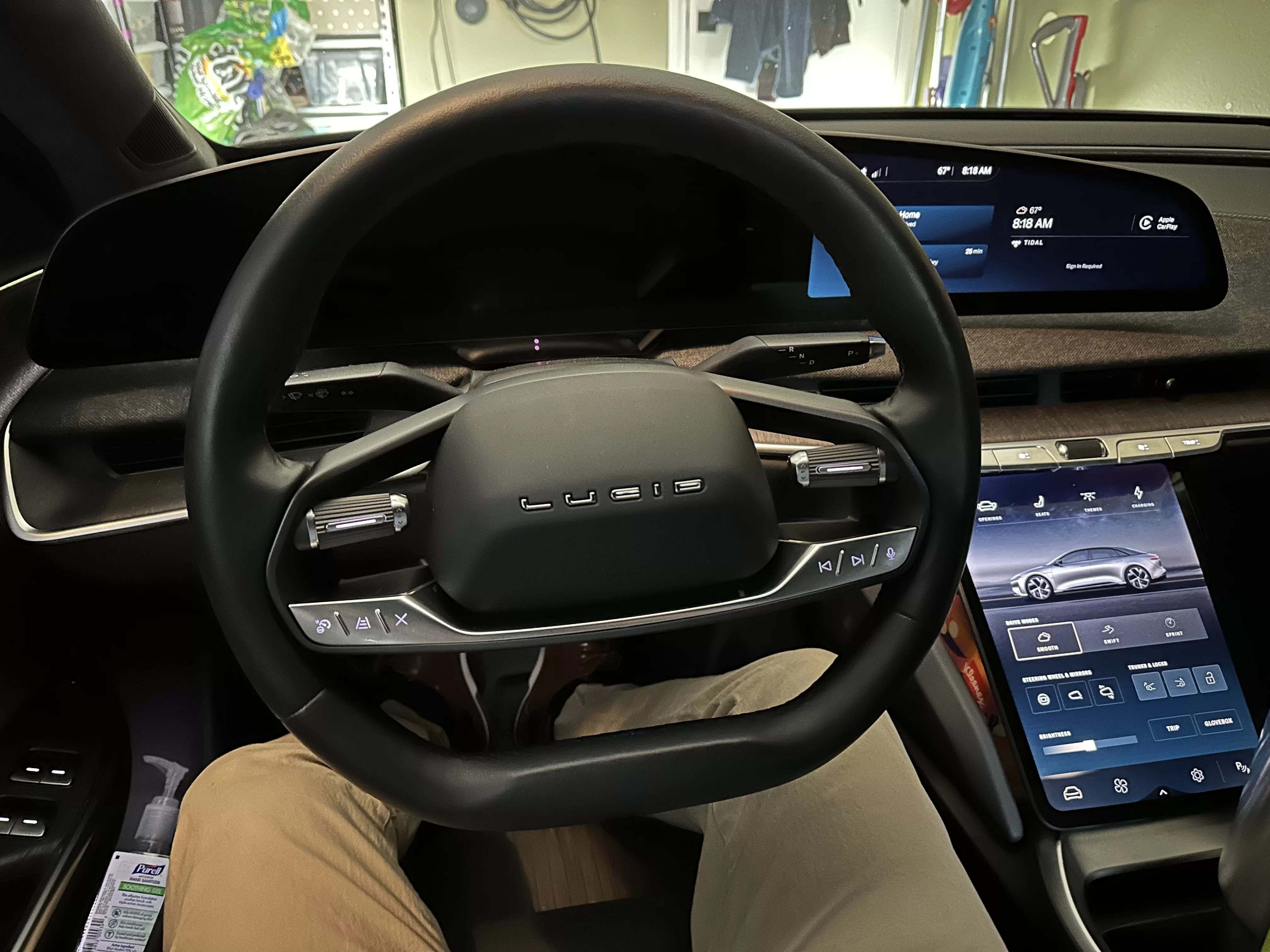

Anyone else having issues with the heated steering wheel since 2.6 update? Mine won’t stay on anymore. If I click on the button, it goes on and then immediately turns off. Software reset did not fix it.
For those having this issue, I found on a reddit thread that you can get the heated wheel to stay on by rapidly, repeatedly tapping the button for a few seconds. Stupid thing to have to do, but it works. The issue that remains is that the wheel heater doesn't come on when you try to heat your car with the phone app to be warmed when you get in. My seat heat doesn't turn on remotely, either, but that at least works reliably from the car's screen.
