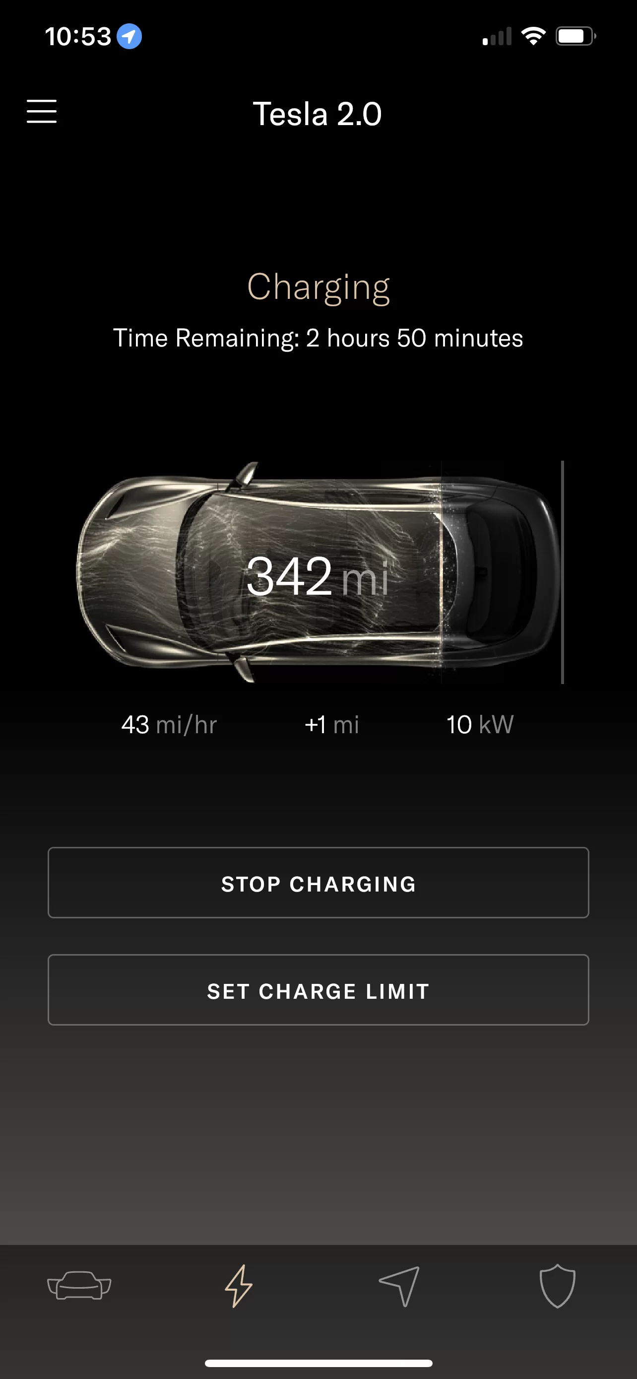

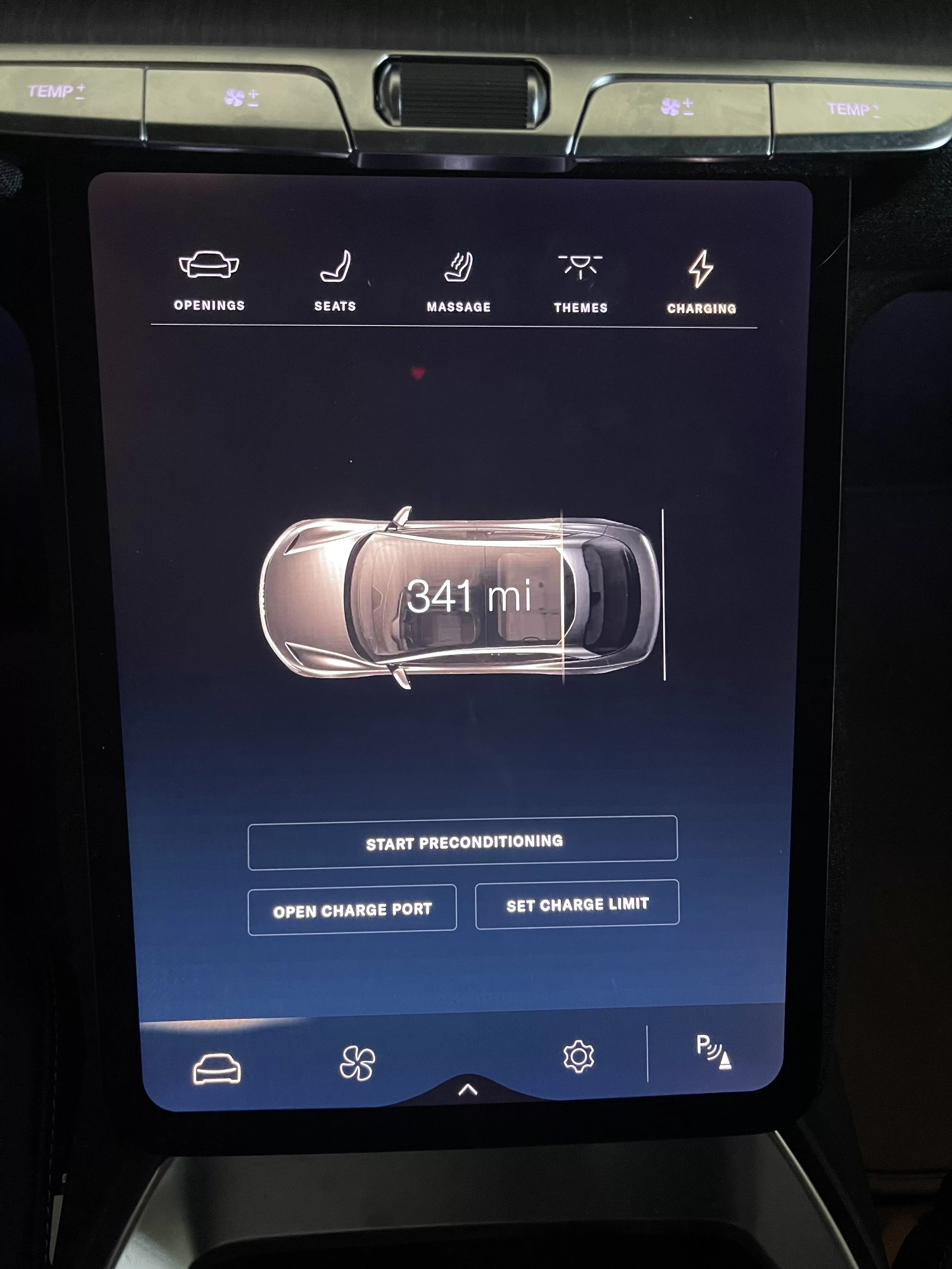

GT 21” at 100% SOC is 460 mi on 1.2.9 version.
Waiting on 1.2.10 to open to me
