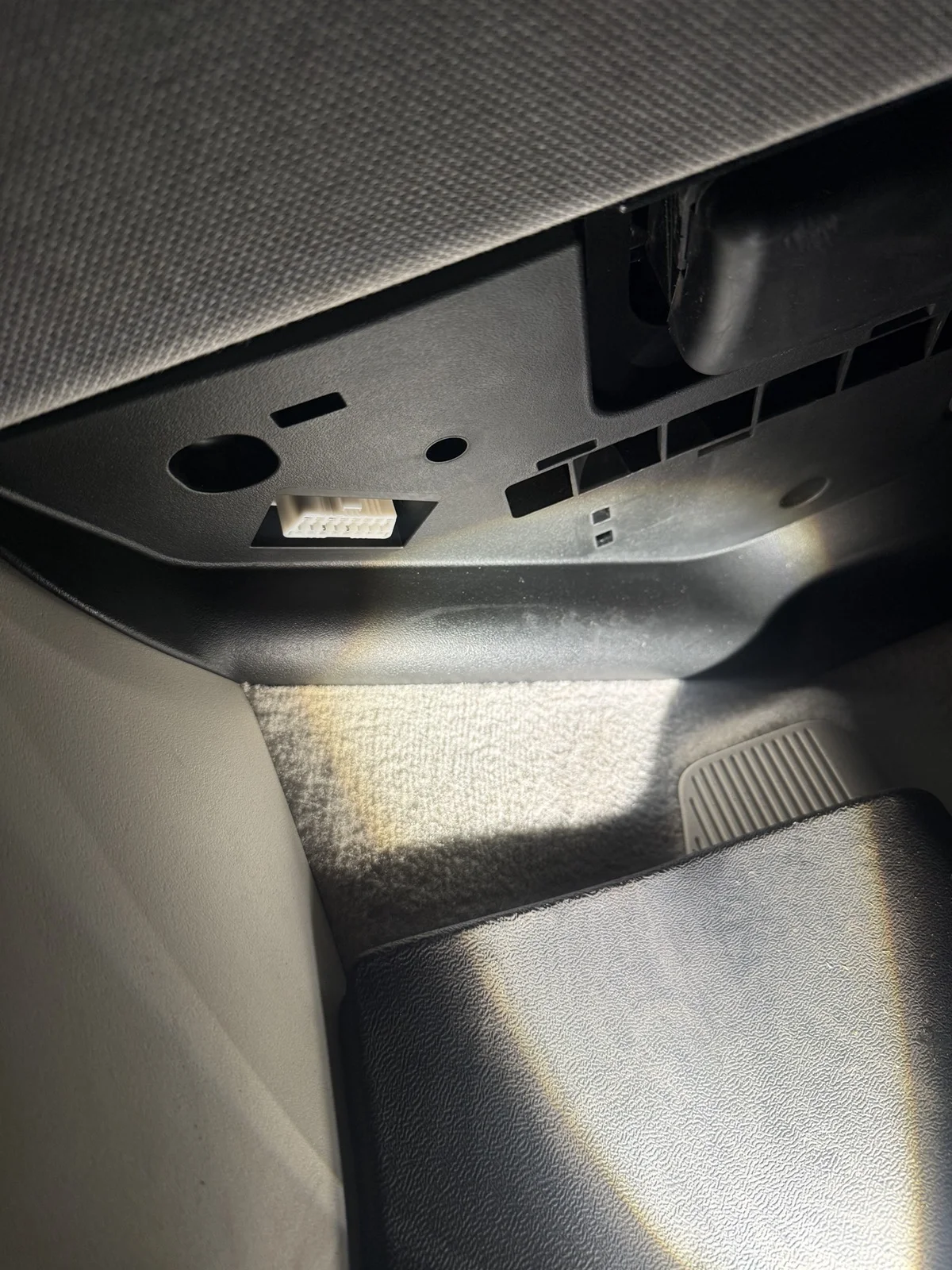

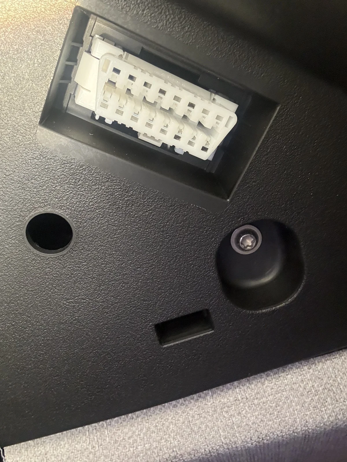

OBDII port
The Air does not have a classic OBD II port

I believe every car or truck on the road manufactured after 1996 is legally mandated to have one installed. How does Lucid get around the regulation?
These ports were intended for checking emissions systems. Since the Lucid has no emissions, it isn't required to have an OBD II port.
Instead, it has an Ethernet port in the trunk that can be connected to a laptop. However, the in-car systems will not actually interact with the laptop without the Lucid servers commanding the car to bypass its local 802.1x security, at the request of the service tech.
