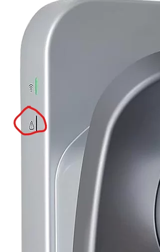

Hi! We just brought home our new baby Lucid Air and they told us our Chargepoint home charger (which we installed to charge our previous Jaguar I-Pace and current Cadillac Lyriq ) would work just fine . . but alas. It won't charge the car. Is this just a thing? Do we need to invest in a Lucid charger now? Or does anyone have any suggestions on settings we can play with to make these things compatible? I would rather not have to get a new charger . . .as it is, the new car is already in the shop for 10 days because the Apple CarPlay and other items are all screwy. Sigh.

Don't try scheduling charging from the Chargepoint. The Air has an AC charging operation design flaw and will not work with charger-side scheduling.
Schedule charging from the car only. Leave the Chargepoint operating without a schedule.
Exactly, I had the same issue. Once I turned off schedule on Chargepoint app, it works.
