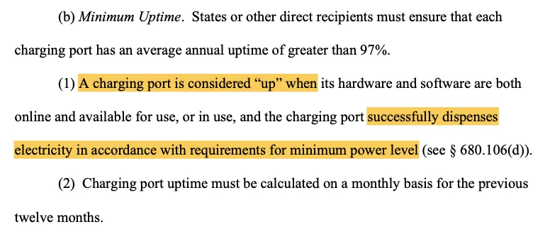

For those interested in the details, the final ruling on minimum standards for NEVI-funded charging stations. It's encouraging.
Also, what’s considered “minimum power level?”
> O kW?
In general, the rules are asking for 150kW and 1000v operation for DCFC.

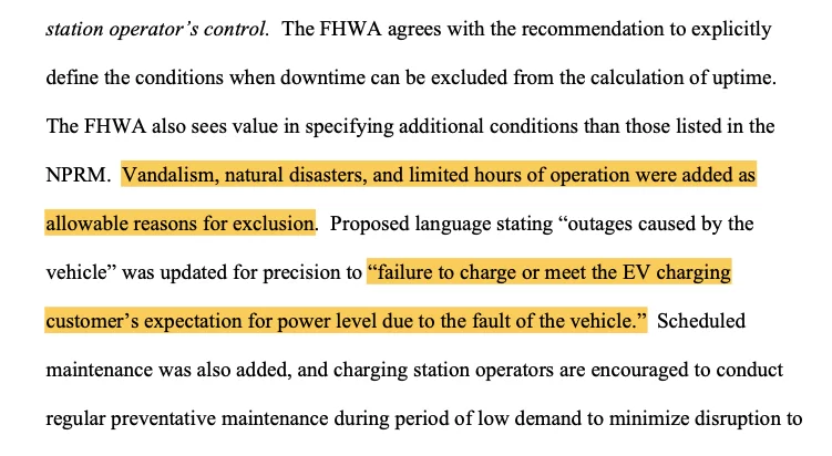

Is vandalism defined for the purpose of that rule? I suspect there will be an entirely unanticipated uptick in "vandalism", completely unrelated to the 97% requirement.
