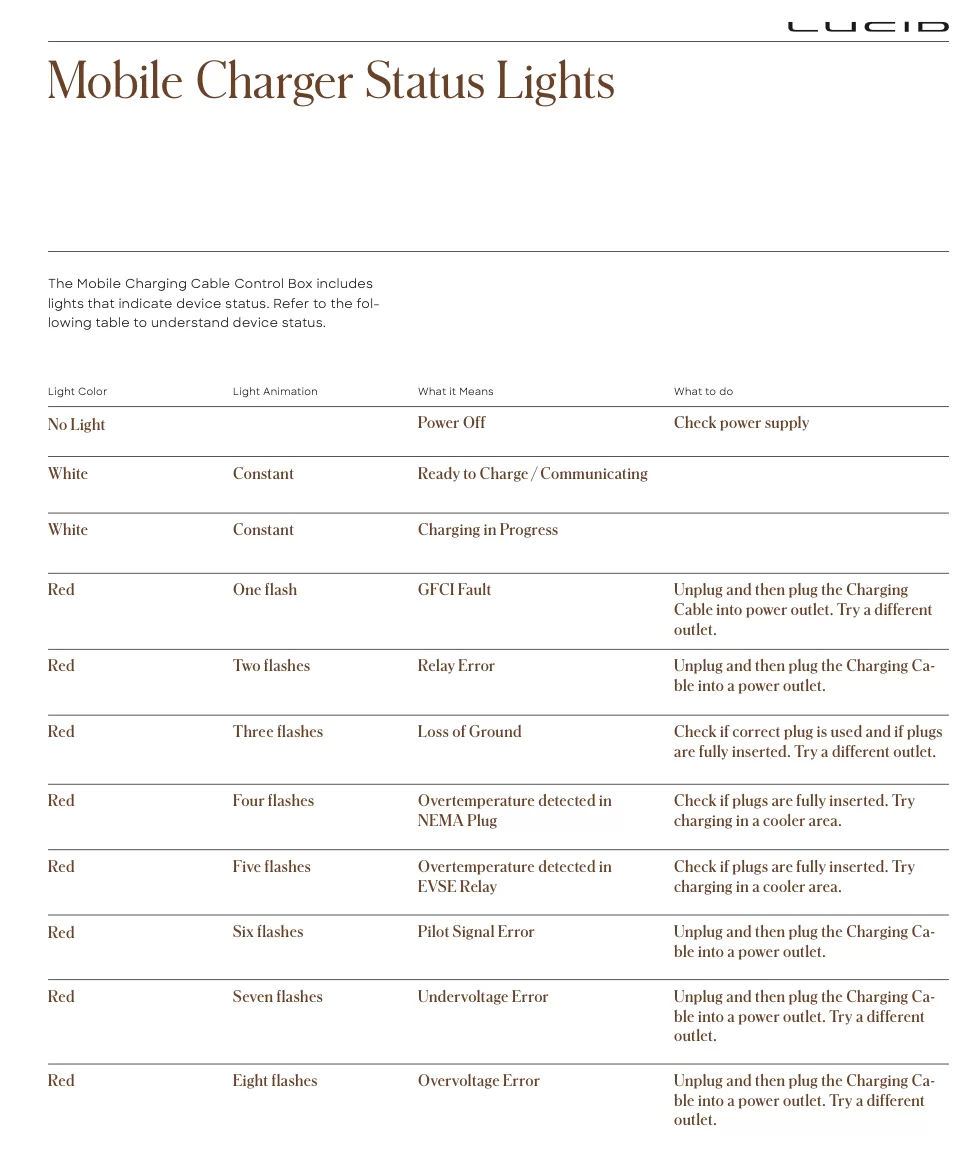

How many red flashes did you see on the mobile charger? The error codes are shown below:

Had similar issue with blinking red LUCID on charger at home. Was instructed to bring the charging cable to Costa Mesa service center to test. Yup it was a defective cable and they gave Juno 🐻‍❄️ (AGT) a replacement. It now is working properly. Hopefully it’s a simple fix for you. Enjoy your new Air Grand Touring !
