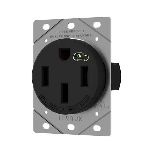

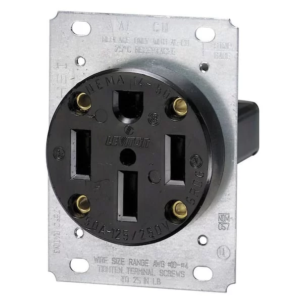

Sorry, I meant - can you flip off the breaker, unscrew those four screws, and take a picture of the receptacle without the faceplate? You’re basically trying to see if it looks like:
If so, you’ve got the wrong receptacle installed. Leviton appears to make a heavy duty EV-rated one now that has a little car icon on it:
Or you can get a commercial/industrial one from Bryant or Hubbell:

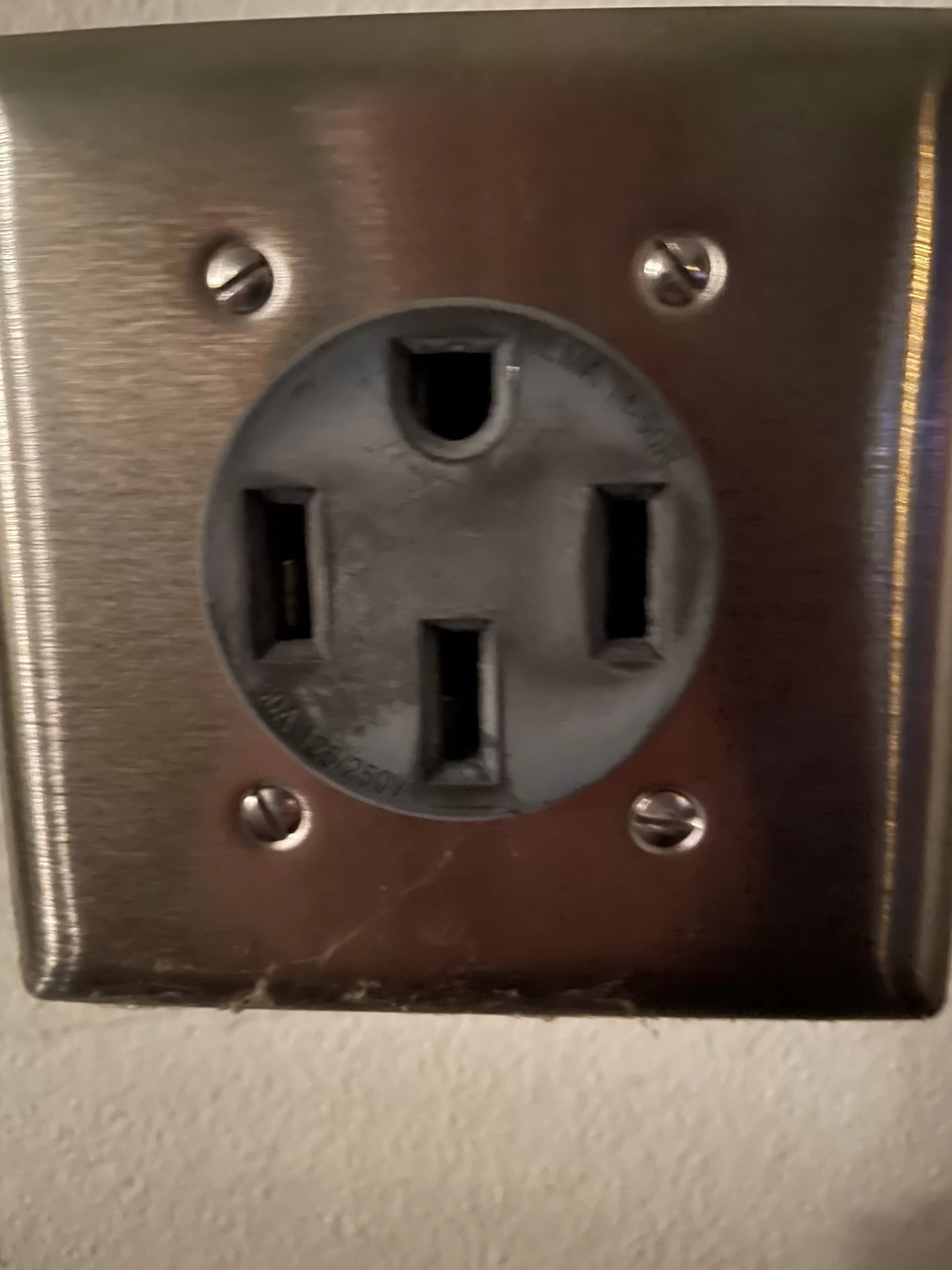

Can’t confirm without the faceplate off but it does look like a cheaper version from big box stores most suitable for dryers versus constant high draw for EV charging. @Viking have you noticed your Lucid charger blinking red when charging stops? You will see it if you happen to see it pretty close to when it stopped charging.

Here it is
Agreeing with @tonybot - you can tell from the relatively small diameter of the round plastic face that it's not a heavy-duty industrial/EV-rated receptacle.
Light-duty 14-50 receptacles have a 2.1 inch diameter face, nearly the same width as the distance between the visible cover plate screws above it. Industrial/EV 14-50 receptacles have a 2.4 inch diameter face, noticeably wider than the mounting screw spacing.
Even it it's not the problem today, if your receptacle has a 2.1-inch face, it needs to be replaced ASAP with the right type of 14-50R and a matching cover plate.
But I think there's a pretty good chance your receptacle is the problem.

Thanks. Took some alcohol, Q-tips and a straw brush. Cleaned a lot of grime from the plug. Reset circuit breaker and it now seems to work. Hopefully not just St a one time fix.
After measuring I have the light-duty (2.1") receptacle face.
I suspect it is the problem and the mobile charger is shutting down to prevent fire as the receptacle overheats. Even if it isn't the problem today though, it is unsafe. It's an easy swap to the proper receptacle and faceplate, as long as the junction box behind it isn't small or shallow.
