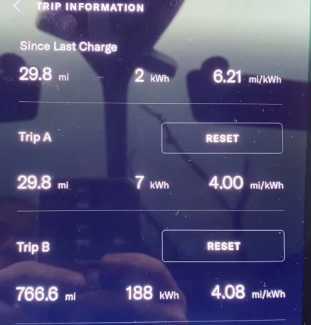

Miles/Kwh
I did this recently too, I feel trip A is looking for some condition to reset and start counting KW if you reset it on the move. Ie like you need to be below some certain speed before it restarts.
It will not display values over 6.21
The good news is that it does store the data above 6.21 miles/kWh for the overall trip calculation. After a really long slog downhill at 6.21 miles/kWh, I started back uphill, and was surprised at how long I drove before the 6.21 finally ticked down. My real miles/kWh on the downhill must have been quite high.
But the implied actual performance then, if this wasn't wonky, is 9 miles/kWh. (28 miles/ 3 Kwh) That seems...um impossible, unless my commute was entirely downhill 🤣 (Which it isn't :)
@Westchester Air 's commute:
Ok...so charged her back up to 80% overnight. She took 16 kWh. So, I see the implication as follows:
  • First leg of commute, I recall taking 9 kWh and 28 miles. This would have been about a 3.1 mi/kWh, including "non-driving" drain.
  • Second leg, based on the actual recharge was about 7kWh and also 28 miles. This is about 4 mi/kWh (not 6.21).
  • Total trip 16 kWh for 57 miles or about 3.56 mi/kWh, not the 4.65 on the readout.
Very strange. i assume like in other areas, something froze up on the Trip Info. I'll monitor going forward and/or do a quick reboot.
