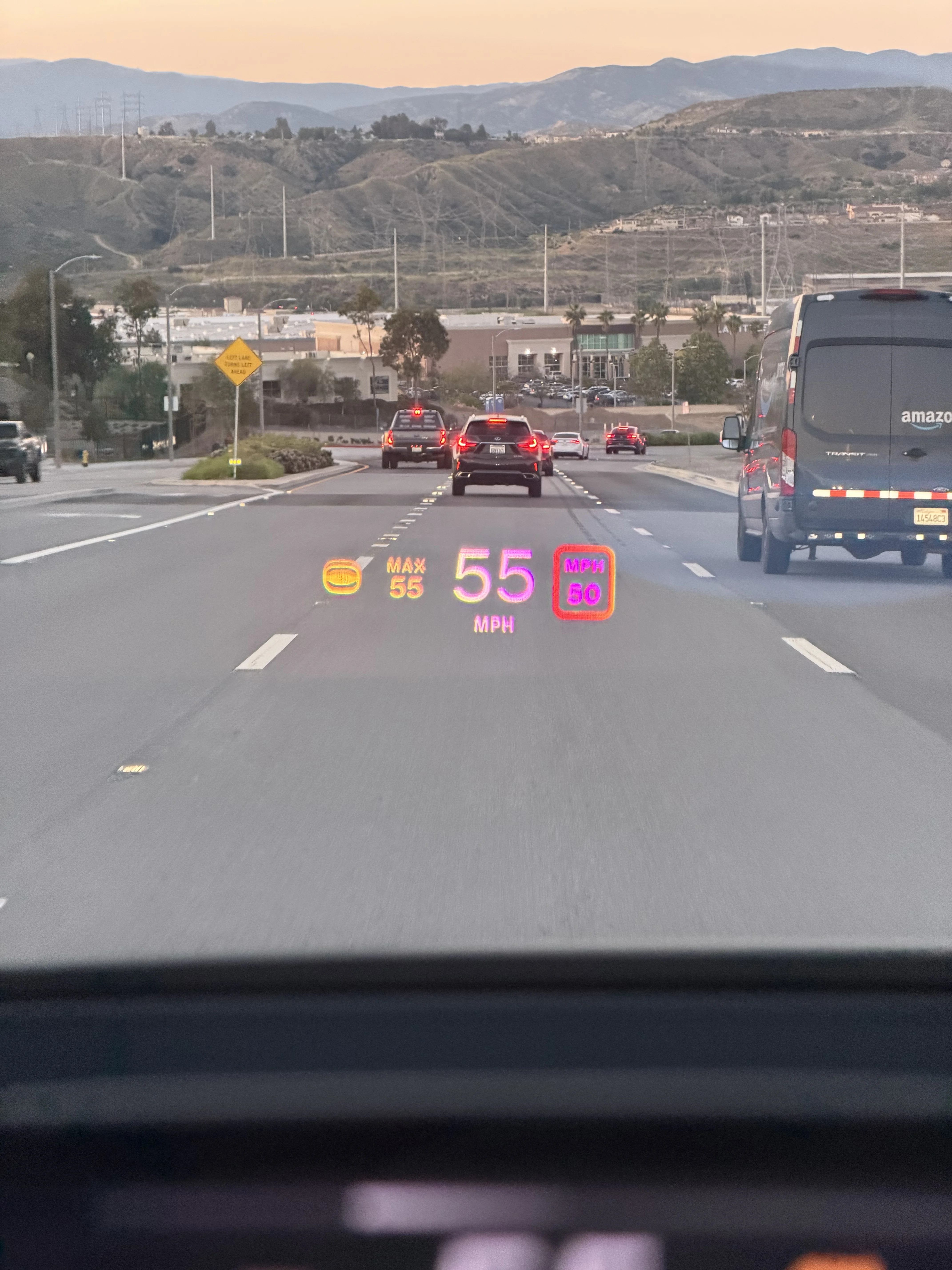

Waiting for recall for blinding HUD 😅
I finally experienced what I think you are referring to in my trip to Tahoe. Is it like a bright vertical bar, top to bottom, that crosses the screen when the sun hits it just right? Very odd and wish I had been able to make video of it. I’ve never had a HUD that reflects like this one does. 😕
Several different scenarios, that one is a bit rare. The most common one I see is during cloudy or dawn/dusk or in a parking garage kind of low-mid light scenario, the background of the projection becomes like purple square as if it doesn't know how to transparently match the background.
Attached my recent pic but it often is completely solid background purple so you can't see pretty much the most important area lol

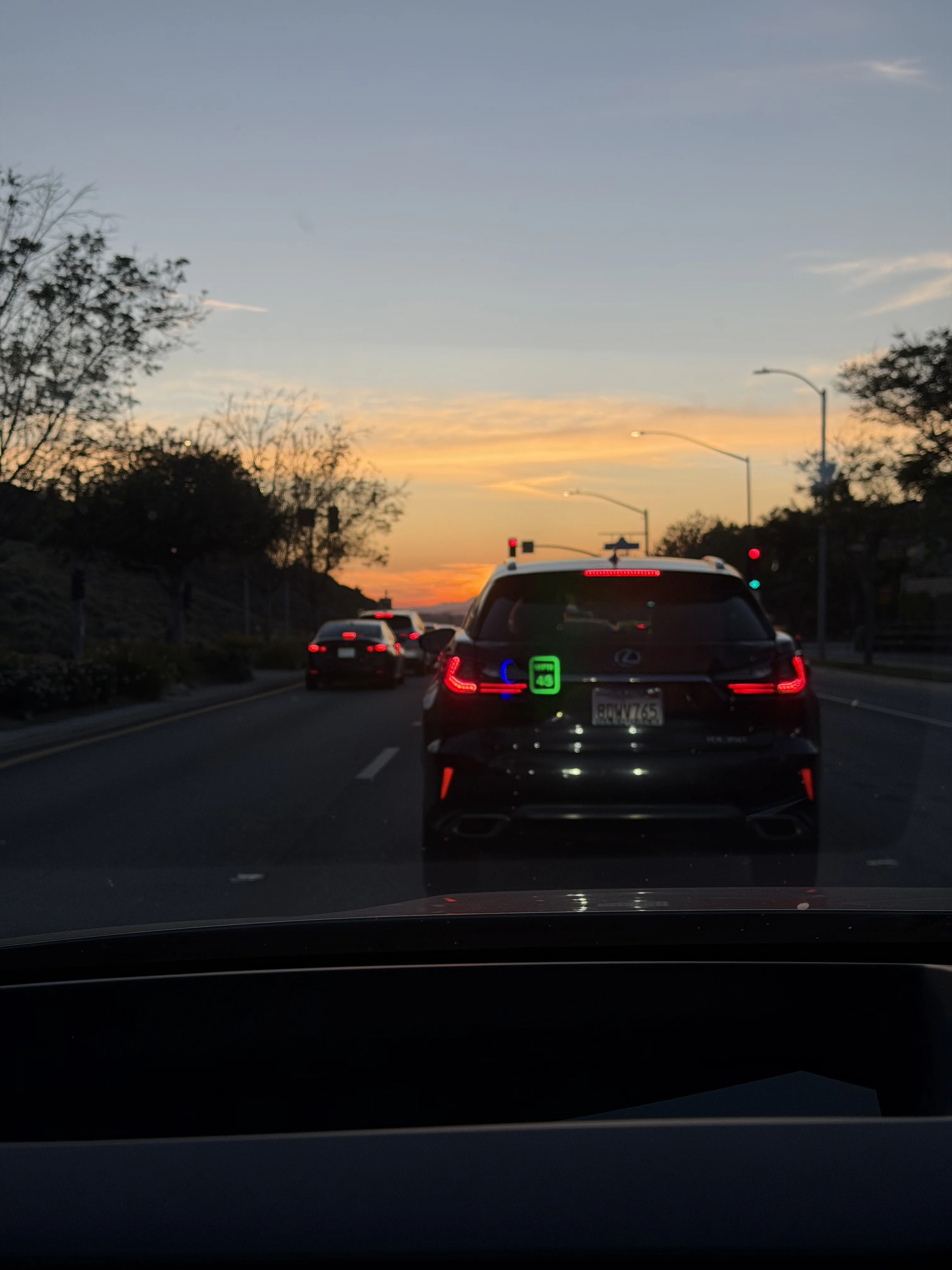

Yeah this happens to me multiple times at night. The square goes into flashing mode, fading in and out at 100% brightness creating an entire white block in your line of sight. Can also give you an idea of how obnoxiously high the projection sits when behind a car and how large the text becomes when driving because it's being stretched, tilt your head forward and it becomes in focus and smaller. This is with the seat in the lowest position. Funnily enough, I can raise the projection above the cars in front roofline which is less distracting but it just looks plain stupid!
