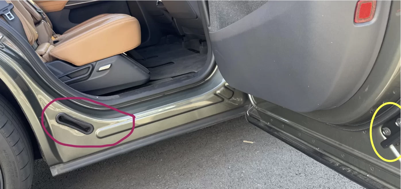

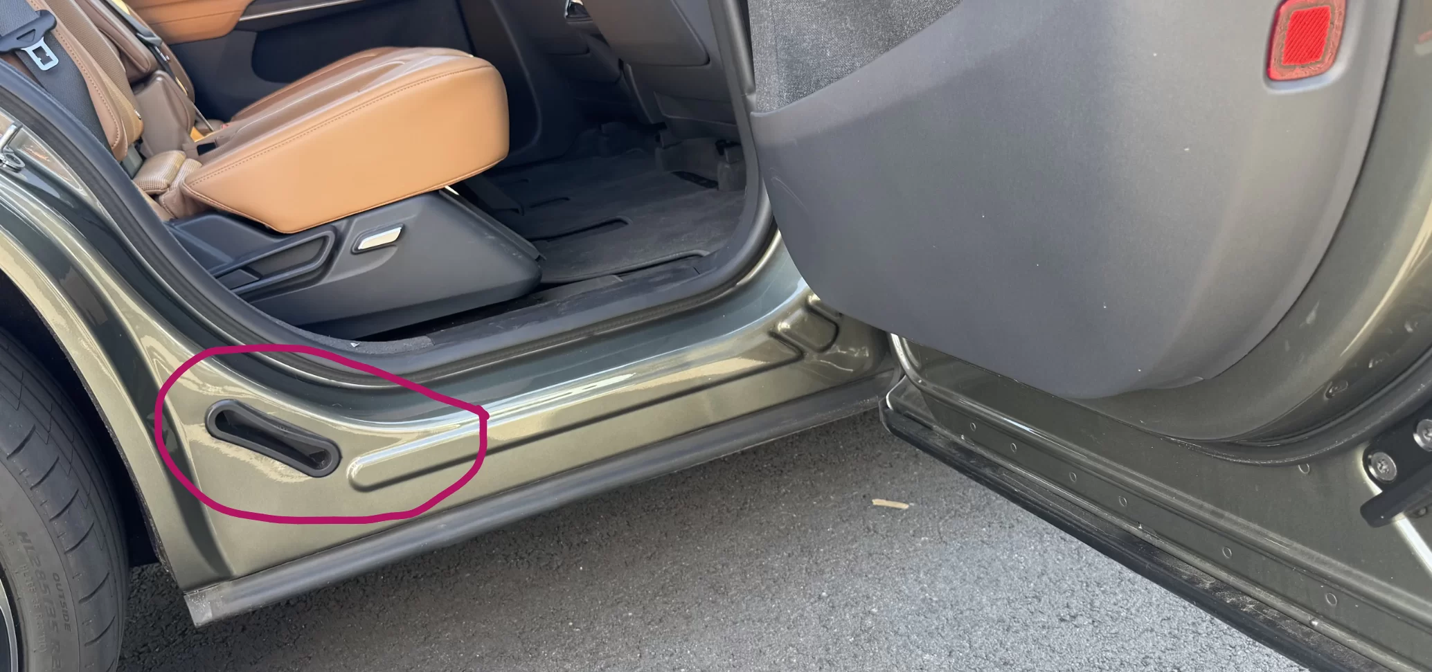

I was wondering the same.Looks like a door guide, my bet is to improve crash ratings
Is it part of the soft-close feature?
Those are usually part of the lock mechanism so I think it’s just to keep the door in place during impact so it doesn’t shift under load.I was wondering the same.

I think you are right about it having something to do with locking/keeping the door in place as one can see at the bottom right edge of the picture that there appears to be part of a matching feature on the inside of the door that could insert into that slot in the body. (With some plastic/rubber to reduce rattling sounds inserted)Looks like a door guide, my bet is to improve crash ratings
It looks like that bar on the door at the lower right of the image slides into it.I have a Gravity design question. What is the purpose of this slot behind the rear door? I've never seen that on a vehicle before.
Saw that.It looks like that bar on the door at the lower right of the image slides into it.
Yeah I've seen a similar design on Subarus. Probably to keep door from collapsing inward during a side impact.I think you are right about it having something to do with locking/keeping the door in place as one can see at the bottom right edge of the picture that there appears to be part of a matching feature on the inside of the door that could insert into that slot in the body. (With some plastic/rubber to reduce rattling sounds inserted)

“Lucid Gravity: The SUV that turns physics into poetry.”I have a Gravity design question. What is the purpose of this slot behind the rear door? I've never seen that on a vehicle before.
Yep, it must have something to do with an impact locking mechanism:

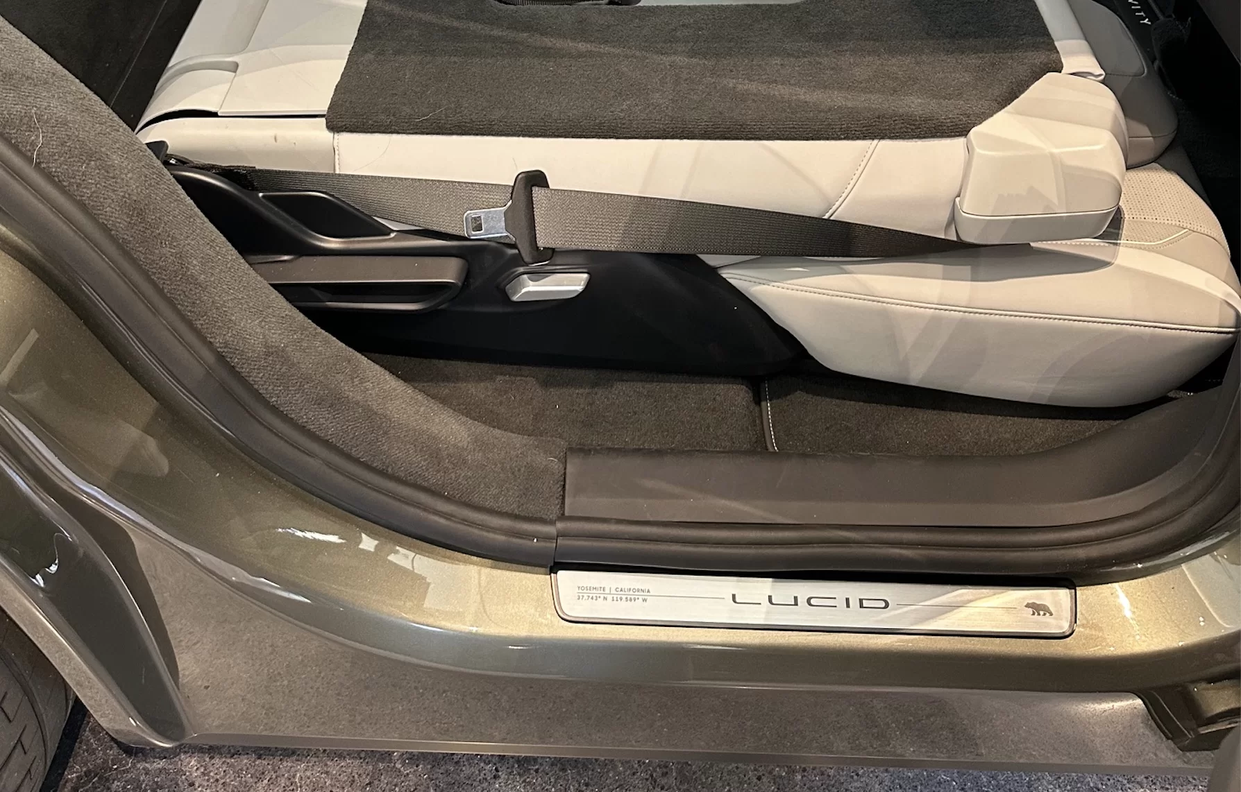

It seems to be a late addition to the car. Here's a photo of the Gravity I saw in the Miami Worldcenter Design Studio a couple of months ago, with no such mechanism present:
I wonder if crash testing showed the need for such a mechanism?

When I drove the PRODUCTION GRAVITY on Saturday, I noticed this interesting piece of engineering and I inquired further. It’s the only one I’m aware of that uses the “hand in glove”, “slot & hook“ design to improve rear passenger survivability!
I know this is a bit wonky for most but is a testament to #CompromiseNothing attitude!
Good eye @Amster for seeing the same thing! I see somebody else above mentioned Subaru, but was wondering if that is a production model picture?
Turns out there are a number of cars that have had this feature. 2018 Porsche 911, 2010 Subaru, and the 2024 Tesla Model 3!
