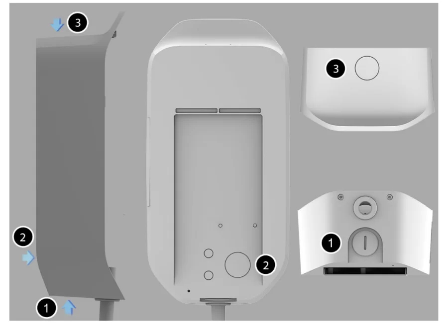

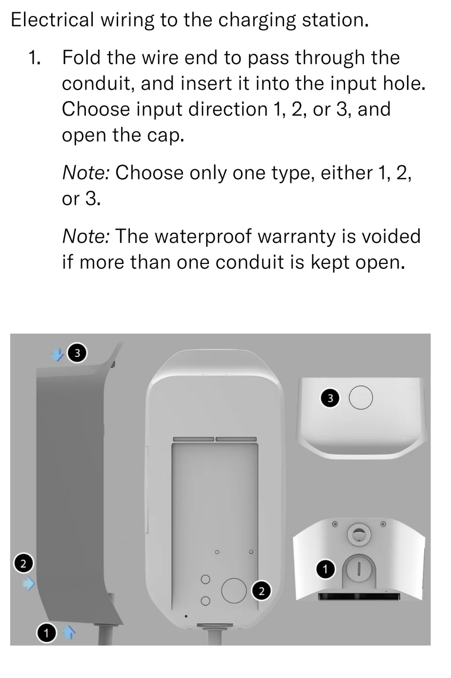

In the LCHS Installation Guide, on p. 15, the electrical wiring information mentions input directions 1, 2, or 3 and opening a cap.

I am considering using input direction 2 (back entry).
However, In this post from 2022, you say "typically you'd bring in the wire through the backside of the LHCS in a case like this, though you'd have to use a hole saw to drill a 1-3/8" hole in its plastic housing, easy to damage the unit".
When you say "backside" do you mean input direction 2?
When I look at the picture in the guide, input 1 seems to have a pre-drilled hole; inputs 2 and 3 do not.
However, the guide directions say to "Choose the input direction 1, 2, or 3 and, open the cap".
If the input is a cap to be opened, why is drilling necessary?
I'm hoping to avoid damaging the charger, as you mentioned.

Yes, the backside would be location 2.
There is a threaded hole and cap present only at location 1. The instruction text is incorrect. Most EVSEs are primarily designed for conduit entry from this direction, the bottom center, like @coma24 's photo. To ease future EVSE swaps, that's a good cable entry direction to use. Top entry (3) is pretty rare. Back entry (2) is less rare.
You'd need to drill into the plastic housing with a hole saw to use cable entry locations 2 or 3. The housing has a circular recess marking the drilling location. It looks like you could knock out the circular plastic with a hammer, but you can't without subjecting the unit to a huge shock. It's not difficult to drill with a hole saw, and electricians should be used to it. Many modern electrical mains-connected things are designed to be drilled this way to improve water resistance - no extra holes if they aren't needed.

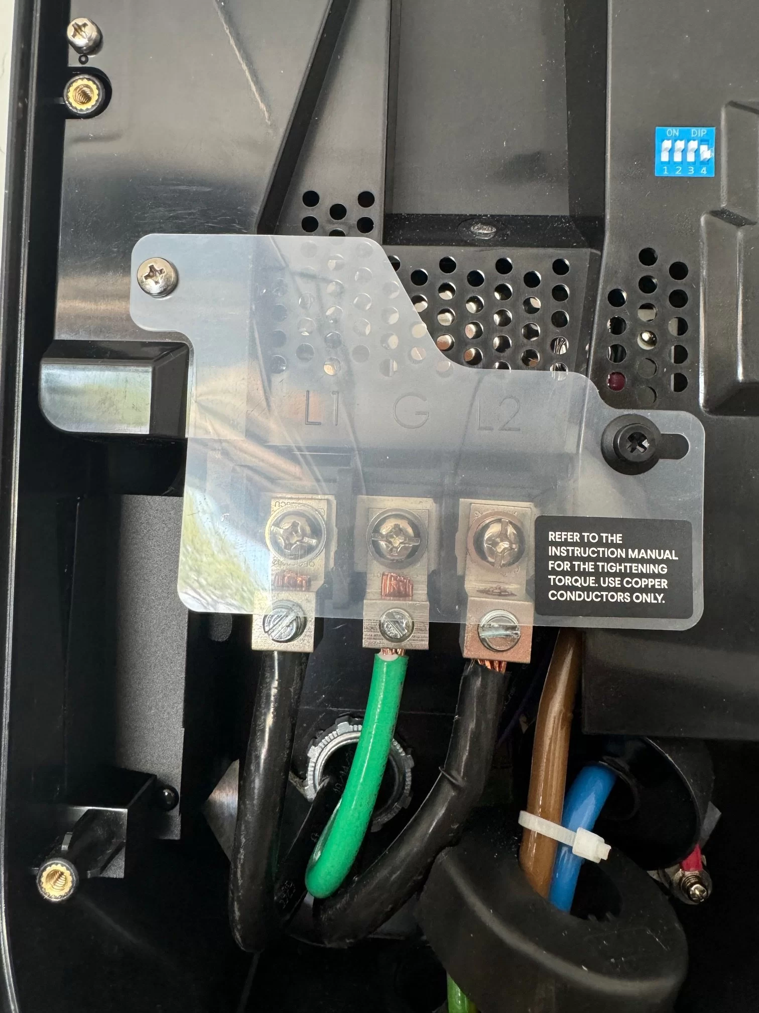

Recently, my Lucid home charging system started to have a problem: the cable and handle were extremely hot during charging. I expected them to get warm, but not over 160°. I contacted Lucid and discussed it with them. They had me open it up and take a picture of the inside. As soon as they noticed the chair lugs, they said that the installation is incorrect, and the compression lugs are required as per the installation instructions. This is despite the fact that the voltage was proper at the lugs and they themselves were nice and cool. My electrician (25 years in the trade) told me that this is ridiculous, this installation is to code, and he feels that the contractors are the problem with the system. By the way, he almost exclusively installs car chargers, although this was his first Lucid. So… Where to go from here?
After several calls to Lucid, I finally got them to agree to replace the charger. My electrician came out and installed the proper compression lugs using his hydraulic tool. He had to special order them so they would fit… The larger 2 gauge lugs have a very large hole in them so the screw the Lucid charger provides fell right through the hole, and my electrician told me that it is inappropriate to use a simple washer at a 100 amp connection. He was able to find the correct ones and now it has been reinstalled. I sent the old charger back to Lucid and I hope that they are able to find what the real problem is.
TL;DR if you install the Lucid charging system with chair lugs and a problem arises, you may have trouble getting warranty service from them. I got lucky… But only after I pushed a little harder than I should have needed.

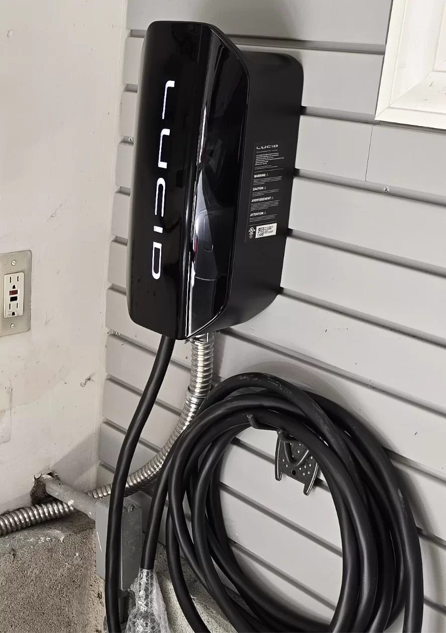

Old and new pics below:
View attachment 22641View attachment 22642

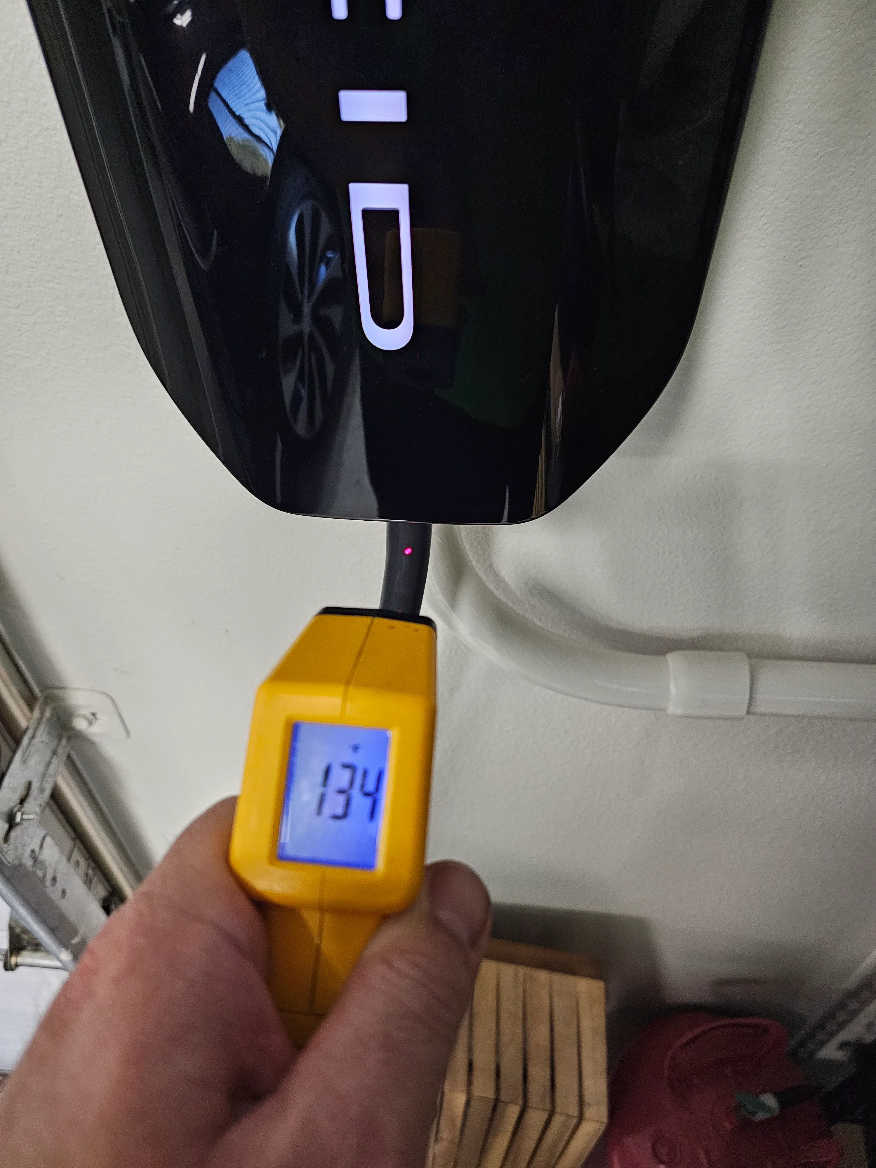

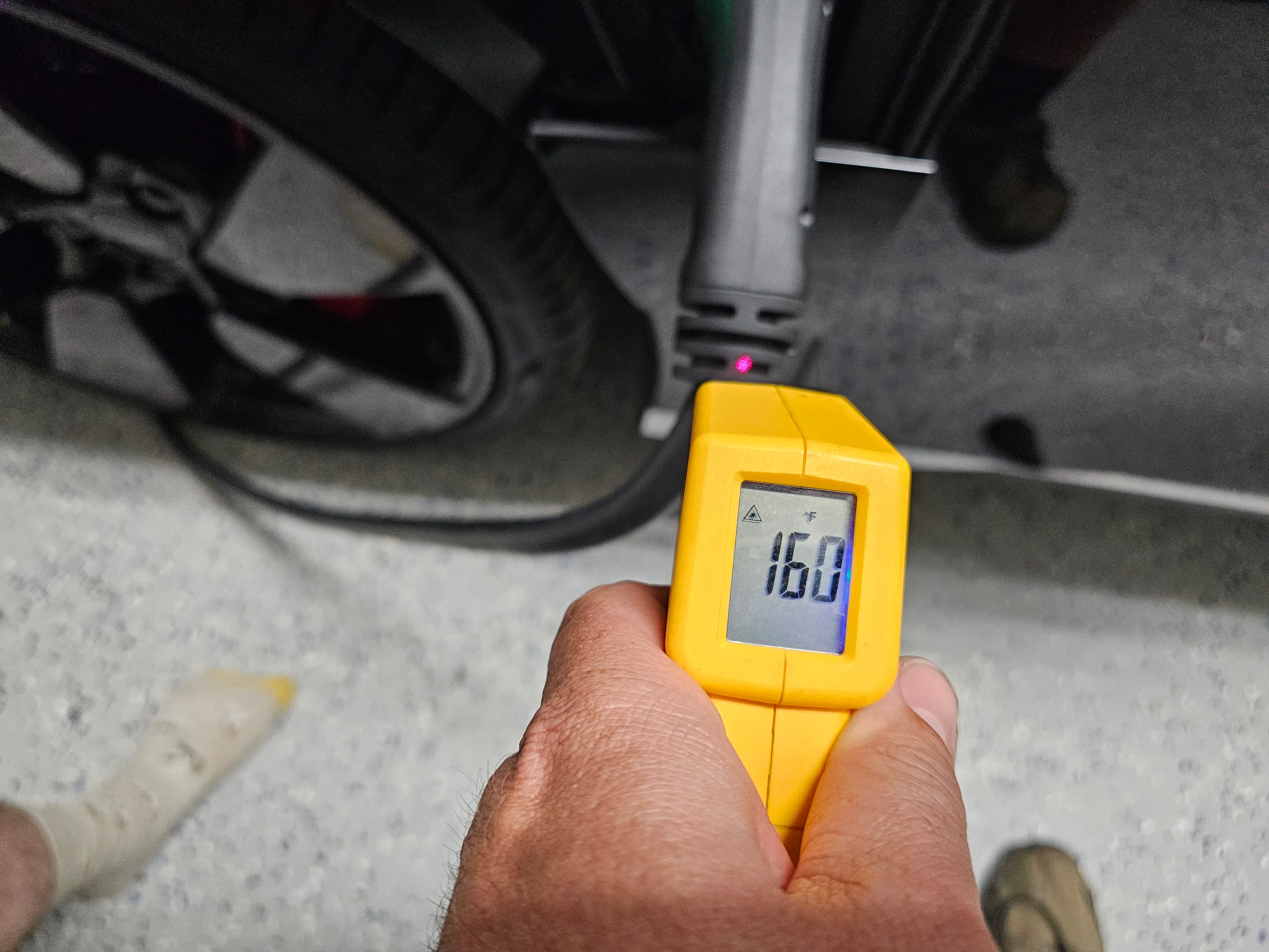

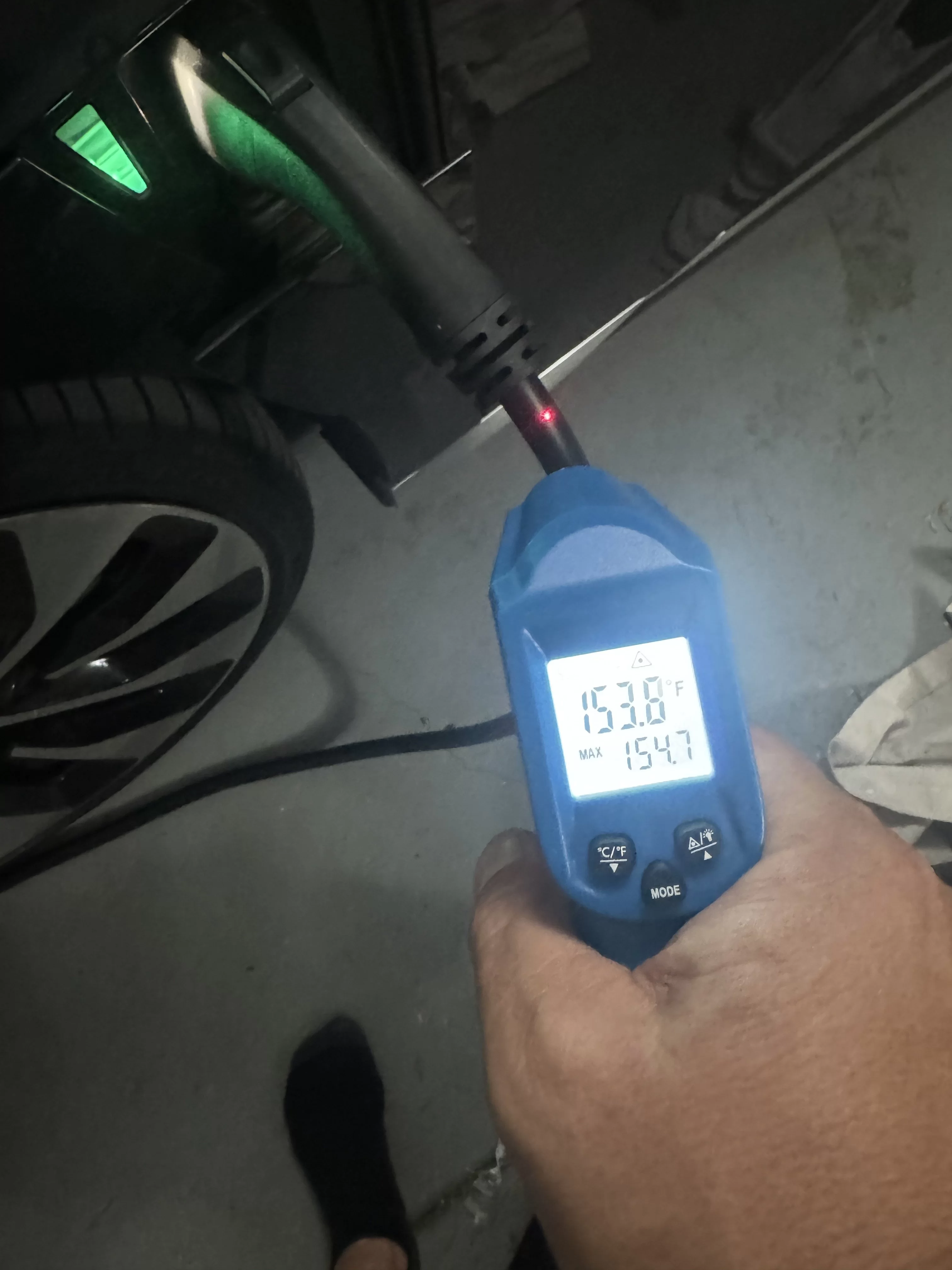

Hey Bobby after searching the forum i came across your post I am experiencing the same issue your having today while charging my car. I have the Lucid home charger on a 100 amp circuit juiced to 80 amps.
The cables comming in from the 100 amp breaker are a tad warm but the actual charging cable where it plugs into the car is very alarmingly hot. See the pictures.
Yes it is summer time and the garage is a bit warm but this cable is crazy hot.
I did take my home charger apart and dropped it down to 70 amps. And it helped some but this is spooky having this car charge in my garage unattended.

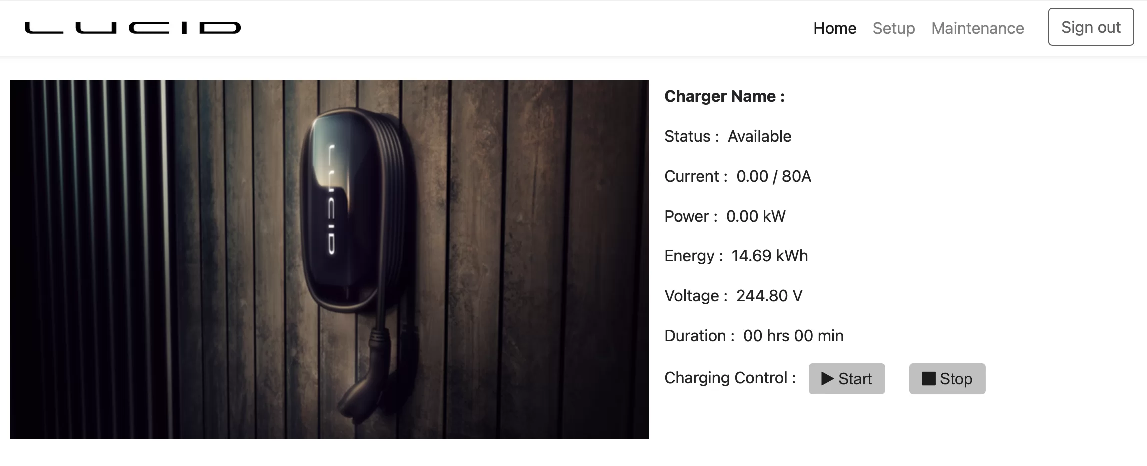

In my LCHCS, control panel i see these new start and stop buttons in the home screen. Also i see a new tab for Device info for the setup screen. Do you know what these are for? Also is there any separate thread for discussing LCHCS version and functionality details?View attachment 7718
I don’t have start stop or any of these options .. how do I get it?

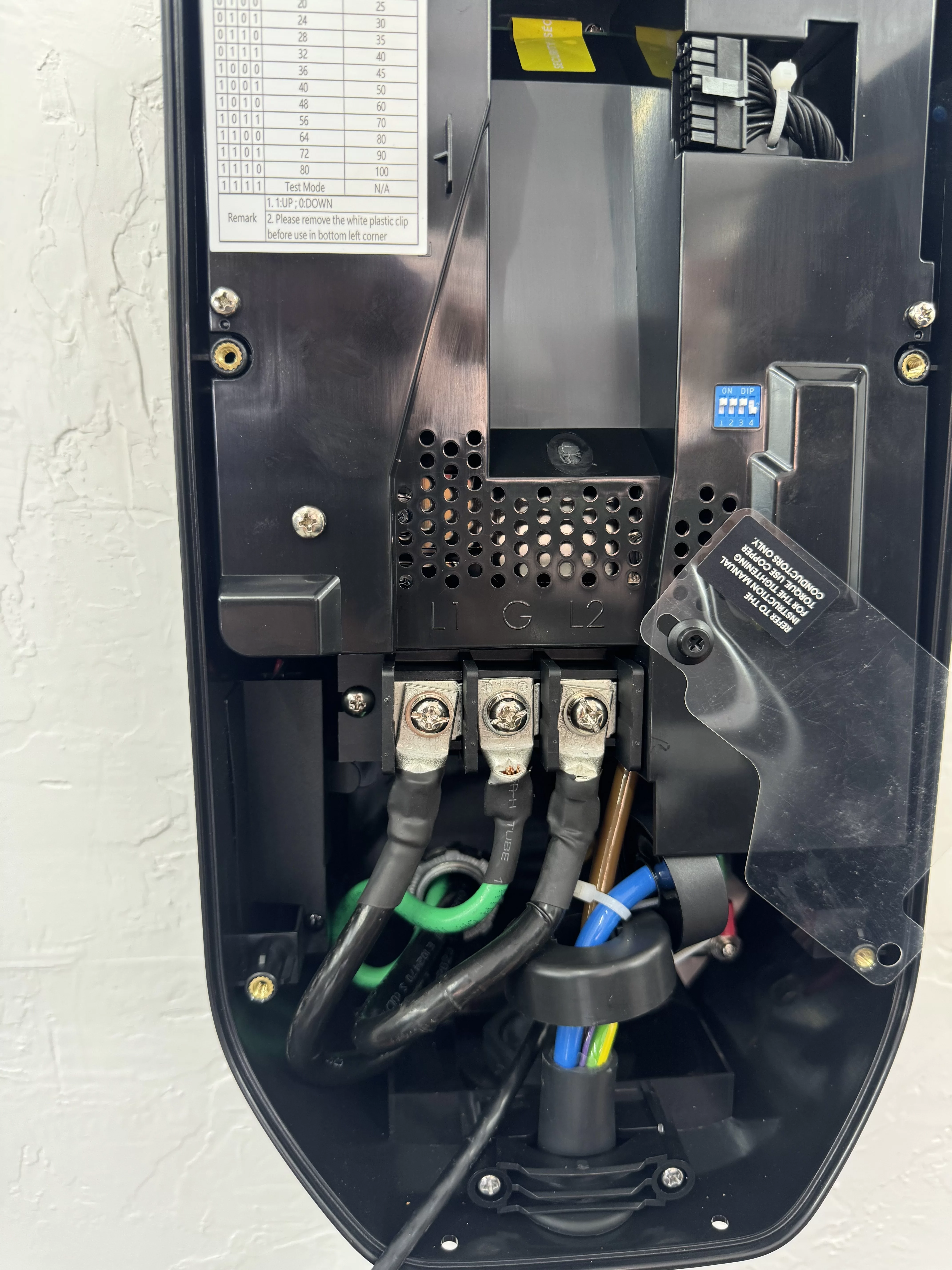

LCHCS arrived yesterday.
Fortunately the outer cover came off pretty easily.
Maybe they changed the design somewhere.
I have an Ethernet connection nearby, but the grommets have deterred me. I saw the posts about splitting the grommets and using a solid cable and krimping. Nah. Going wireless.
