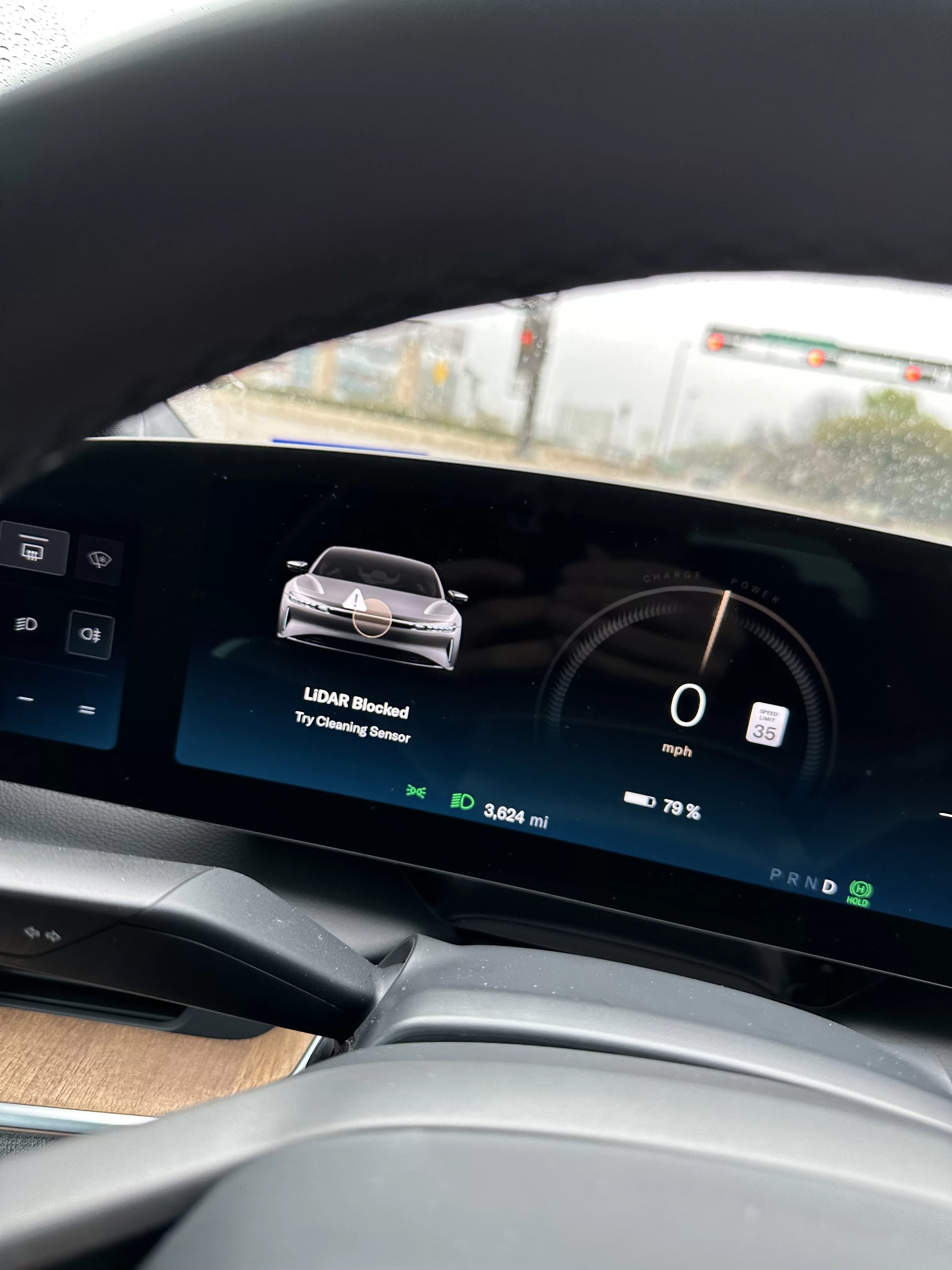

Happens to mine quite often … the lucid people said the water on the sensors sets it off… interestingly the auto windshield wipers on the other end require a deluge before they come on … or won’t at all … car is going back in next Friday to take a closer look

Another day of light rain in Dallas and another message. I never saw this before .55....

i just picked up my Lucid yesterday after a little over 3 weeks at the service center. We had multiple things to have fixed - but the lidar issue was one that they could not come up with an answer for. Advisor said that the sensor in the front probably gets wet and then it won't work. This seemed pretty obivous to me that yes, every time I have reported this it is raining. I could only come up with, "well, one should be able to drive a fully functioning car in the rain - it does rain occasionally - EVERYWHERE". He agreed. I asked what features are not able to be used when it is raining and the lidar is not functioning. He said the warning of when a car pulls away in front of me wouldn't work, probably not the cross traffic alert, and he seemed to think that the dream drive and maybe the lane assist would not work. But I wasn't confident with his guesses. I was concerned about the safety features - like avoiding rear ending another car. Still looking for a solid answer on which features will not work if lidar is not working. I just don't want to be depending on something that isn't available.
The features you describe are all available on other cars without Lidar using the cameras and sensors. I would have hoped that the Lidar would be additive and these functions could still operate albeit at a lesser level.

This is exactly my issue … my wife has had now several issues and is not comfortable driving the vehicle… Lucids response hasn’t been that great … it’s basically they same (water gets in there and sensors act up) … along with turn off the features when it rains … really?

I’ve gotten the alert a few times and only when it’s misting…superfine droplets. When it’s actually raining, I never get the alert.

Same here, works well when there is a downpour but when there is a mist the message shows up every time
I received my Touring 1 week ago and I saw the same error message this morning during light rain at the Bay area. It disappeared once the rain stopped. My car is at the latest software version.
I get the LiDAR blocked message as well. Has anyone tried a ceramic coating or PPF on the sensor?
I have ceramic coating and still get that message, though not as frequent after the update.

I would recommend against putting PPF over the sensors (radar/lidar). It could mess them up in terms of their ability to function correctly.
I’ve gotten the error a lot in light rain but not in heavy rain. While I agree it is annoying, you can still (and should) use regen and brakes to slow the vehicle down every time. All ADAS features are designed to augment an already engaged and attentive driver, not to make it so you don’t have to pay attention to driving and hope the car will just stop for you on its own in the rain. Obviously this a glitch that needs an OTA to fix, but it doesn’t mean you can’t drive the car or other such hyperbole.
