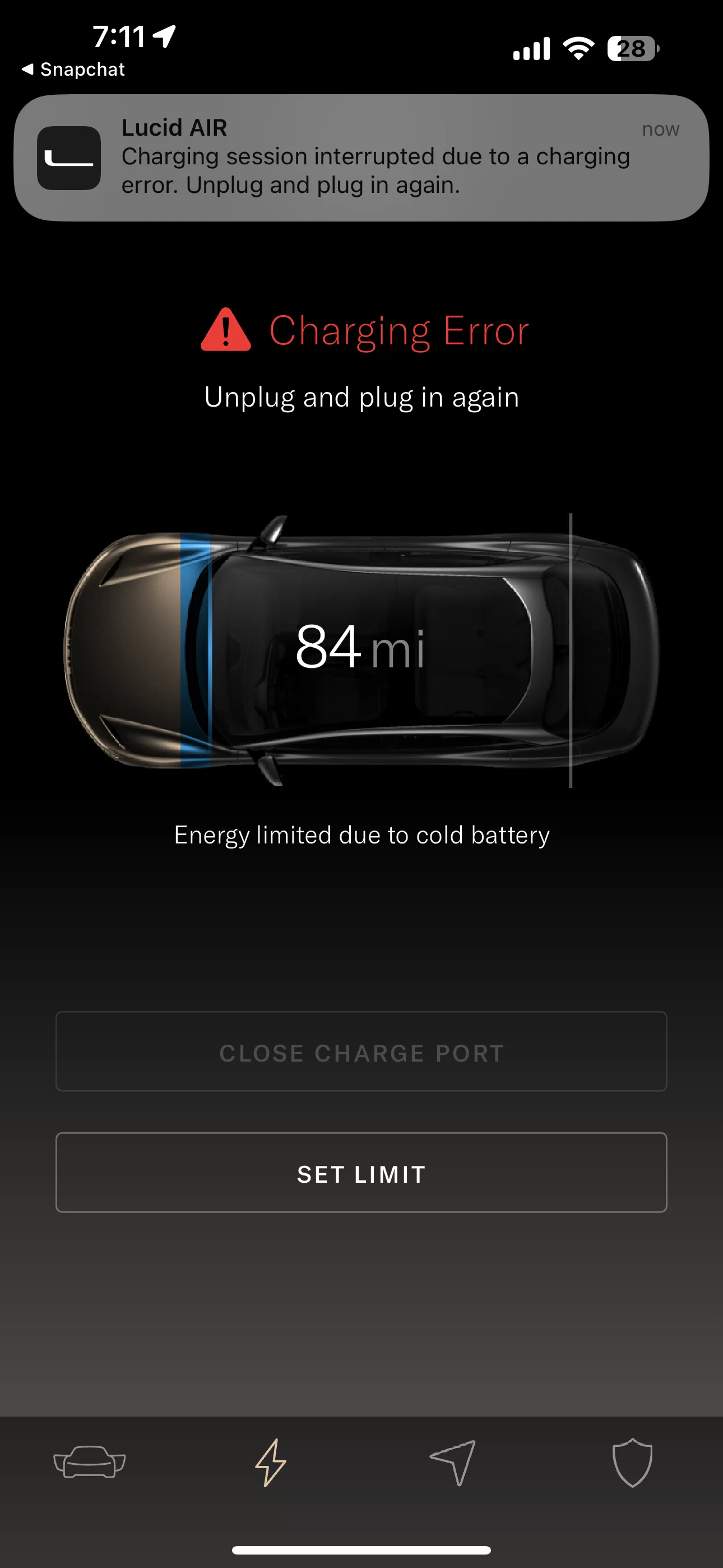

Im actually having this issue as well.
Did a Lucid update to 2.1.42 very recently. Tried to charge it and now i'm getting the error.
For mine, I have the LUCID Home Charger level 2 and that is giving me consistently and error to disconnect and reconnect the cable.
Im also having the same issue with the standard 110 wall mobile charger giving me the same error.

I am experiencing similar charging issues but in opposite order. My car is able to charge on Level 2 charger but not in fast DC chargers. I tried multiple EA chargers and an Evgo fast charger. It gives "charging equipment error" on all dc chargers. A mobile tech is scheduled to visit later this week to diagnose the issue. Hoping it's not something serious that will take the car away.

I am having the exact same issue. No luck on my home charging using the Lucid cable or any Level 2 charger. No DCFC anywhere close to where I am so currently stuck at home. Working with Lucid Houston, car will need to be taken in. Not sure what the exact issue is yet though :(
It's so bizarre, car has worked flawlessly when charging for months. Earlier in the week it got pretty cold for down here (low 30s) and that's when I started having this issue.
