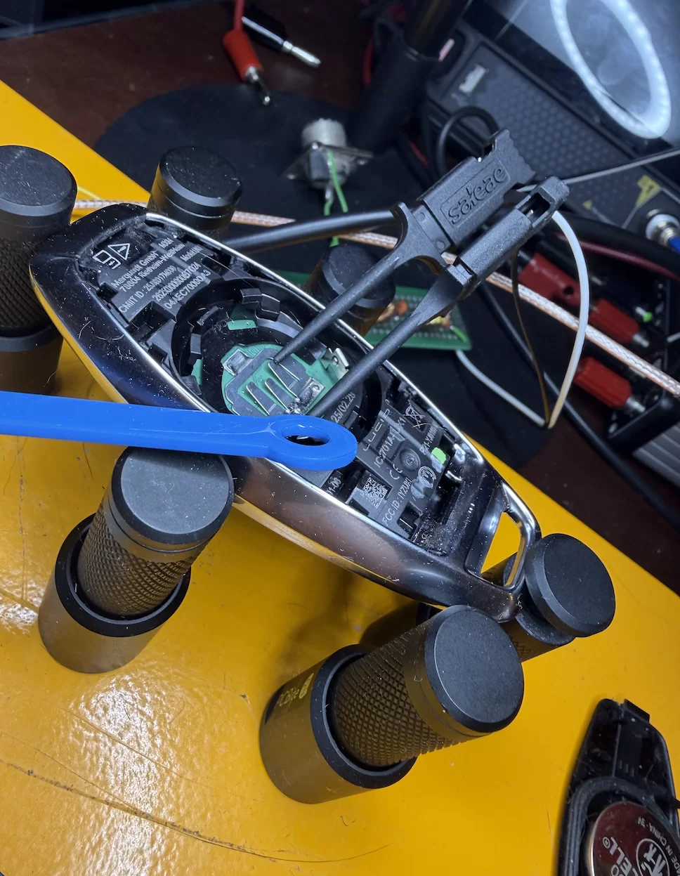

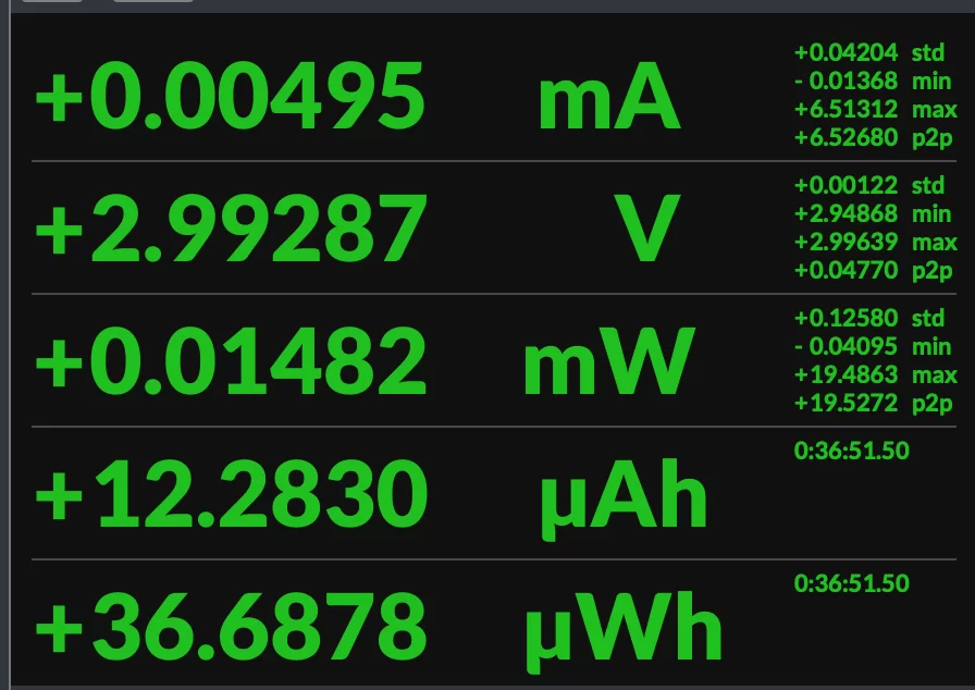

Maybve I'm taking this too far:

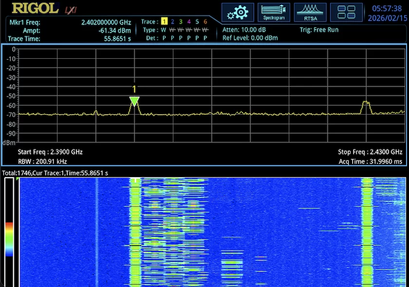

So, I did some basic power analysis on the keyfob. When it's "awake," and the car is about 40ft away, it seems to ping once a second. When it does that, it draws up to 48mA.

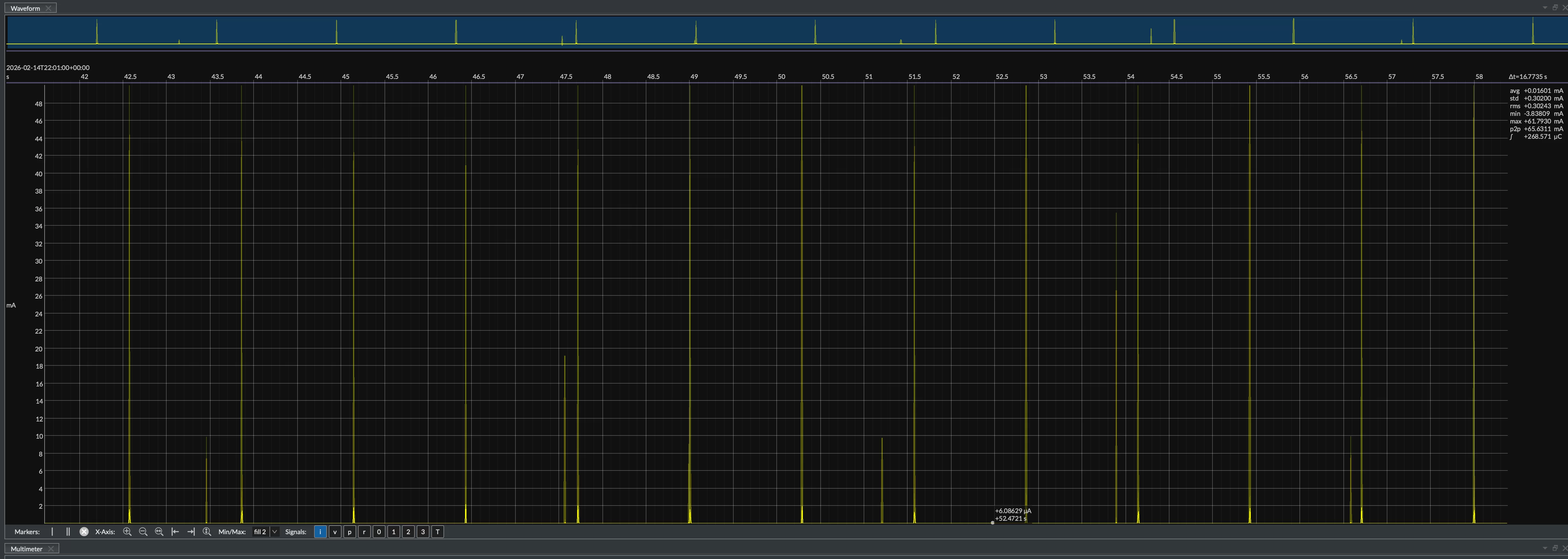

After about one minute, it seems to go to sleep. At which point I see spikes of current draw of about 9mA on average every one to two seconds.
On the spectrum analyzer, you can clearly see a beacon every second when the key is awake, right at 2.4Ghz. So, that is probably some sort of Bluetooth beaconing. I looked up the FCC ID for the fob, and it appears to support ultra-wideband communications at 6.5 GHz, 7.5 GHz, and 8.5 GHz. I should have some time next week to try to analyze that and see if there is any TX on those bands when it's sleeping. The next step is to do the same analysis on my Subaru fob, which seems to last forever.
I also noticed it does not take much to "wake" the key. Simply tapping on my desk was enough to wake it.

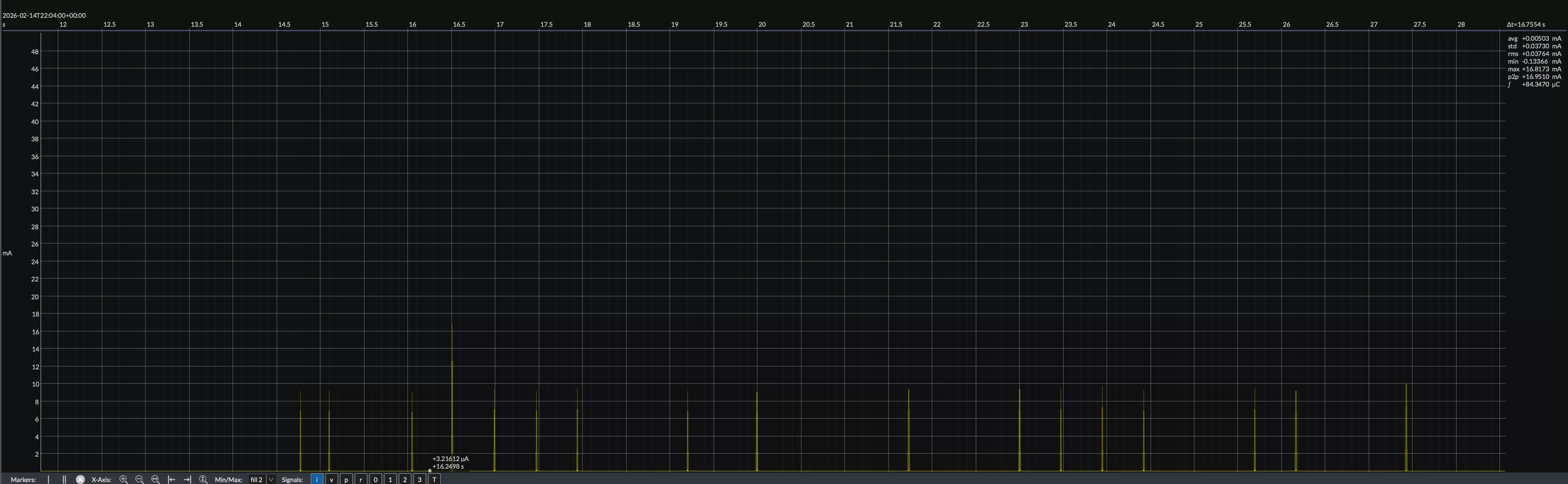

I let the fob sit for an hour and tracked its power consumption. Based on that, it should last years. (~70 µWh per hours sleeping) So, at some point, when I'm not looking, something is draining the battery.
I've also watched when the car wasn't home, and it doesn't seem to matter. The pattern is the same. This is with the latest firmware on the fob and car.

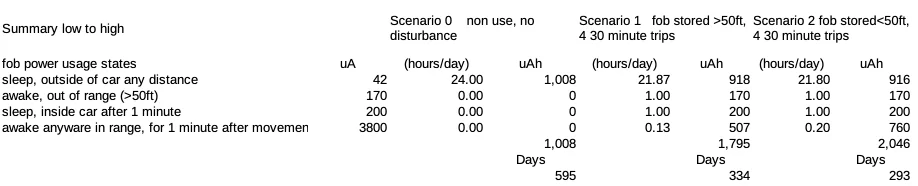

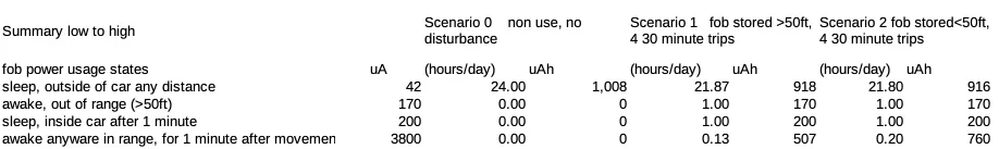

This is a summary of fob battery current data using car ver 3.4.1 and fob 2.35.08. Basically there appear to be four distinct power consumption states as listed in column 1. Drain values are the highest of two different measuring techniques.
FOB Power Usage StatesDrain(uA)Battery Life assuming 600mAh battery (Hours)
sleep, outside of car any distance, no fob movement for > ~60 seconds.4214286
awake, out of range (>50ft), nearly any fob movement1703529
sleep, inside car after 1 minute of D or R 1st selected even if further movement2003000
awake anywhere in range, for 1 minute after movement3800158
To get an idea what that means column 3 shows how long the battery would last in hours if continuously on in that state. So if the fob was asleep you could calculate from the battery capacity and drain the life would be:
600mAh/42uA * 1000uA/1mA = 14285 hours or *1day/24hours = 595 days

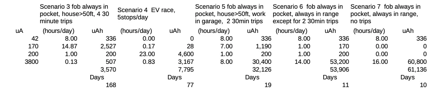

More interesting would be to look at some typical usages:
Note the EV race scenario would have been about 7 days with the last revision.
I love your approach to the analysis. I think we were inadvertently in scenario 6. My wife would leave the fob in her purse, which hangs on the back of her office chair. She’s moving and rolling around on the chair throughout the day, which constantly wakes the key up. The car is close enough to be in range, too. She then probably averages 2-3 short trips per day. The predicted life span is also consistent with our experience.
