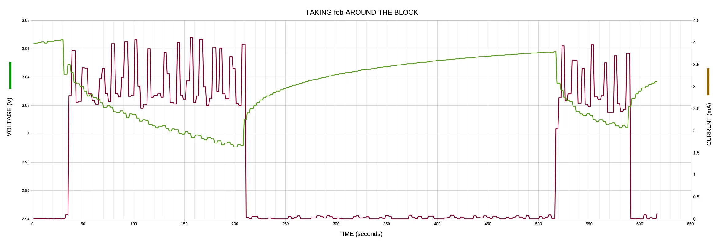

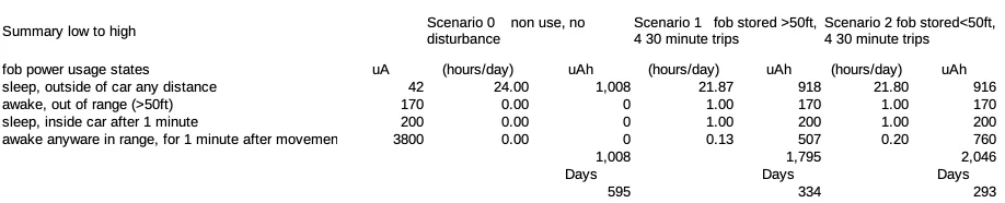

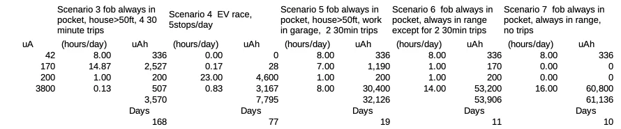

Well pooh. Now you reminded me of something I forgot to check and even forgot to mention that I had auto lock enabled. I'll use the same methods as above so it should be comparable. I won't even venture a guess at this point.I'm curious how turning off the auto lock/unlock setting in the car would change the battery longevity. I'm still using the battery I put in the fob on 12/19 (a Retail Digitals brand 610mAh from Amazon) to replace the one it had when I took delivery that day knowing the stock ones died fast. I do keep it in a known good faraday box too.
I don't use the auto unlock right now and just use the fob as a fob to manually lock/unlock the Gravity, I haven't pulled it out lately to test it on the multimeter though and should do that.
Curious if you tried to see what scenario you might be in. Do I need to explain a little bit more about how that is calculated?
