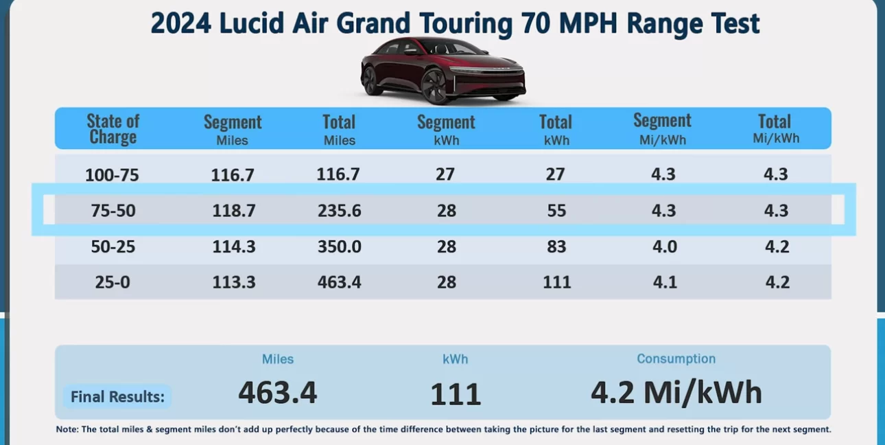

It’s definitely possible to get into the 4’s at highway speeds. State of Charge just did a 70mph range test on the 2024 Air GT

One thing of very important note when people are wondering about their range. He made comments about a 7mph headwind..a slight increase from the 5mph he was experiencing earlier plus the 10 degree temp change caused him to go from 4.3 mi/kwh down to 4.0 mi/kwh a decrease of 7%!
