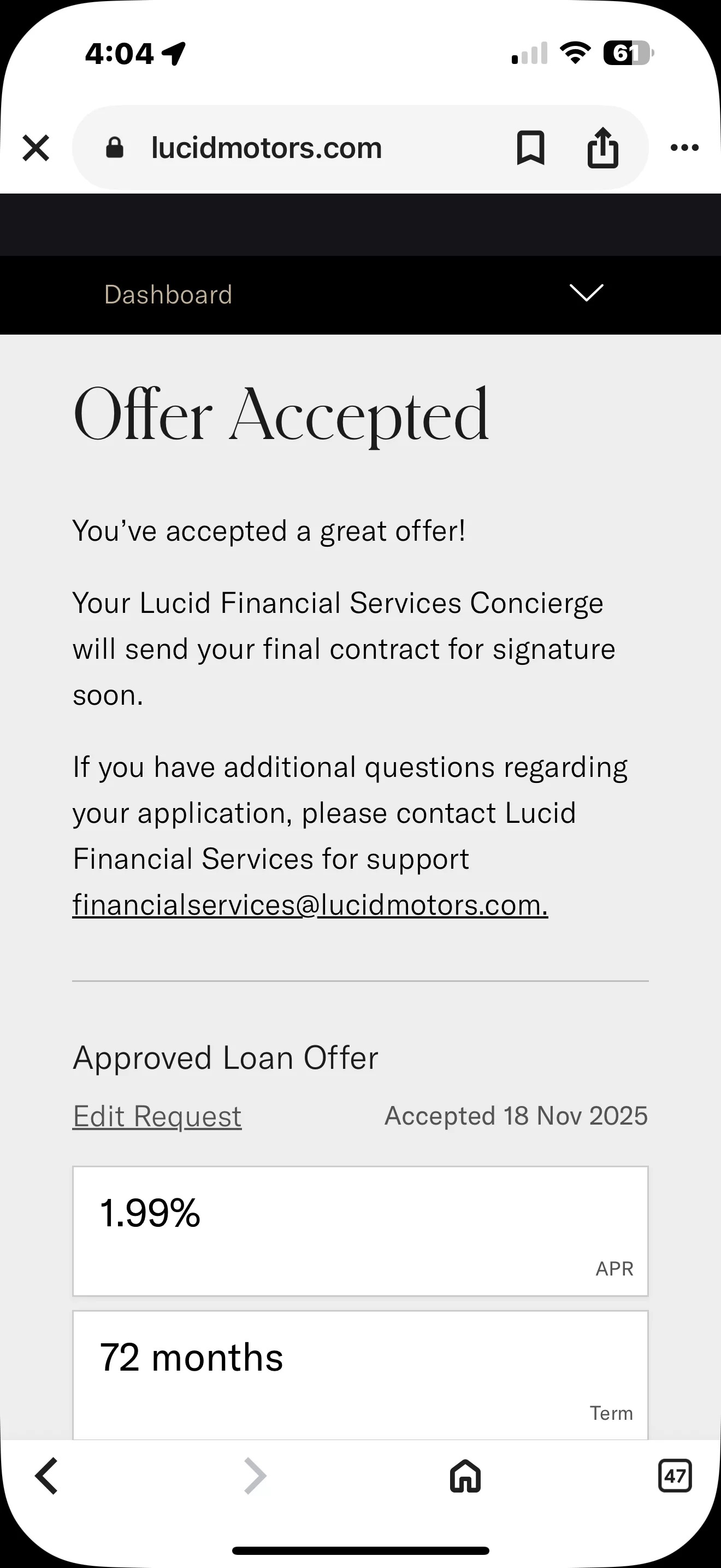

Where did you find a 1.99% 72month loan?
@Jbapckfan current offer for those who can take delivery in November. Apply for financing via Lucid’s apply for financing link , you can save and exit before reaching submit

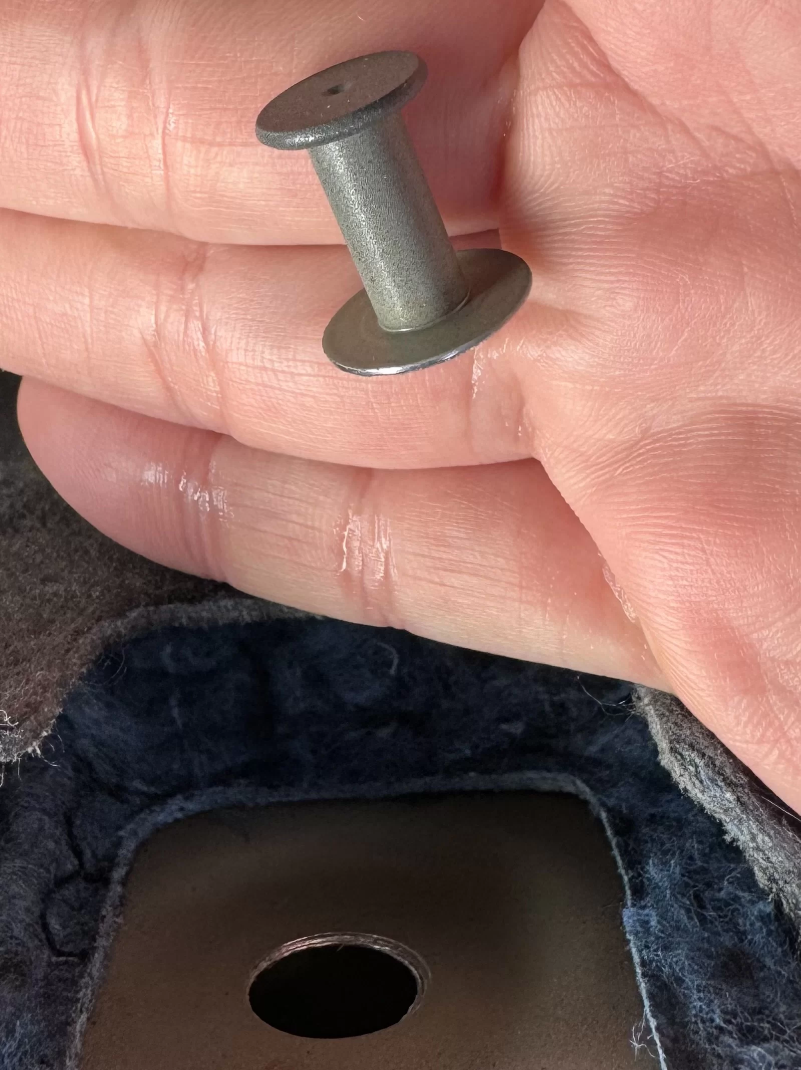

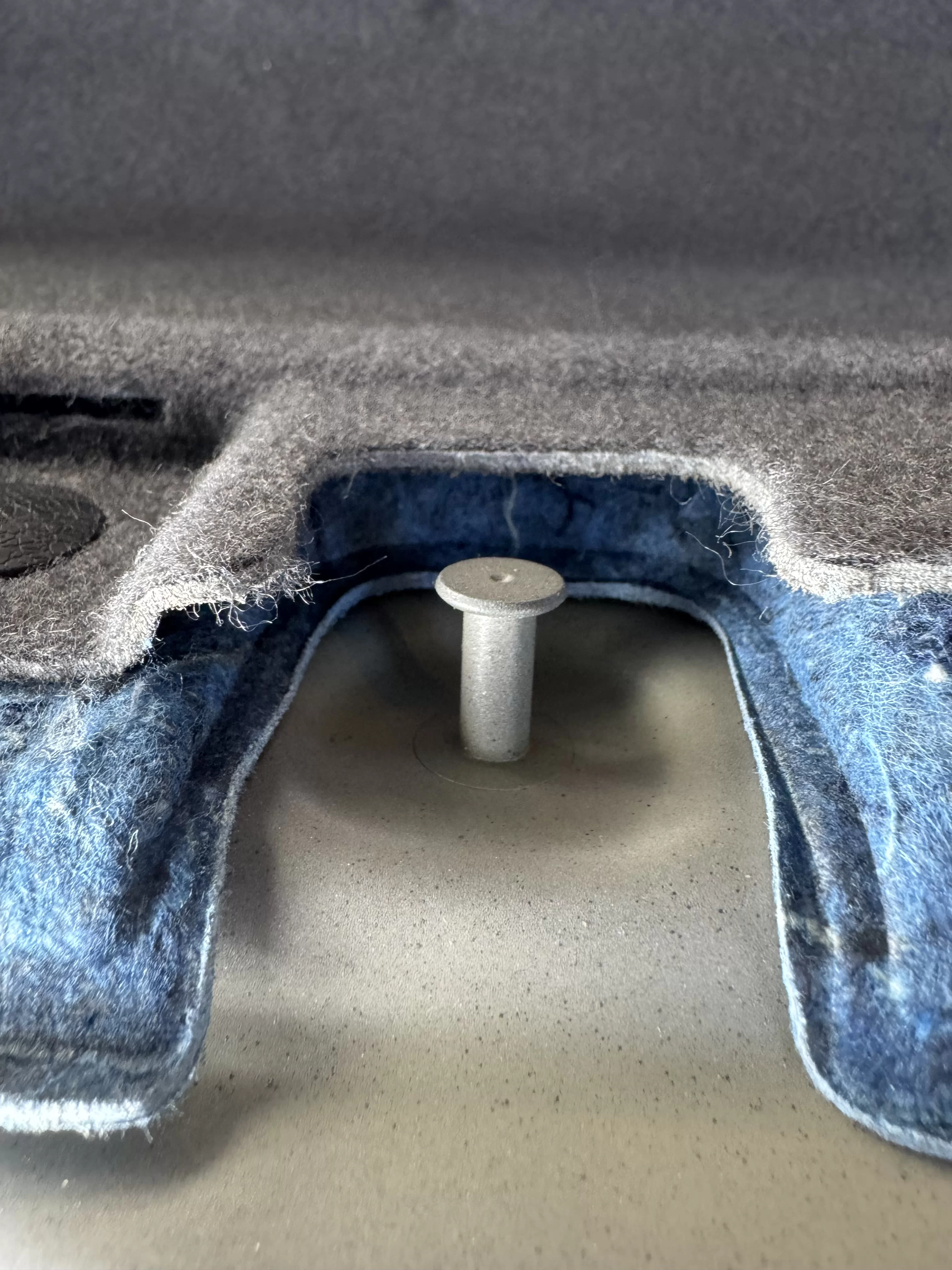

  • One of the four cargo tie down hooks was not screwed in, resulting in a loose plastic trim piece (bolt cover)
    • I took it apart, used a T30 torx bit and ratcheted it in place. I had to push the carpeted cargo wall pretty hard to get the hole to line up with the machined threading behind it. The plastic piece that covers the bolt fit much better after tightening it properly.
