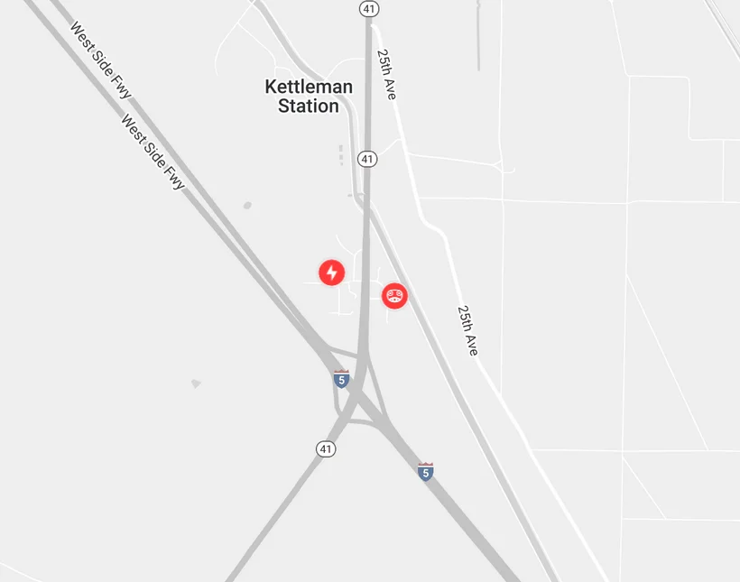

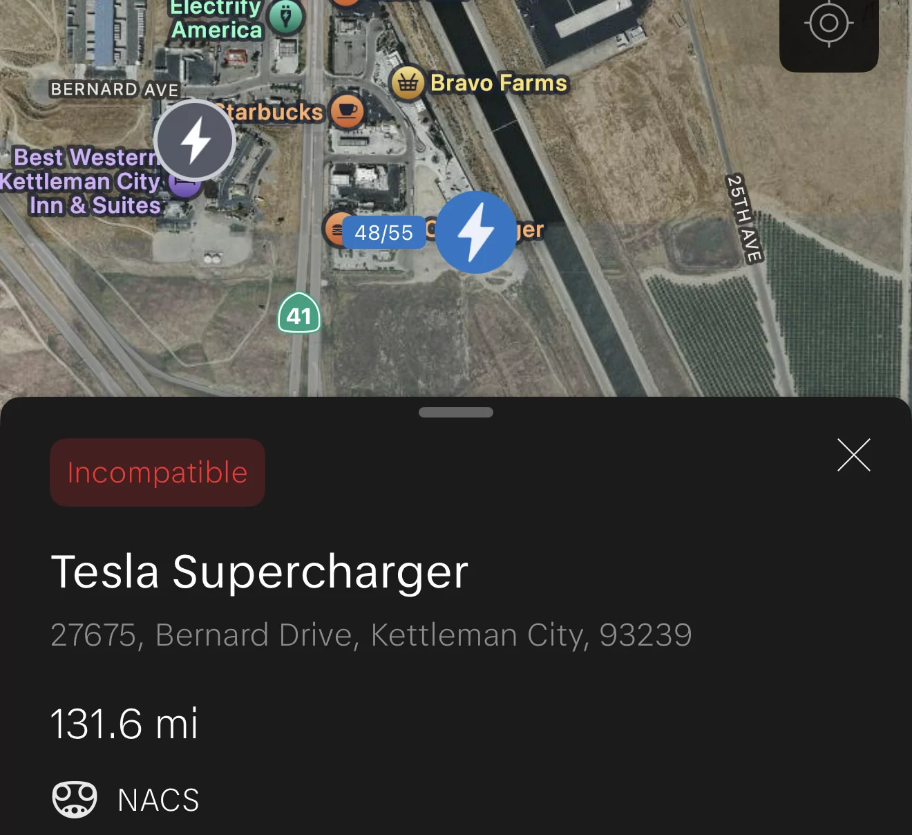

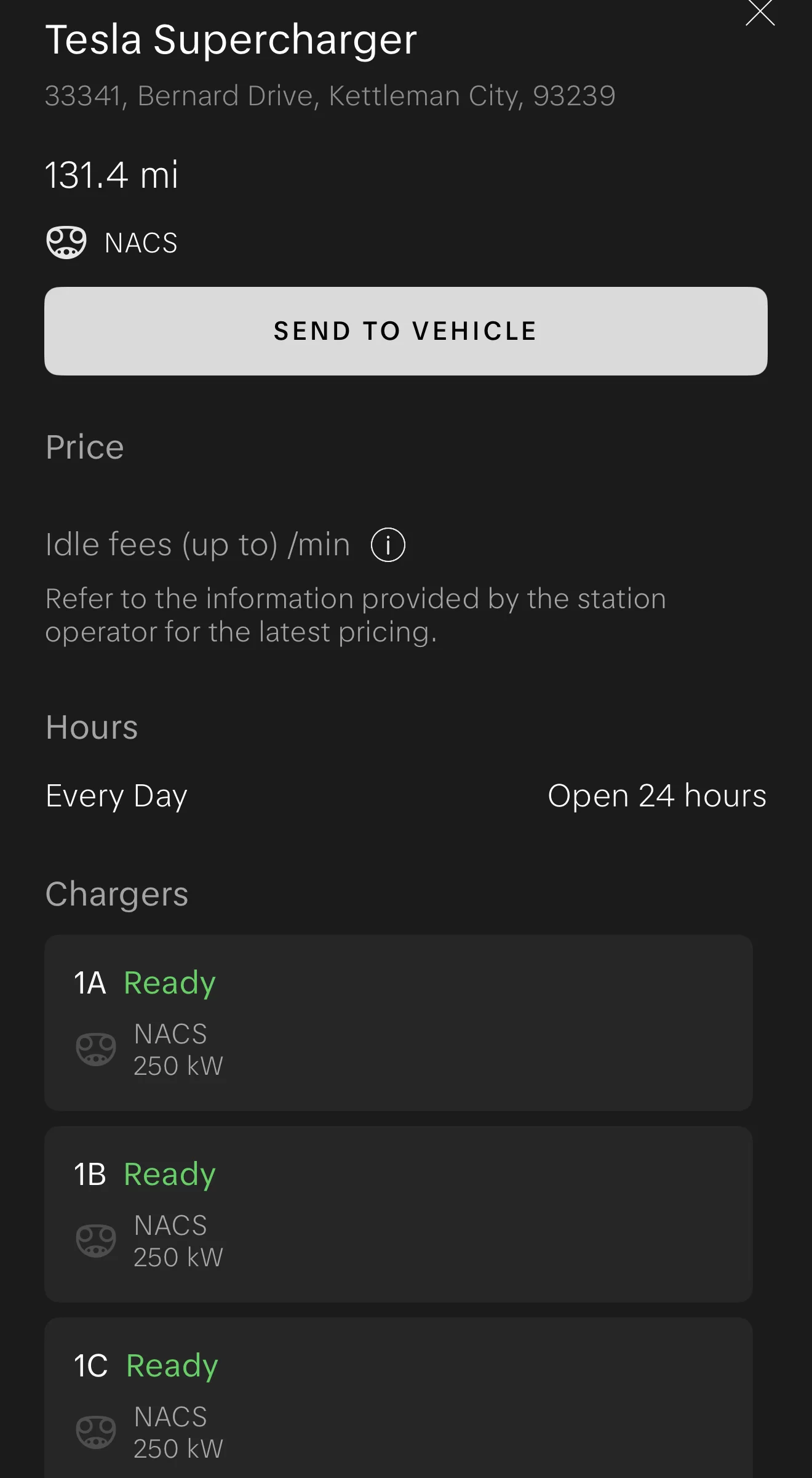

Yeah that older 27675 station is an odd one. It's got a mix of V2 and V3 (presumably it expanded over the years). Then they added the new station across the street. My guess is they didn't flip the switch for CCS on the V3s at the mixed station just to avoid confusion (since it hard to recognize the difference between V2 and V3), and left that entire station as Tesla-only.
The V2's do have thicker cables (and a silver ring at the bottom of the handle) than the V3's, but that's not a very noticeable difference to the average user.
Yeah, I think you’re spot on with the assessment. There’s a Target location in SF with a mix of V2’s and V3’s and the site is off limits to non-Tesla’s. As the chargers look very similar it would be too confusing for people to figure out what’s what
The Lucid App clearly shows which ones to stay away from also

The other way to tell difference between V2 and V3 is the labeling on the posts. V1 and V2 have pairs of posts sharing a charging cabinet and sharing power. These are labeled with a number and A or B, (e.g. 2A, 2B, 3A, 3B).
V3 are in groups of 4, A,B,C,D per cabinet, but don't share power.
As others have said: V2 limited to 150kW (shared between A & B sides).
V3 250kW not shared.
There's also 72kW "urban Superchargers" they are smaller posts that effectively is 1/2 of a V2 cabinet and Plugshare shows them as Tesla Only as well.

Moral to the story, check your Lucid App or in car navigation to know which ones can be used. There’s one site for me in town for me that has 250kW chargers but both the Lucid App and in car navigation tell me it can’t be used.
