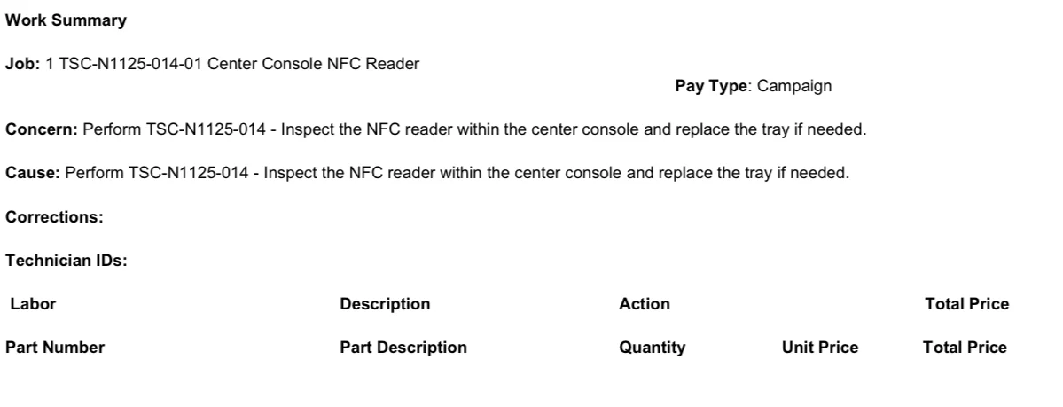

PSA for folks with wireless charging issues:
The new iOS 26 has a known wireless charging issue for certain iPhones. When my phone wouldn’t charge wirelessly in the car, I noticed it stopped working on my nightstand charger and my wife’s stopped about the same time.
Easy fix - have to reset your iPhone. Wireless charging now works fine for me in car and at home.
So, my center console IS behaving but for the ever consistent blocking of GPS and cell signal if my phone is near it…not a huge issue for now.
My Iphone charges wirelessly at home. but not on the Gravity console.
Any suggestion?
Any suggestion?
Maybe remove the case and ensure its in the correct spot?
Otherwise, service has replaced a lot of other ppl's center consoles....jus' sayin'
Mines in for service now and it seems there’s an active campaign to check the NFC tray
