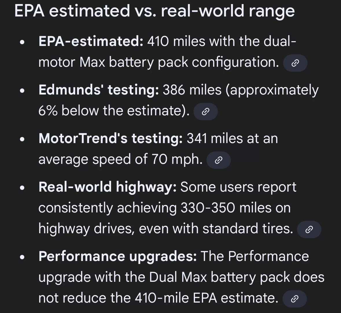

That 341mi result was at 95 percent charge (who tests like that???) They also say the "average speed" was 70mph which is always going to be less efficient than actually going 70mph.
In their most recent test Out of Spec got 376mi to dead. I'm just going by current available test results, on paper the Gravity should have more range at 70mph.

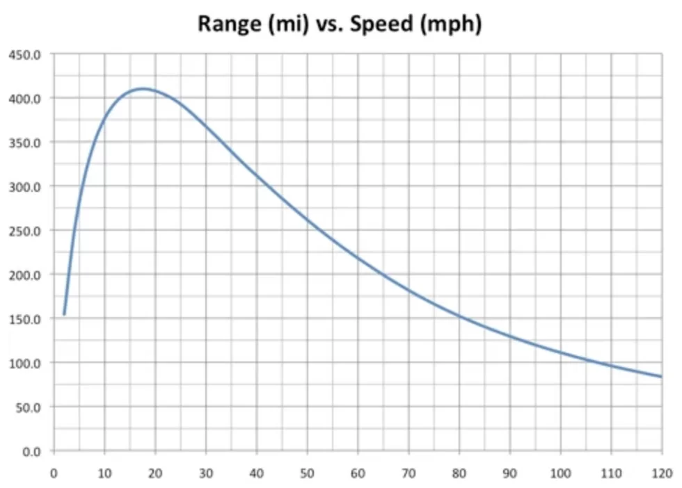

Play with any variables you want, and every range/speed chart ends up looking pretty much like this one:
At higher speeds, aerodynamic drag tops every other factor in terms of reducing range. And it's a range killer any way you cut it on a road trip.
The same thing happens with ICE vehicles. You just don't care as much because there is a gas station at almost every exit.
Could be relabelled as Urine Flow(ml/min) vs Age (yrs) :-)

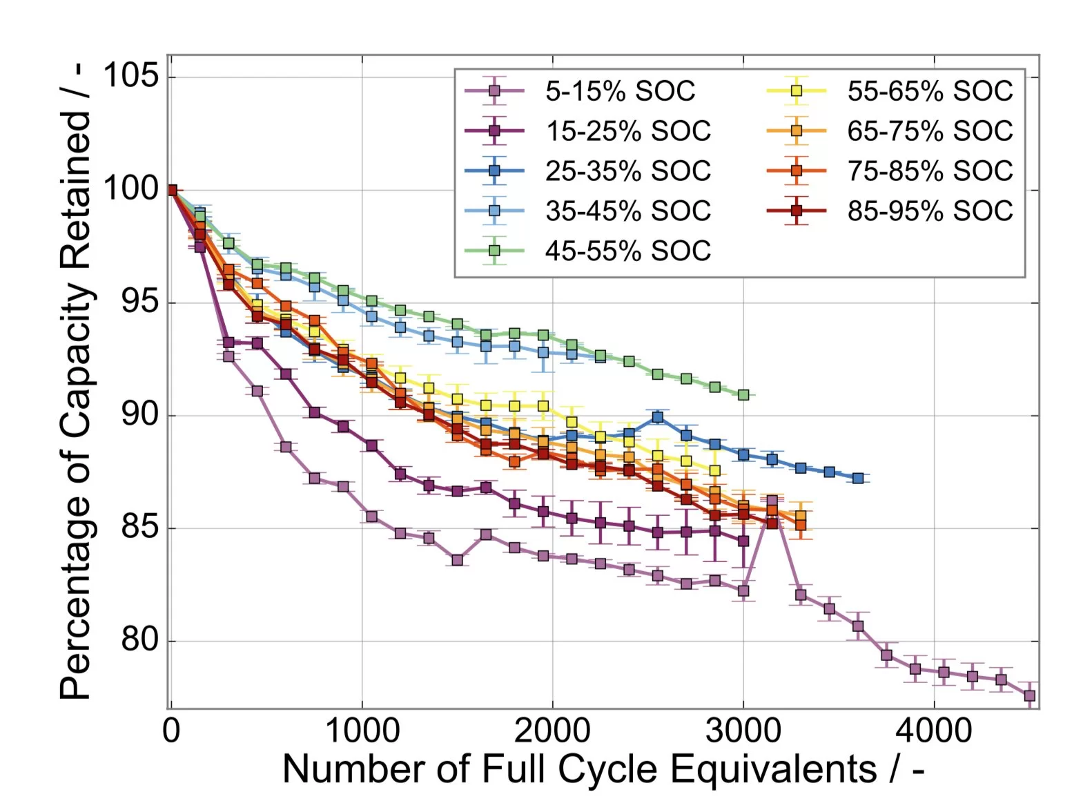

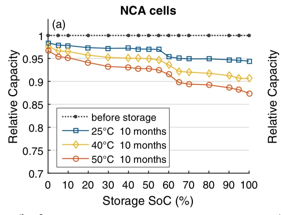

There's a guy on the Tesla forum that's always posting about this and he's convinced me that the thing that really matters is only charging to 55% for normal daily driving (note that Lucid themselves recommend 50% charge for "storage")
From this chart we see that there is big increase increase in calendar aging at 55%:
From this chart we see that 35%-55% is the best place to cycle the battery:
Worrying about how to treat the battery on road trips is unnecessary, do whatever gets you to your destination the quickest.
The Panasonic cells that Tesla uses these days are degrading faster than the old ones, hopefully the Lucid ones are better.

Thank you for sharing this data. It supports my point that running your battery down below 10% isn't the best way to make it last.
Also...Interesting the effect of temperature shown in the first graph

True, but what's the point of conserving capacity if you never use it? If using the 5%-15% is 3 times worse than 45%-55% but you only use it on road trips it's not going to make much difference.
