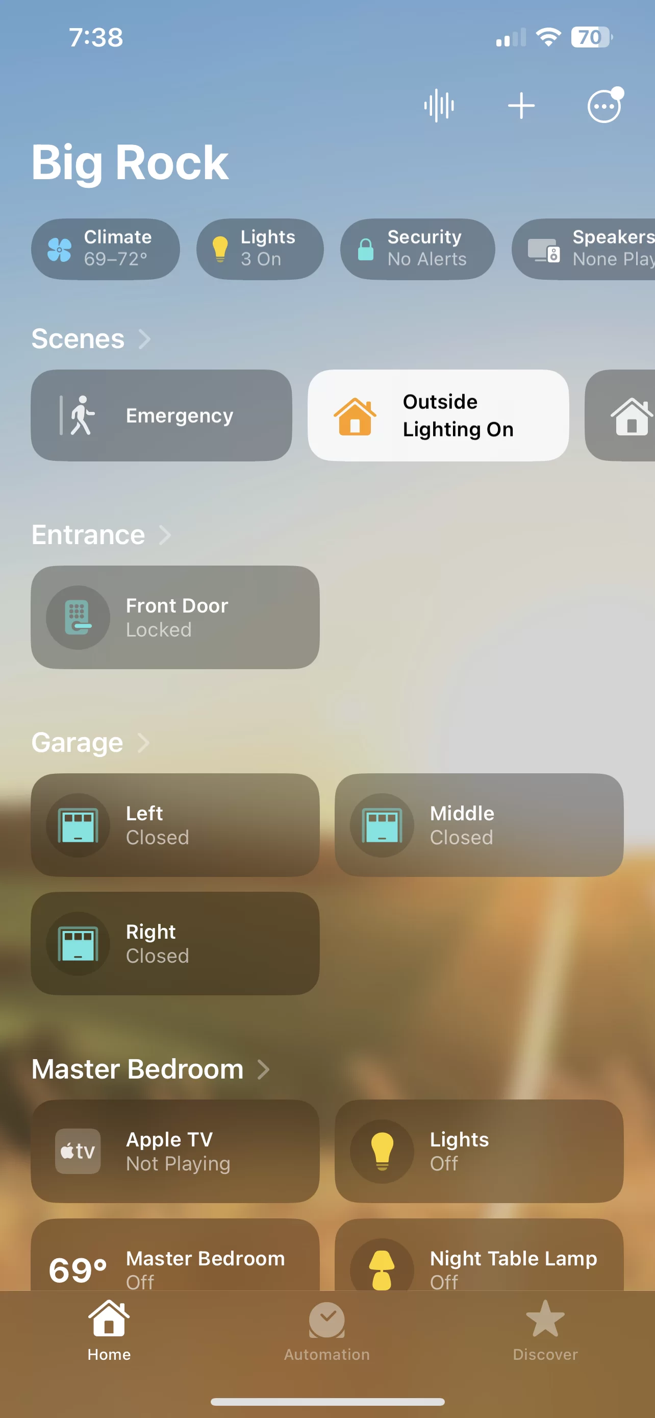

MyQ is compatible with HomeLink (the Home app) on your iPhone. “Hey Siri open the garage” works just fine.
it does, but I wanted it through Alexa so I can use the steering wheel activation button and do it though the car.

Yeah I have the HOOBS box so just downloaded their MyQ homebridge and it worked. But it would be nice to cut out homebridge entirely.
