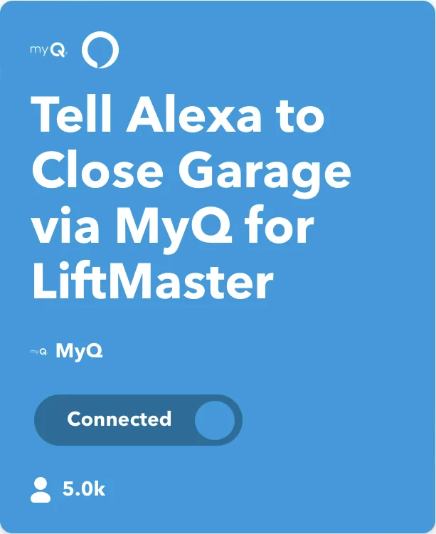

You can connect Alexa and MyQ using IFTTT. The door can only be closed and you have to use the trigger command : Alexa, trigger close garage door

I agree with the suggestion to use LiveKey and MyQ. Now my routine is to pull out of the garage, point my car away from the garage, and ask Alexa to close the garage door. Works much better than pressing the button while the car is pointing at the door. The Lidar interference issue solved.
