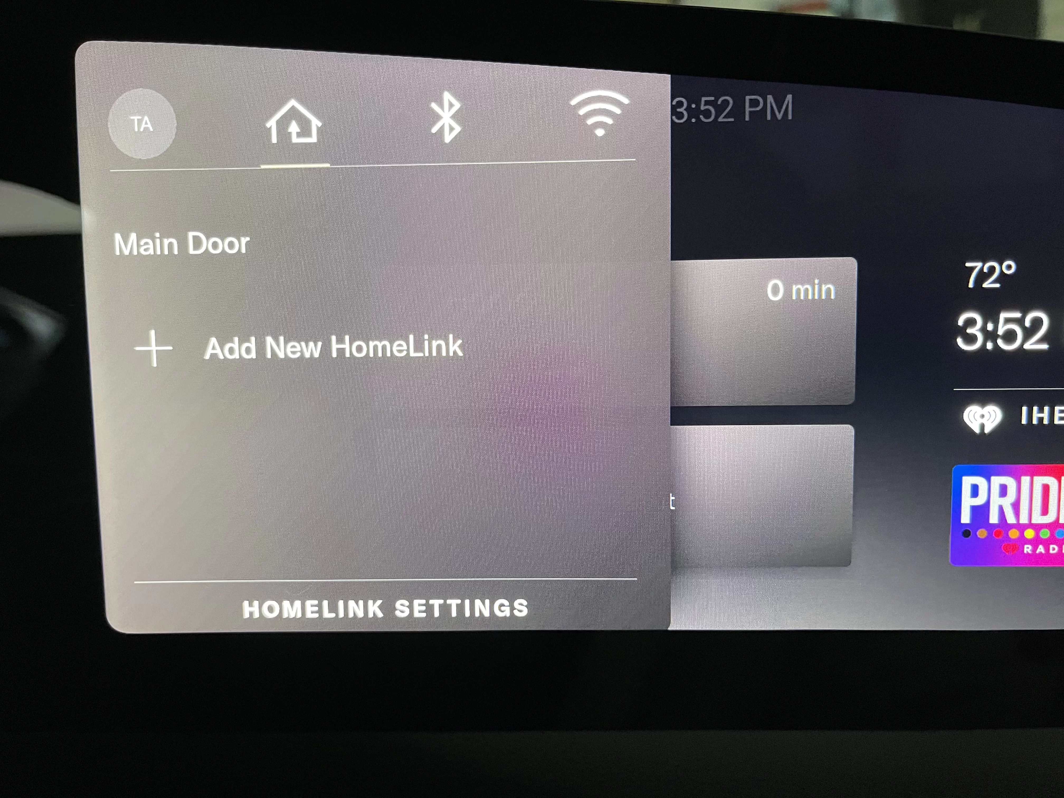

Is there any easy way to reorder the list of Homelink devices? I replaced a board in my primary opener and the car had to relearn it. With the Lucid, it's now fourth on the list, but it's the one that I use most. Since geolocation doesn't reorder the list or show the nearby one at the top, it affects usability.
I always thought the one at the top was the most recently used. Maybe not?
