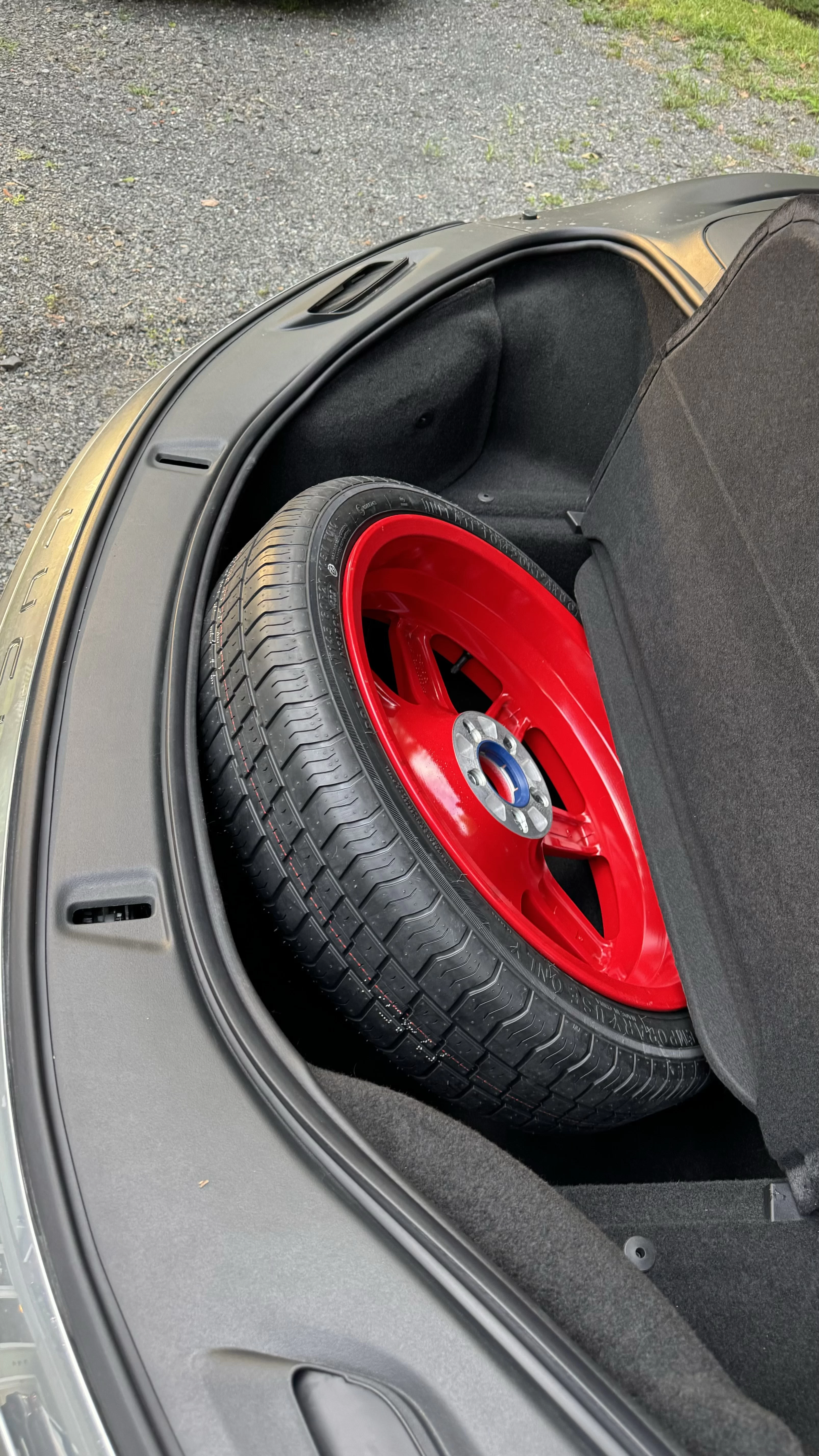

Does this EZ-Spare designed specifically for the Lucid Air fit in the frunk?
Yes, but not entirely in the bottom well of the frunk, so you can't put the folding frunk floor cover back in place with the EZ spare sitting in the bottom.
I carry the EZ spare, along with the floor jack and a scrap piece of 2x4, in the frunk only on long road trips. I also carry Lucid's tire inflator kit at all times.
Turn the spare over in the frunk and the jack and 2x4's will fit inside the wheel so that the folding cover easily fits.
+1
It's a little bit of a squeeze but my EZ Spare, jack etc all fit in the frunk well all the way, with the floor cover in place.
(I think that guarantees I'll never need it?)
2023 Pure AWD.
Mine would require a fair amount of force to jam it into the bottom well of the frunk, deforming the area below the folding cover. I didn't want to break something trying.

3 ton and the Lucid kit acts as an inflator as well.
If I recall, the trick is to put the tire in at an angle with the front part of the tire in first. Everything fits with the frunk cover on
Yes, this is what I do and it does fit.
It definitely fits, but you may have the wrong size. There was a short time period when they listed a *valid* wheel, but that didn’t fit in the frunk - they offered replacements iirc for the smaller version.
Hmm, I'll check. Mine definitely does not fit.
If you can't angle it in, contact EZSpare; I bet you got the bigger one.
I cannot see any way this would fit in.

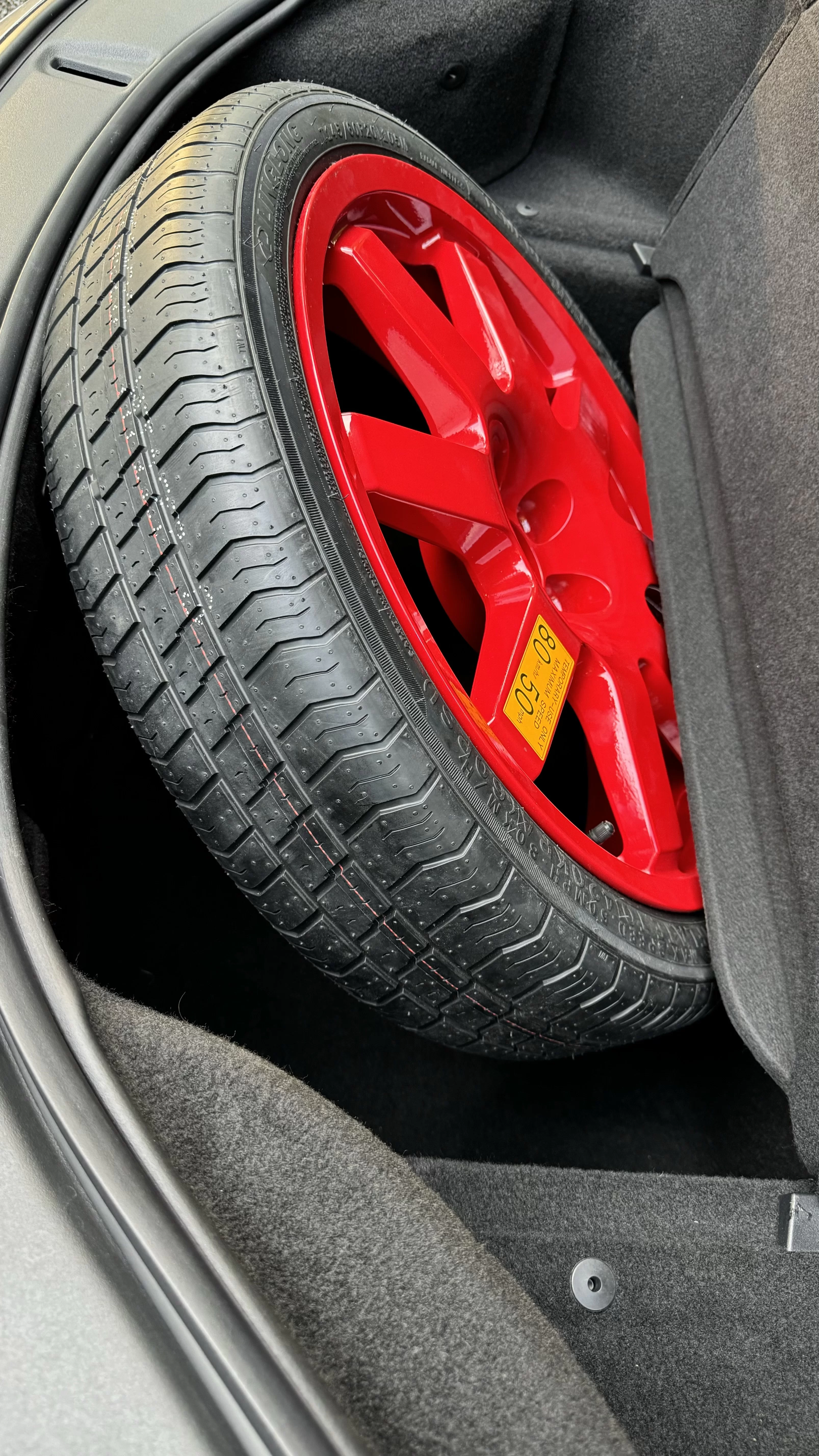

Not my car, but mine fits just like the one at the link.
