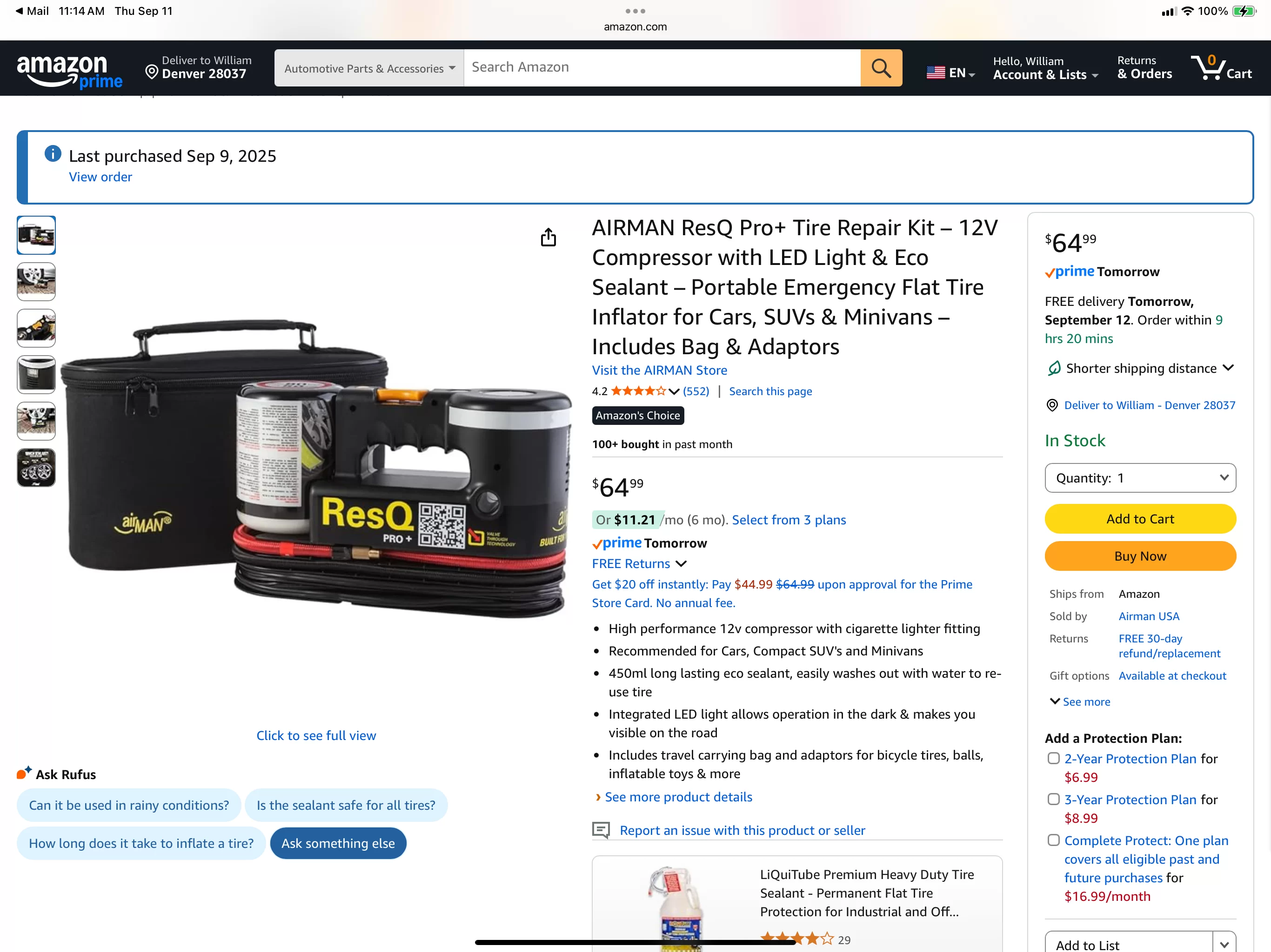

Remind me how far these tires are recommended to drive…. I seem to recall it was not far, so wasn’t so sure it’d get me to a repair shop? Though I suppose it’d at least get me to a hotel where I could problem-solve.
(Pumping up a leaking tire has been all I’ve needed for decades now, so I’m reluctant to sacrifice that valuable frunk space)
But I’d appreciate hearing a more robust case for the value of these spares!!
