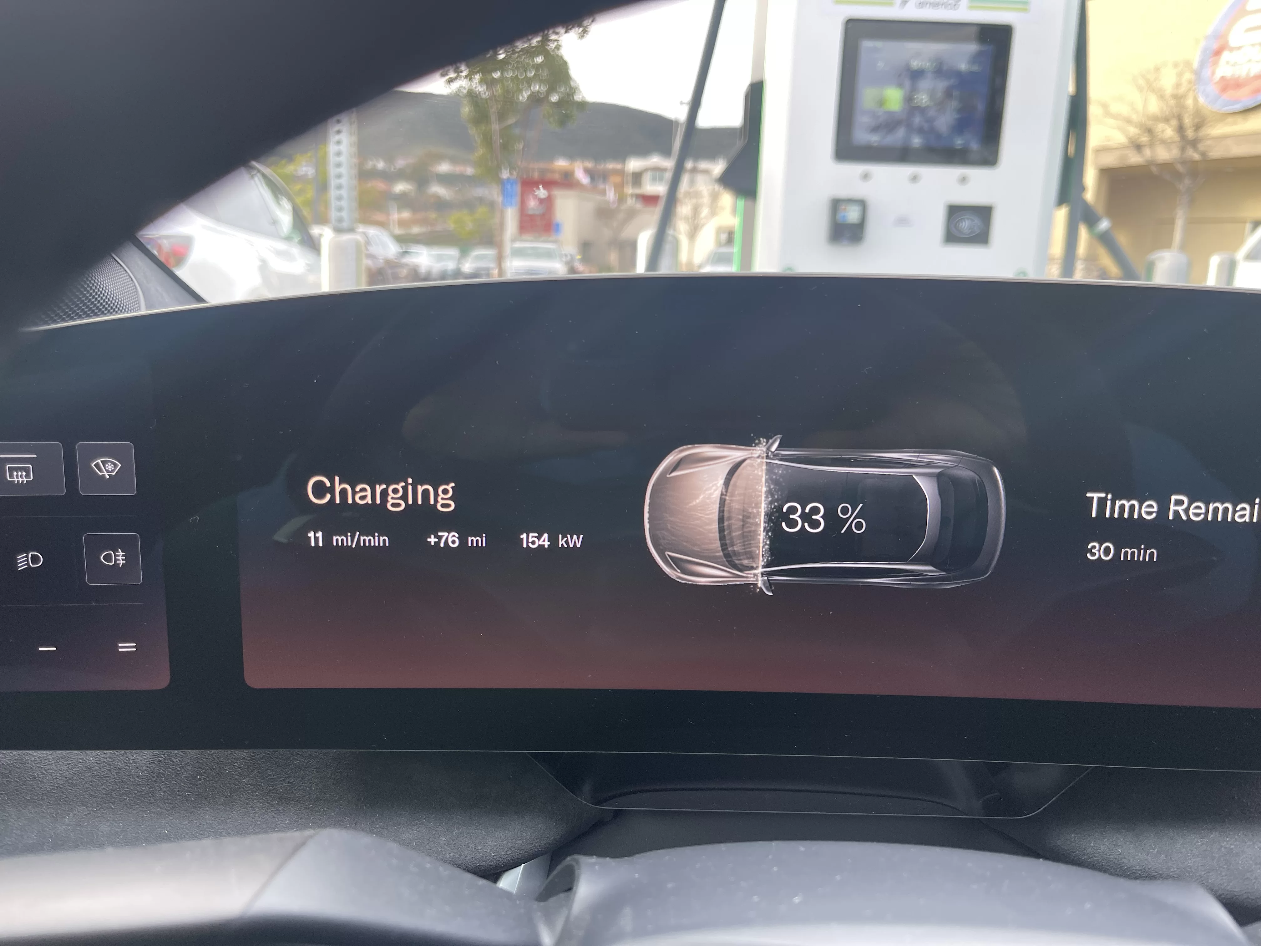

I believe that. I have done it with my Tesla several times.
The problem is , this is only true with a warm battery. With a cold battery your not getting anything near that.
Yep. He was in Southern Calif, plus he wasn’t on freeway doing 80mph.
