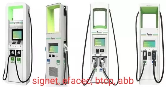

Does anyone know if EA app or PlugShare or ABRP lists what type of EA charger it is? I want to try and avoid the ABB ones on the next road trip because I won’t have much time to dick around if I get to a bad site.

...Does anyone know if EA app or PlugShare or ABRP lists what type of EA charger it is? I want to try and avoid the ABB ones on the next road trip because I won’t have much time to dick around if I get to a bad site.
18 months ago, Volvo and Polestar cars had a significant compatibility problem with Signet. Drivers would call EA customer service while desk-planning a trip to determine charger type.
The chargers that completely failed me at South Lake Tahoe were ABB according to @hydbob 's decoder photo.
@bunnylebowski you can go on Plugshare to see photos of chargers at your locations.
