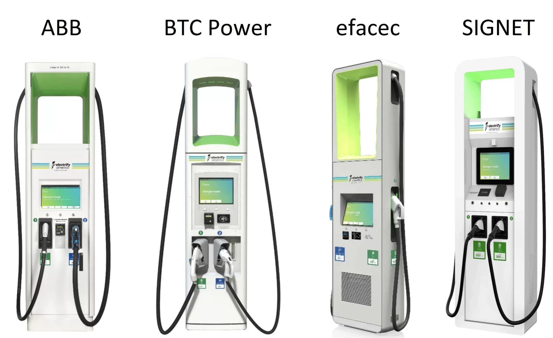

I was unable to charge at 2 different EA locations, and after extensive calls and follow-ups, I think I have some useful information to share.
EA chargers are made/installed by three different manufacturers, ABB, BTC power, and Signet. You can't easily tell which charger was made by which manufacturer from the outside but you can find out by calling the lucid customer service line.
ABB and BTC chargers run off of a windows operating system, and internally within EA, it is known these two have issues with lucid vehicles. BTC has issues with multiple newer vehicles models not just from lucid.
However, signet chargers run off of Linux and have no reported issues with lucid's or any other vehicle brand. Therefore, if you're looking for a reliable charger, I suggest you call into EA and find out where the closest signet made charger is to you. The other two brands, for the time being, are unreliable. No clear indication when their reliability will be fixed, seems like EA is just realizing the issue now after my persistent follow-ups.

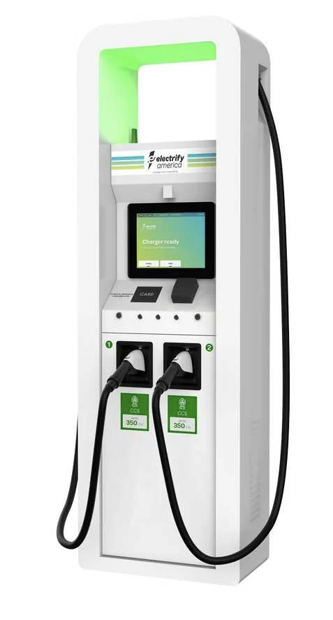

Anyone know what type these are at my local EA station?
Those are the same chargers that I use at the two locations that I visit. However, I can't seem to find an actual model number for them. :-(
The next time I fast charge I'm going to look closely at the cabinets to see if they have a name and/or model number.
Let me know if you find out, if you don't mind. I'll do the same. Thanks
