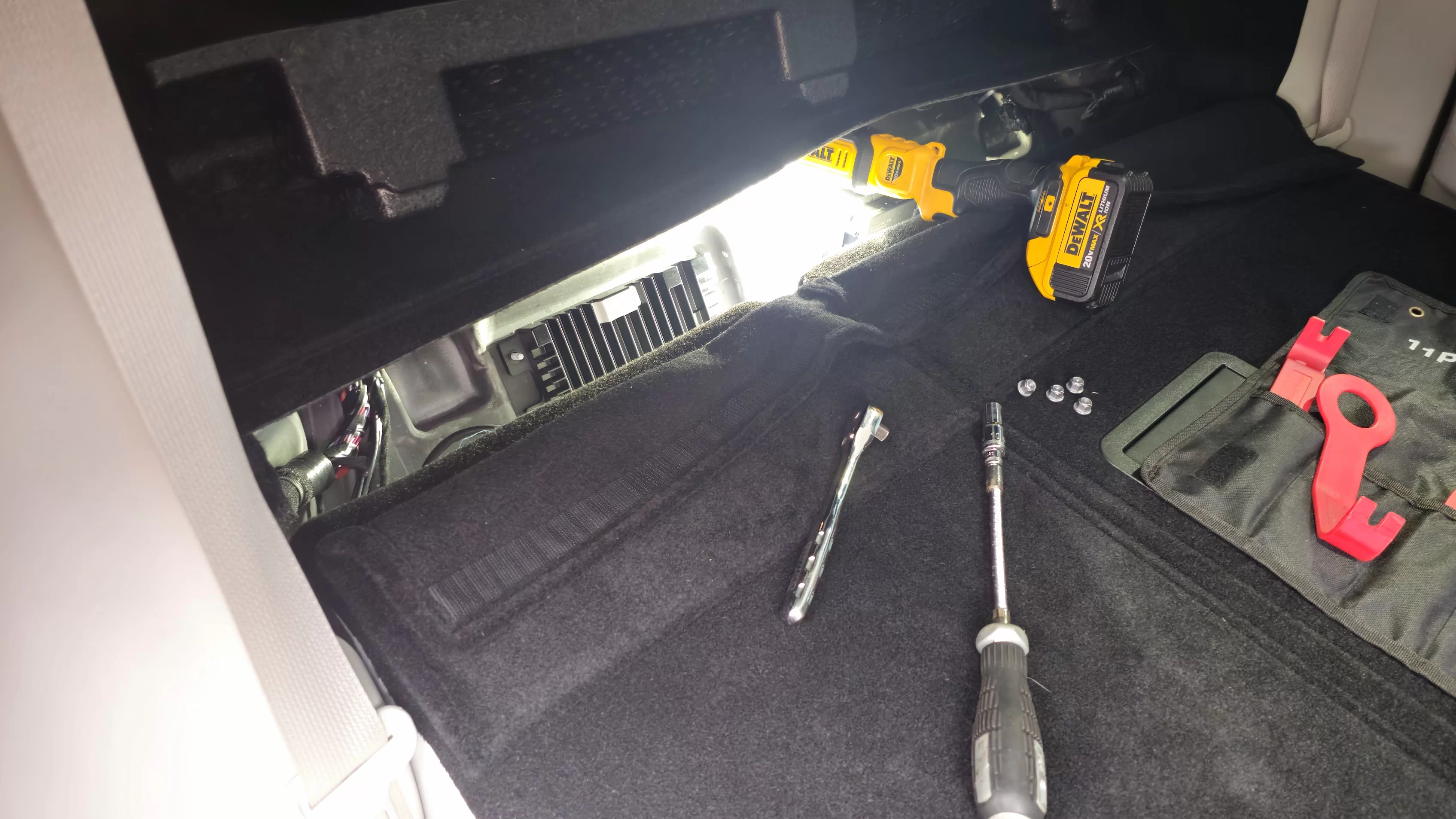

I read about a report or two that the technician fixed this super quickly after crawling in the back seat. Here is the solution you can try yourself if you face this issue.
Fold down both back seats. Peel up the carpeted Velcro flap connecting the bottom of the folded part of the seat to the trunk. Underneath this you’ll see a module labeled TCU. Reach down and unplug the main connector (the only one with multiple wires). Wait a few seconds and replug. After a few minutes LTE and WiFi should return.
Since this is what dealers are clearly doing and users on the forum aren’t reporting the issue coming back, this should be a safe try.
I’ve also seen documentation claiming a slightly different location for the TCU (towards the passenger side of this same area but on the wheel well).
This is the correct way to reset the TCU. I would just like to reiterate that Lucid absolutely does not recommend you do this yourself, at present, and would absolutely say that you have service do this instead.
I have no dog in the fight, just wanted to be super clear about it.
But yes, this is how service resets the TCU.

What exactly are you disconnecting here and reconnecting? Running into the same issue and called into service and they’re supposed to call me back and dreading the idea of going to service for this as it’s FAR from my house
You’re unplugging CAN and power from the device, causing it to reboot. This works because the soft resets don’t power cycle the device.
If you look at the image above and are facing the device in the car. The harness on the drivers side is what you unplug. It's the only one with multiple wires and wire tape on it. The other wires look like ethernet or other custom cables.
I found this but seems hard to unplug. Do you have to remove the device to unplug that cable or are you able to get it out. Was afraid to pull too hard and wasn’t sure if there was a latch that needed to be pressed to get this unplugged. Otherwise I guess I’ll remove the nuts if needed.
Please do not unplug anything if you are not comfortable with the risk and/or do not know what you are doing.
This is, at present, still something that Lucid requires service to do, not the consumer.
We, the forum, the moderators, and everyone else here assume no risk whatsoever for the results of anything you choose to do with this information.
(That said, it just unplugs and there is a normal clip on the cable/housing - you should not need to remove any screws or nuts. The other cables are more difficult; there is a clip, but first you have to pull back the red tab, and *then* press the clip down. You should have absolutely no reason to unplug any of the other cables at all.)
Again, YMMV and proceed at your own risk. If this voids your warranty, nobody here can and/or will do anything about it for you.
Just covering our bases, as nobody likes fighting lawsuits, no matter how frivolous. <3
(And as @segbrk once said: “borski, I feel misled. The TCU is easy to get to… if your body is shaped like a C and your fingers are 16 inches long…”)
