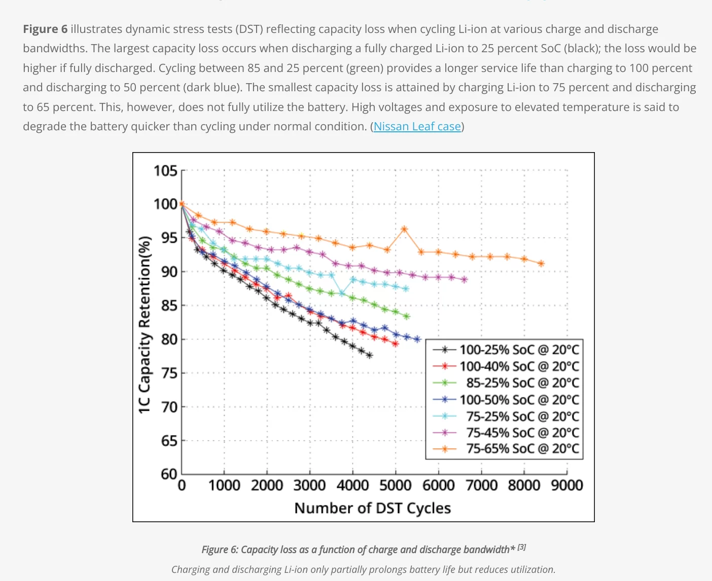

There's quite a bit of data showing that smaller charging swings significantly improve cycle life. It's been studied extensively as it is a billion-dollar question for EVs, grid storage, etc. Here is a lay article:

My daily trips are pretty short, about 15-20 miles a day. It sounds like good practice to keep the state of charge in a much narrower range than 20-80 % and I will start doing this tonight.😉😉

To use the same total driving energy, you should compare the 85%-25% curve at a 1000 cycles and the 75%-65% curve at 6000 cycles. Both are about 93%. Smaller charges are better but you have to do them more often. If you compare based on equal driving energy, there is very little difference as long as you avoid very high SOC and very low SOC.

Yeah so the 25/85 appears to have a 7% loss after 1000 cycles. If the average Lucid has a reliable full charge distance of 350 miles, then 60% (85% SOC minus 25% SOC) of that would be 210 miles. Each charging "cycle" then would provide over 200 miles of range. So if I'm reading this correctly and you charge up once a week (equates to about 10,500 miles driven per year which is higher than my average) that would mean you should still have around 93% battery capacity after 19 years. Is that a correct interpretation of the chart or am I way off base?

Your interpretation is spot on.

This and the other last few posts are not correct: a "cycle" is defined as the amount of charge to completely charge or discharge the battery (1C), not one charge of some smaller amount. One charge of 20% to 80% is 0.6 cycle. One charge of 0% to 100% is one cycle. A charge of 30% to 40% is 0.1 cycle. One cycle in my Air GT, for example, would be 112kWh of charge going into and out of the car's battery, or about 400 miles of freeway driving. I could do this one cycle by doing 100 charges from 50% to 51%, driving four miles after each charge, or one charge of 0% to 100%.
Each "cycle" corresponds to all the energy the battery can hold - all the miles you can drive on a single charge. So 1000 cycles would correspond to about 400,000 miles!
Maybe I am misreading it but this implies that a cycle is only the full energy in the battery when goiing from 100% to 0% SOC. This is from the article referenced above.
  • Case 1: 75–65% SoC offers longest cycle life but delivers only 90,000 energy units (EU). Utilizes 10% of battery.
  • Case 2: 75–25% SoC has 3,000 cycles (to 90% capacity) and delivers 150,000 EU. Utilizes 50% of battery. (EV battery, new.)
  • Case 3: 85–25% SoC has 2,000 cycles. Delivers 120,000 EU. Uses 60% of battery.

This is why my charging strategy is approx 75-45, which is the purple line. I don't plug every night because I'm not concerned about the phantom drain.
However, i don't drive daily so others may prefer to be charged at 80% everyday. Just understand that moves you to the right on the x-axis more rapidly.

Great data here in the chart from GMan. Before getting my Lucid Touring I had a Tesla Model S for almost 10 years. I too charged it every night and almost never above 75%. My wife has it now. I'm curious to see how long it will go.

Okay Deane, that's even better. I was happy with the 19 years in my incorrect calculation above. But now with your correct information it is far greater than 19 years. So I will just continue to charge when my SOC gets down around 25% and charge up to 85% and not even begin to worry about battery degradation. I probably won't even charge once a week unless I'm doing a longer trip. I did read on another manufacturer's forum that their manual states it is good practice to charge up to 100% once a month or so as long as you don't let the car sit at that 100%. Also, apparently that manufacturer has a built in 5% buffer reserve so when you charge to 100% you are actually only charging to 95%. Not sure what buffer/reserve my Lucid has if any?? Also, not sure it really does make sense to charge to 100% once a month??
