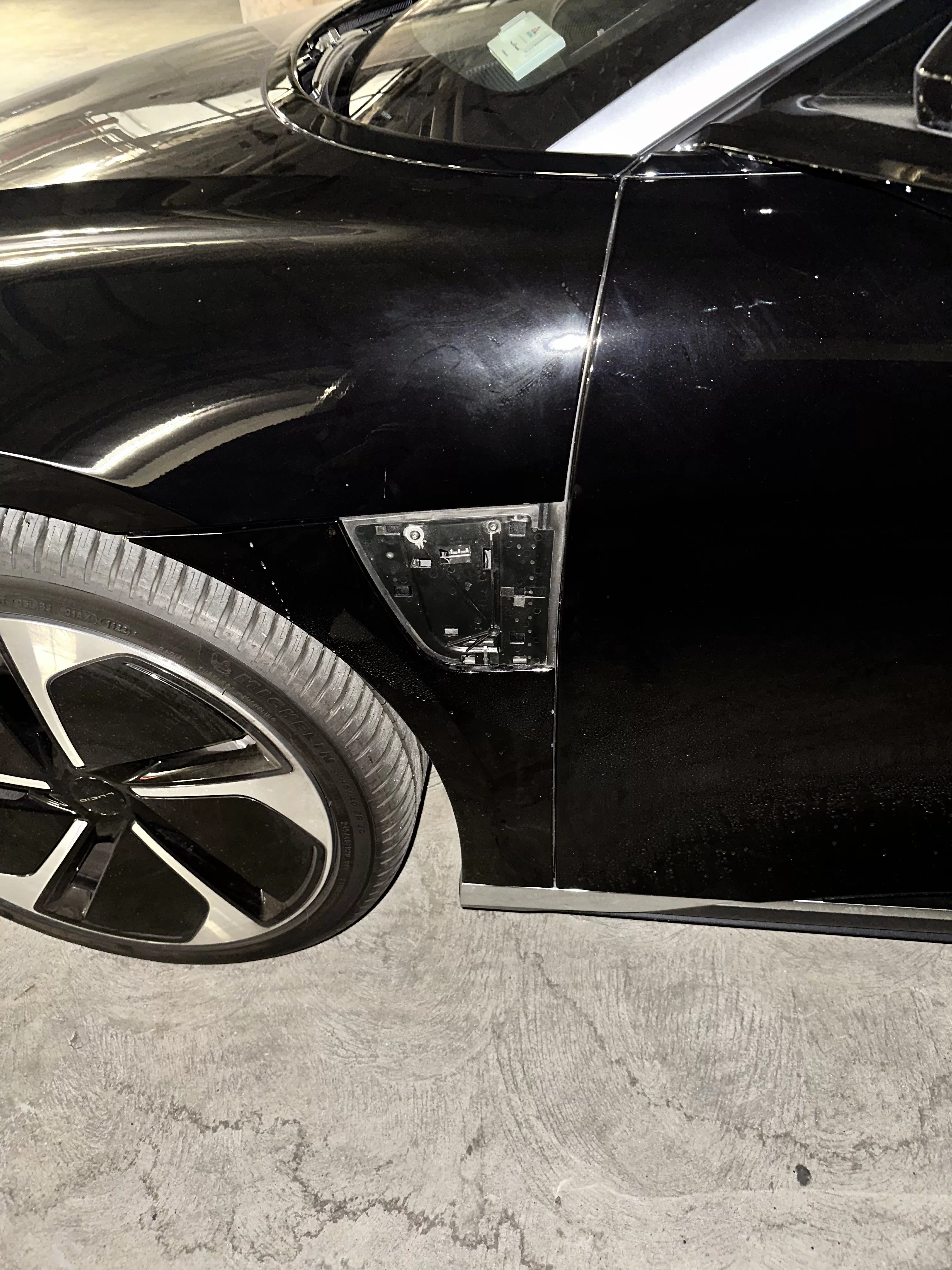

Got out of my car to find the charge port panel gone! Is 3M tape really what holds this in place?

This just happened to me yesterda.y Does Lucid Service charge to repair this? How much if they do? My car is brand new with just over 1k miles on it.

Pro tip: Be careful at EA stations when removing the charging chords. Pulling down will loosen the charge port cover and cause it to eventually fall off.
Gotcha, thanks for the tip and sounds good. I'm glad they are handling these at no charge. I was beyond frustrated last night when I saw it and I noticed right after I got the car back from Valet so I figured it was their fault initially--glad to know this is a known issue.

Gotcha. Thanks for this. I just called the Service Center in Beverly Hills, CA and spoke with Brandon there. He had me send him a photo and mentioned that the part needs to be ordered and painted (they don't come factory painted).
He then mentioned I would need to pay out of pocket for this at which point I expressed to him my dissatisfaction with that determination (car was delivered on 12/31 while I was out of town, I didn't first drive the vehicle until January 22 when I returned home--nearly a month later, has just over 1k miles and everything was present on the vehicle on the morning of 3/6 but it was missing by that night. I also expressed how there are pictures floating around that 3M tape is used to secure this piece and it's ridiculous for a >$100k car to have this issue this new and early on in it's life/use).
He had me transferred to his supervisor, Aaron, who still insisted I may have to pay until they can get the car in to inspect and determine in warranty coverage or any adjustments (he did mention it could have been poorly attached at factory but he would need to inspect it to make that determination as someone also could have simply "pulled it off" which I highly doubt Valet would have done that).
He gave an estimate that he ensured me he may be completely wrong about at the moment but will get parts and body to confirm and get back to me by tomorrow with a final quote but the mentioned the part could be about $150 and about 2 hours of paint may be required at their rate of $200/hr so I'm looking at >$550 + tax and labor to install but he insisted this may be an over estimate as well.
This is very upsetting considering the delivery experience (pre-, day of, and post-delivery all had issues).
Do you, or anyone else who's encountered this issue (@Drendino @Casadeagumar) know which service centers covered yours at no charge and is there anything anyone can provide me to help show this shop how the cost was taken care of without and customer billing?
