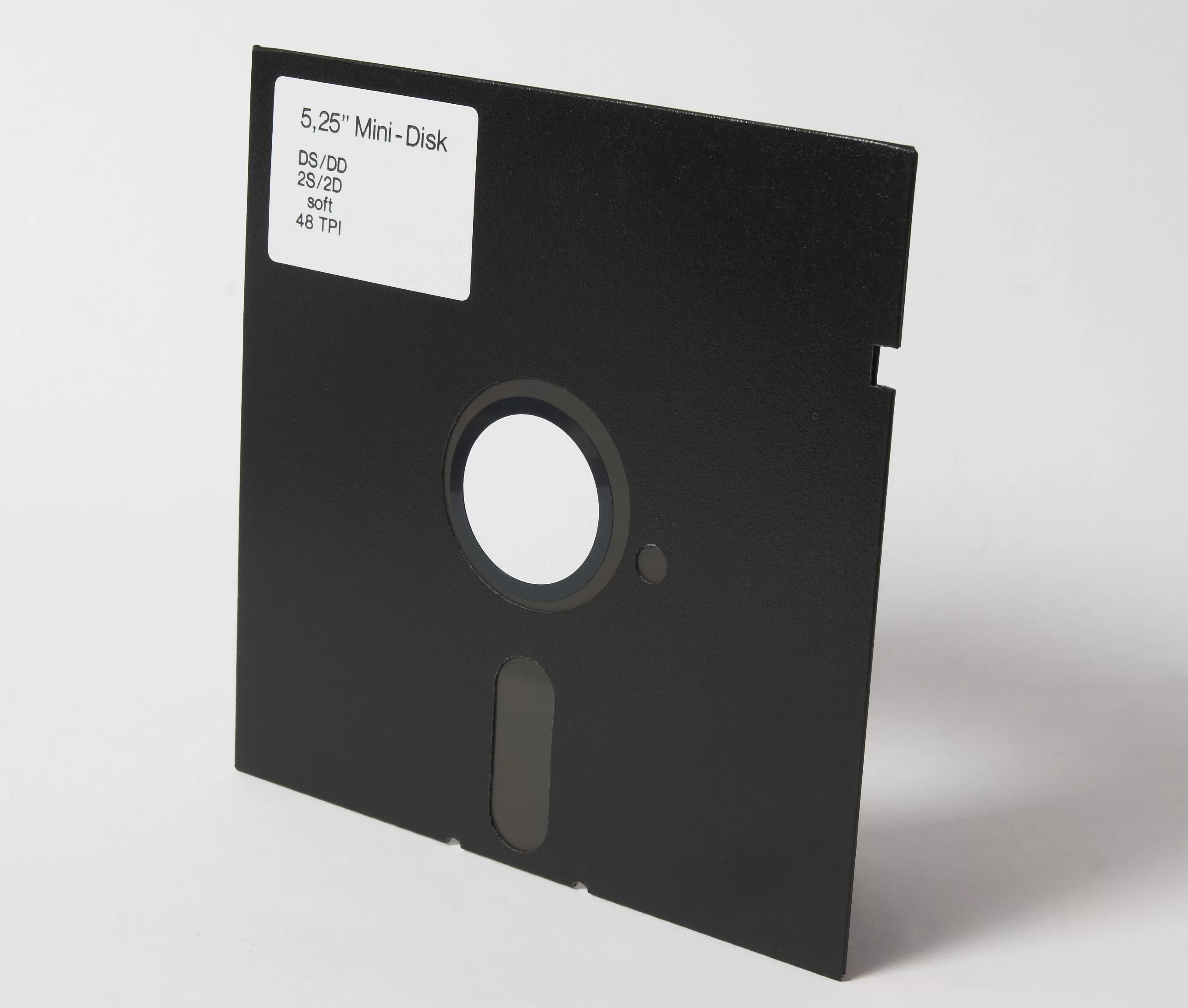

Just don’t walk by any 🧲
I'm surprised you young-ens know about 5-1/4 floppies. My first programing class was in MS-DOS ...and yes, printers almost never worked back in the day. I see that in 2024 printers are still the most unreliable part of tech. Still trying to create the "paperless office", by making proprietary 0.002 ml ink cartridges for every printer.
