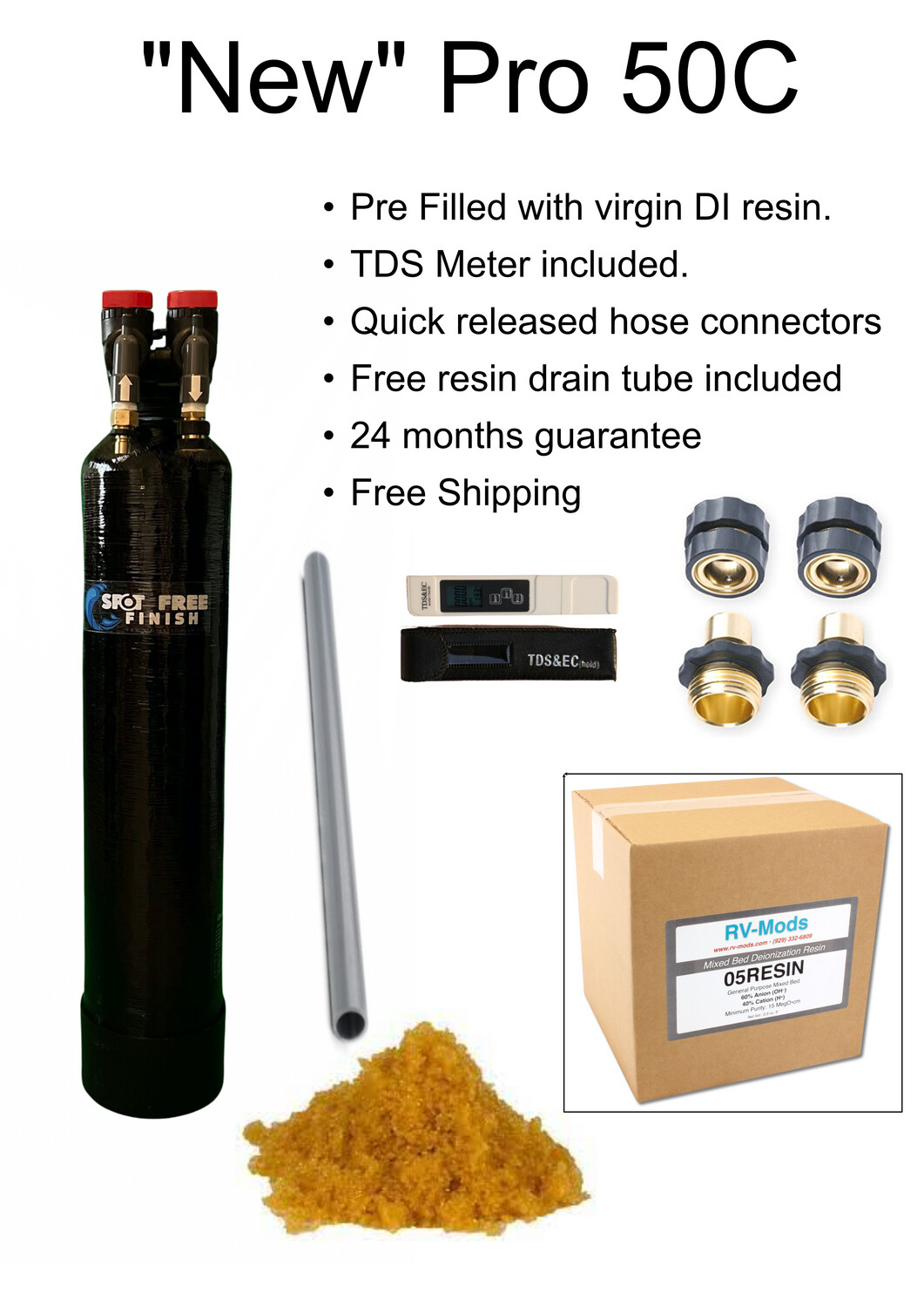

Any thoughts on:
Good unit! Almost exactly how I build mine - makes them nice and mobile. I would recommend checking your TDS (cheap Amazon meter does the trick) before buying it. As @hydbob said, the media can get spent pretty quickly. The higher the TDS the less life it will have. Not only that, 2000 gallons sounds like a lot, but it also goes quickly. I recommend getting a 1.5 GPM low pressure washer to feed the DI water to. This will restrict flow while keeping pressure high so you can maximize the life of the media.
Thanks for the advice, @Coltonw011.
The Arizona water is notoriously bad so I'll keep my expectation low.
