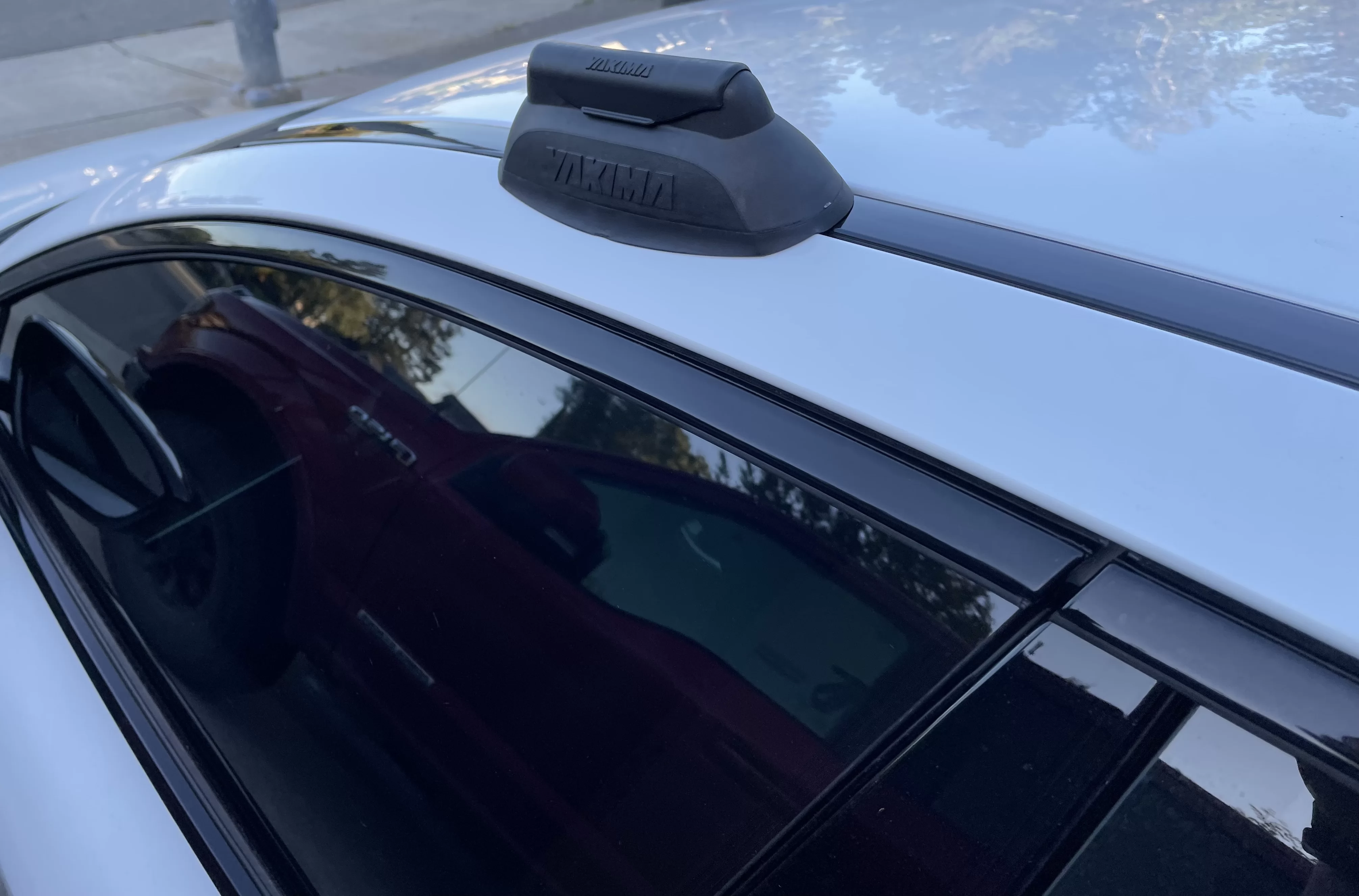

Has anyone tried Yakima Landing Pad 11's? They are made for fixed mounting points.
Tried mounting a Yakima Landing Pad #11 last night and it works with a M6x50 bolt. The kit comes with a variety of bolts and the M6x50 is the longest of the M6's provided. Did documentation come with the Lucid roof rack? Anything about how much to torque the bolt?

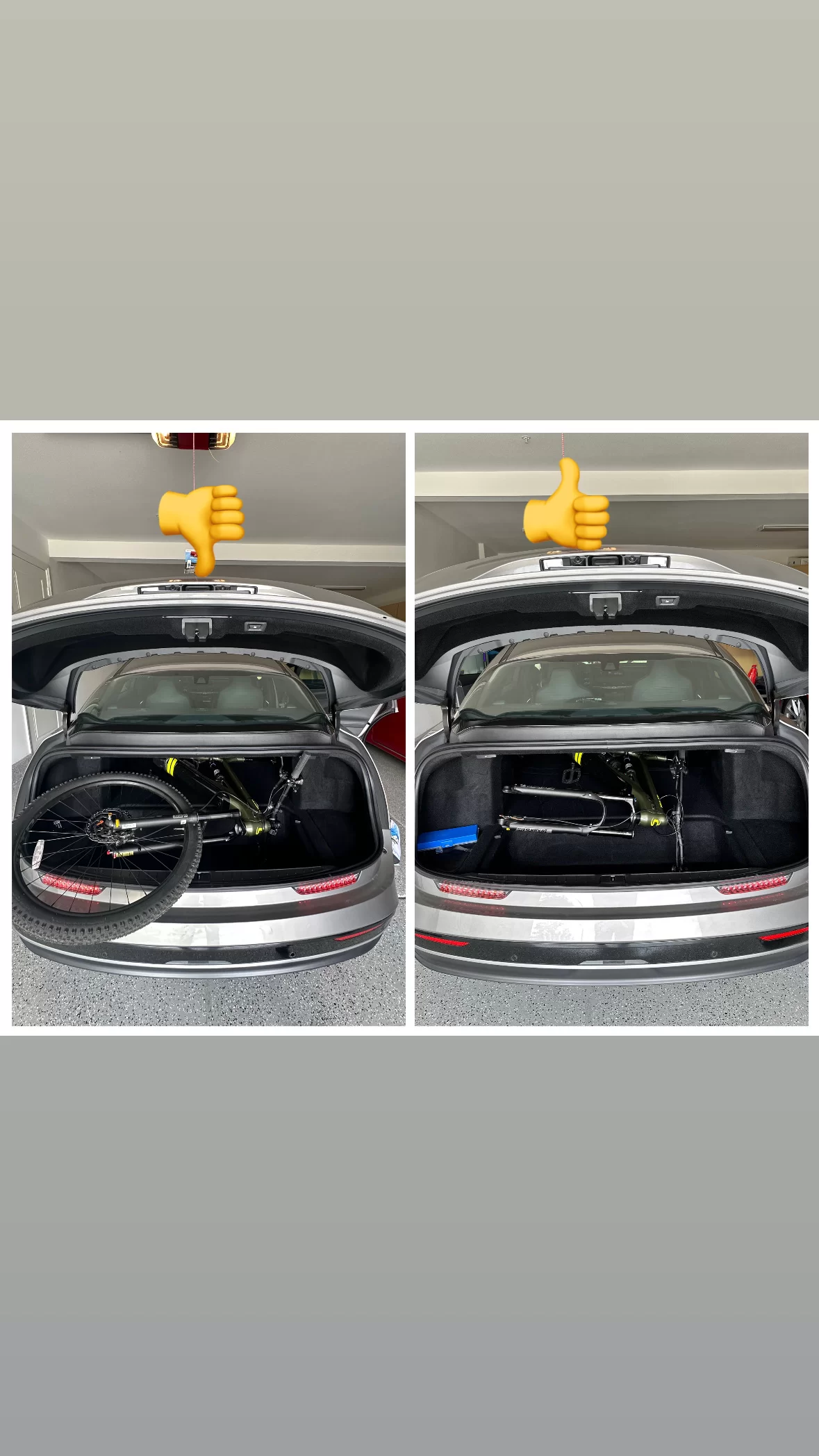

This isn't perfect for everyone but on Saturday I picked up Montague Paratrooper Highline folding mountain bike. This is not a Brompton city bike, it's a full-on mountain bike designed for and used by the US military, with 27.5" x 2" knobbies. I can remove the front wheel and fold it in <30 seconds. It weighs <30 lbs. It fits in the trunk easily without lowering the back seats. It comes with a burly cordura bag 36"x28"x12", so you could put one or two more in the back seat floor. They make road bikes too.
I'm extremely pleased with this.

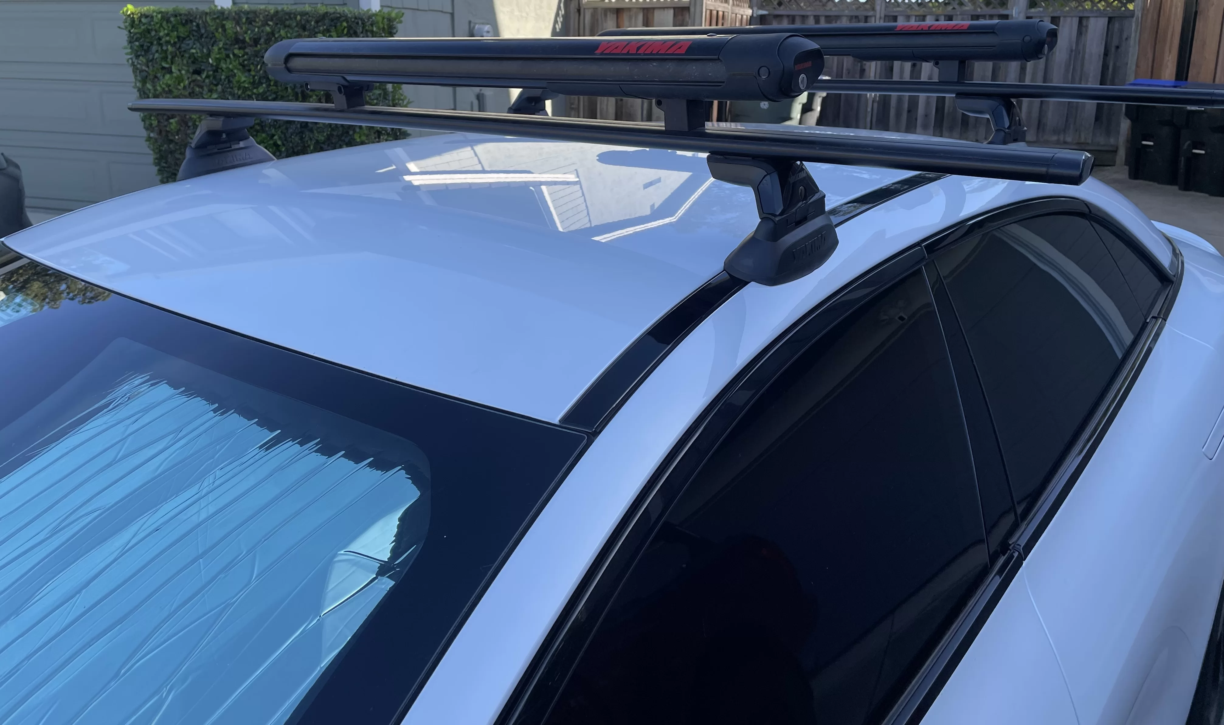

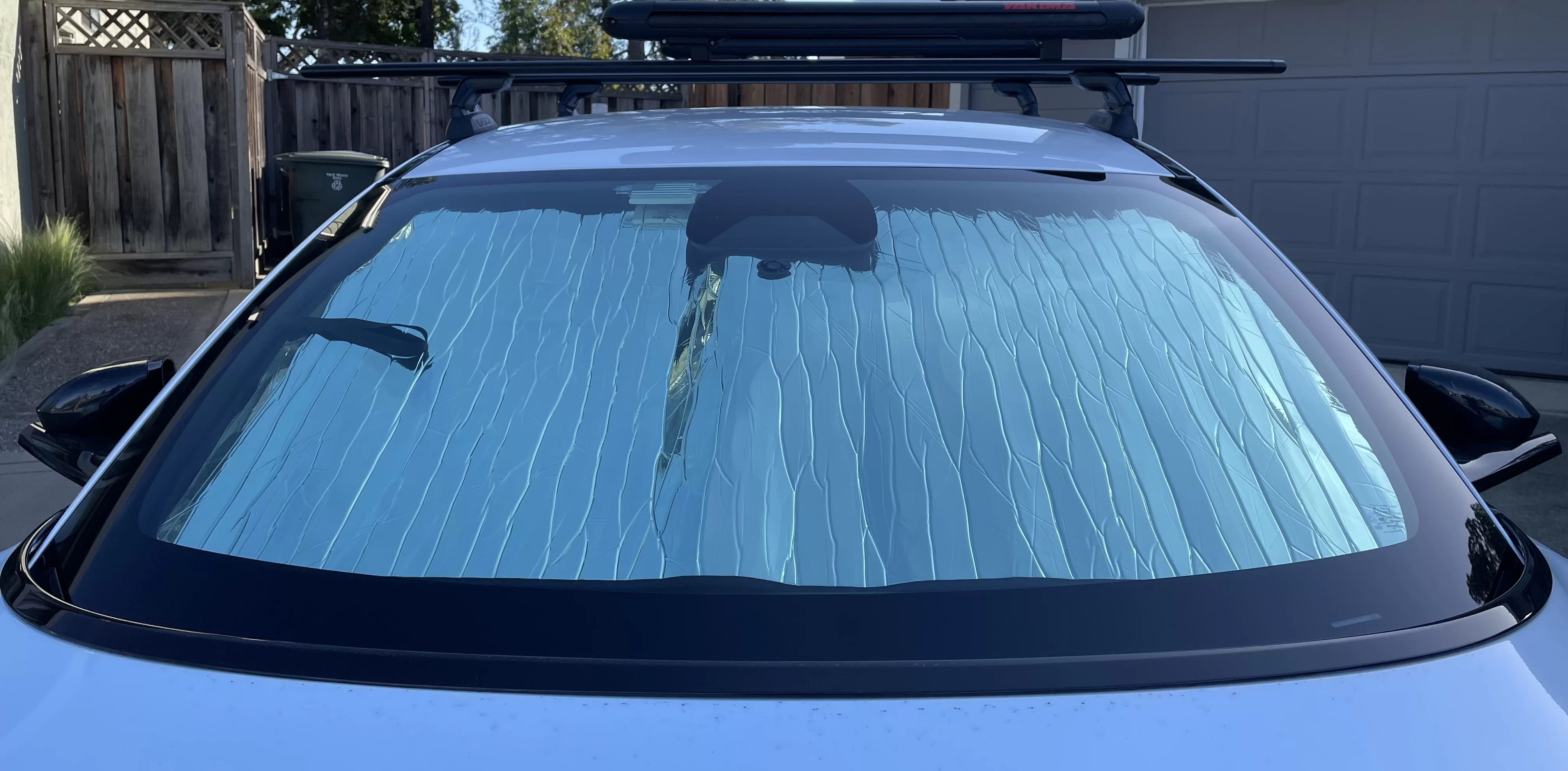

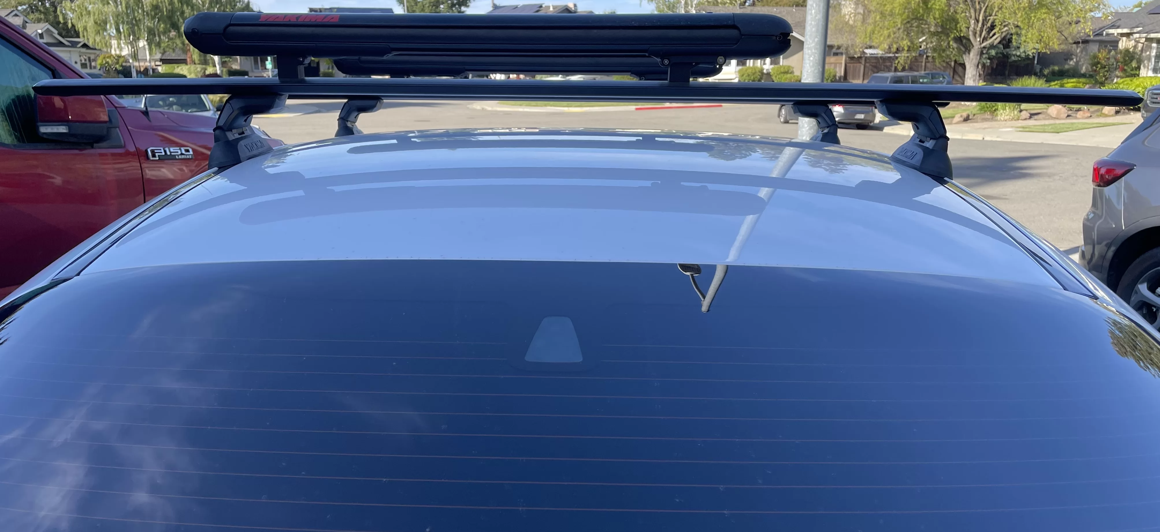

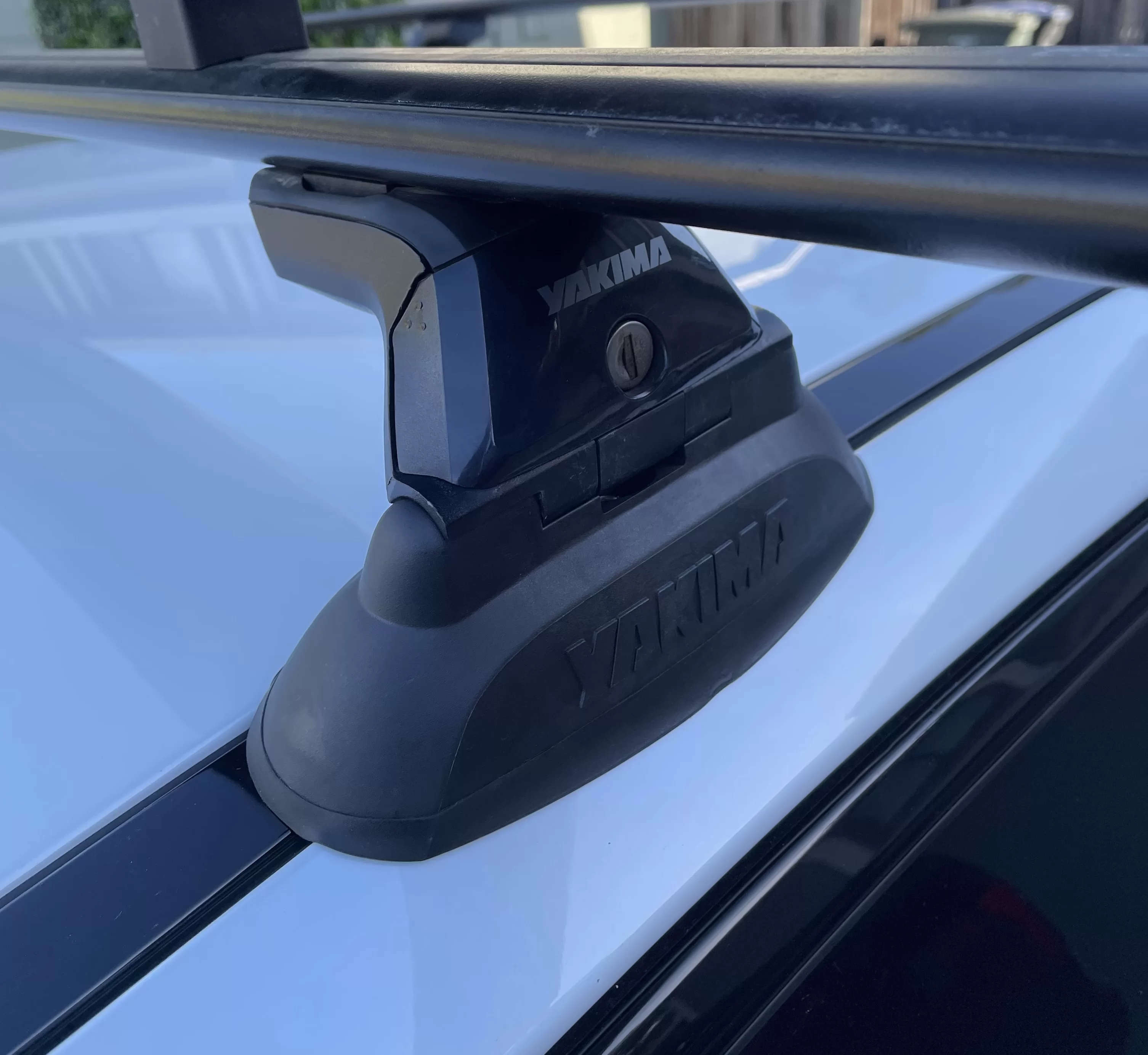

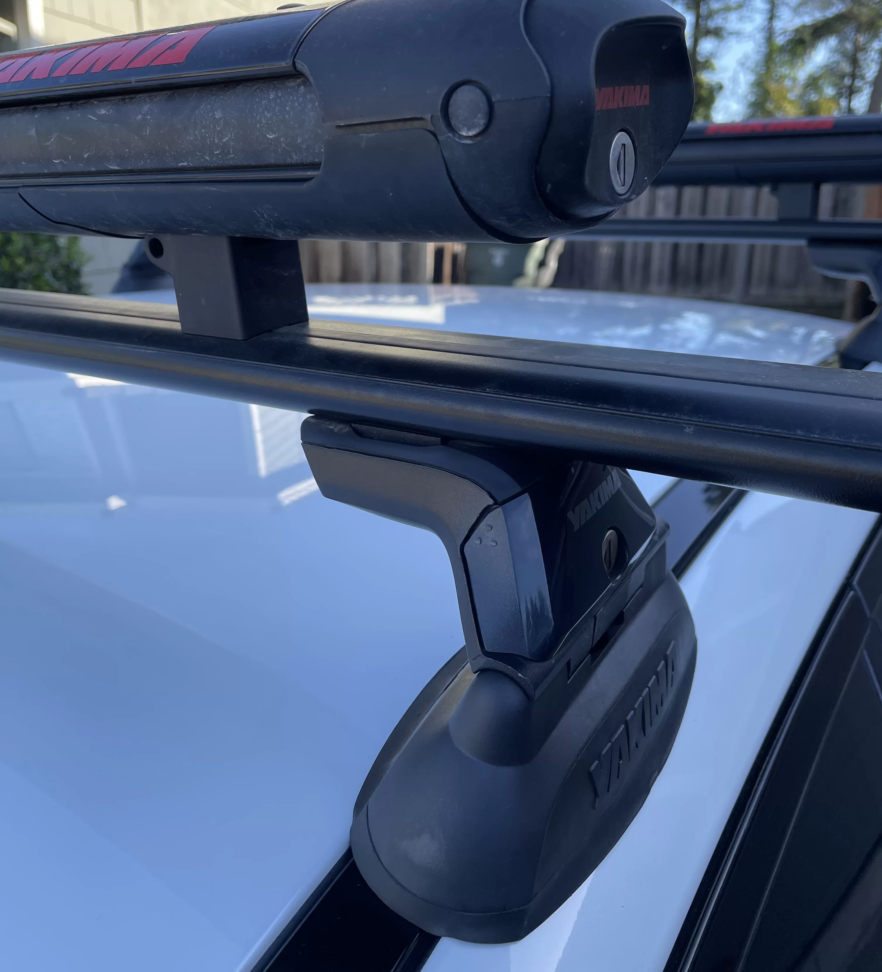

Didn't get a chance to get the rest of the Yakima landing pads installed today, but the plan is to use the skyline towers with the landing pad #11 and jetstream cross bars. Anyone with the official Lucid crossbars have the instructions that came with it? Does it have the torque specs for the fixed point roof mount? Does the list indicate the torque? Fortunately, I have the hard top, so no glass to worry about. Another bonus of the hard top, have a head liner I'll be able to tuck the power cord for a dash cam, but need to get into the passenger side fuse box. That's another project though.
Finally got some time to test the Yakima parts. Landing Pad #11, Jetstream bars, Skyline towers, and Fatcats look good to go.
That's fair as its your opinion. For me, I am already invested in quite a bit of Yakima parts and don't see a need to buy bars that are specific to a single model of car. Thank you for being honest and adding to the conversation.
How secure is the mount?
The Landing Pads don't budge when I grab the rails and shake the car. Haven't heard from anyone what the proper torque is for the Lucid bars, so with the Yakima parts, I just tightened it till it was tight. One thing to note, I don't have the glass top.
