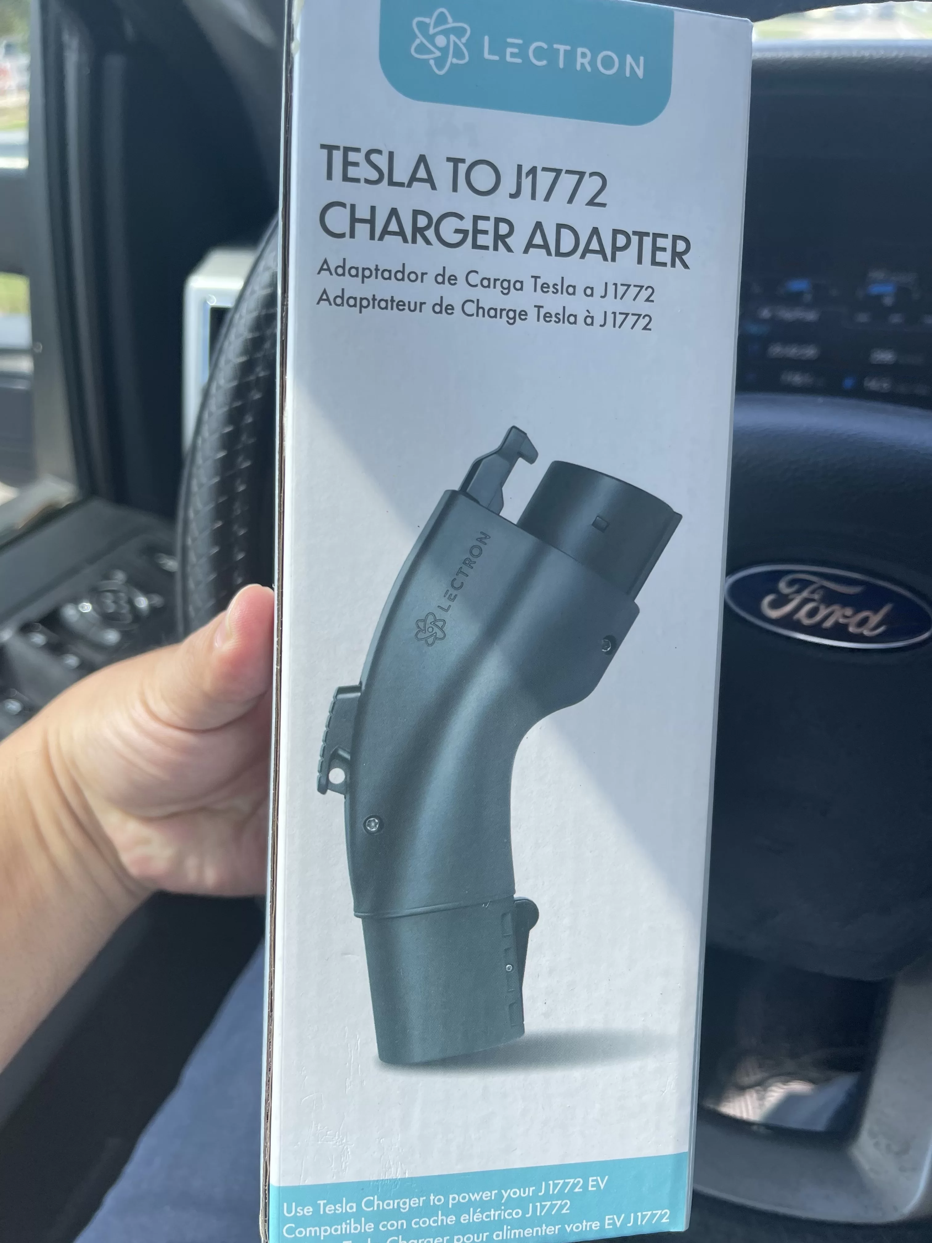

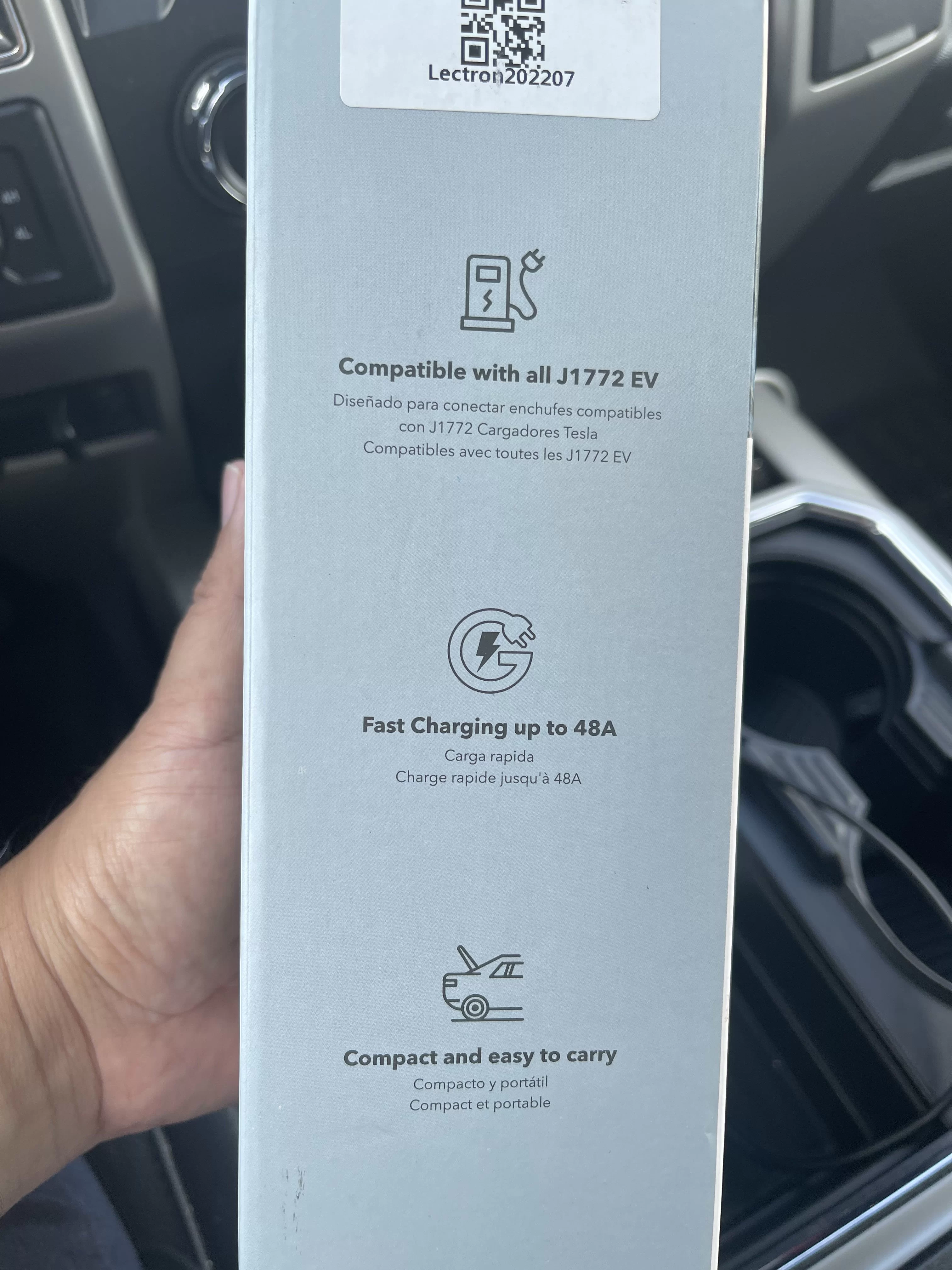

Currently I use a 100 amp Tesla home charger for my model S. I am trying to figure out how to use it once I receive (hopefully soon) my GT
Any ideas any of you have would be greatly appreciated.
Buy this! (Amazon.com)
