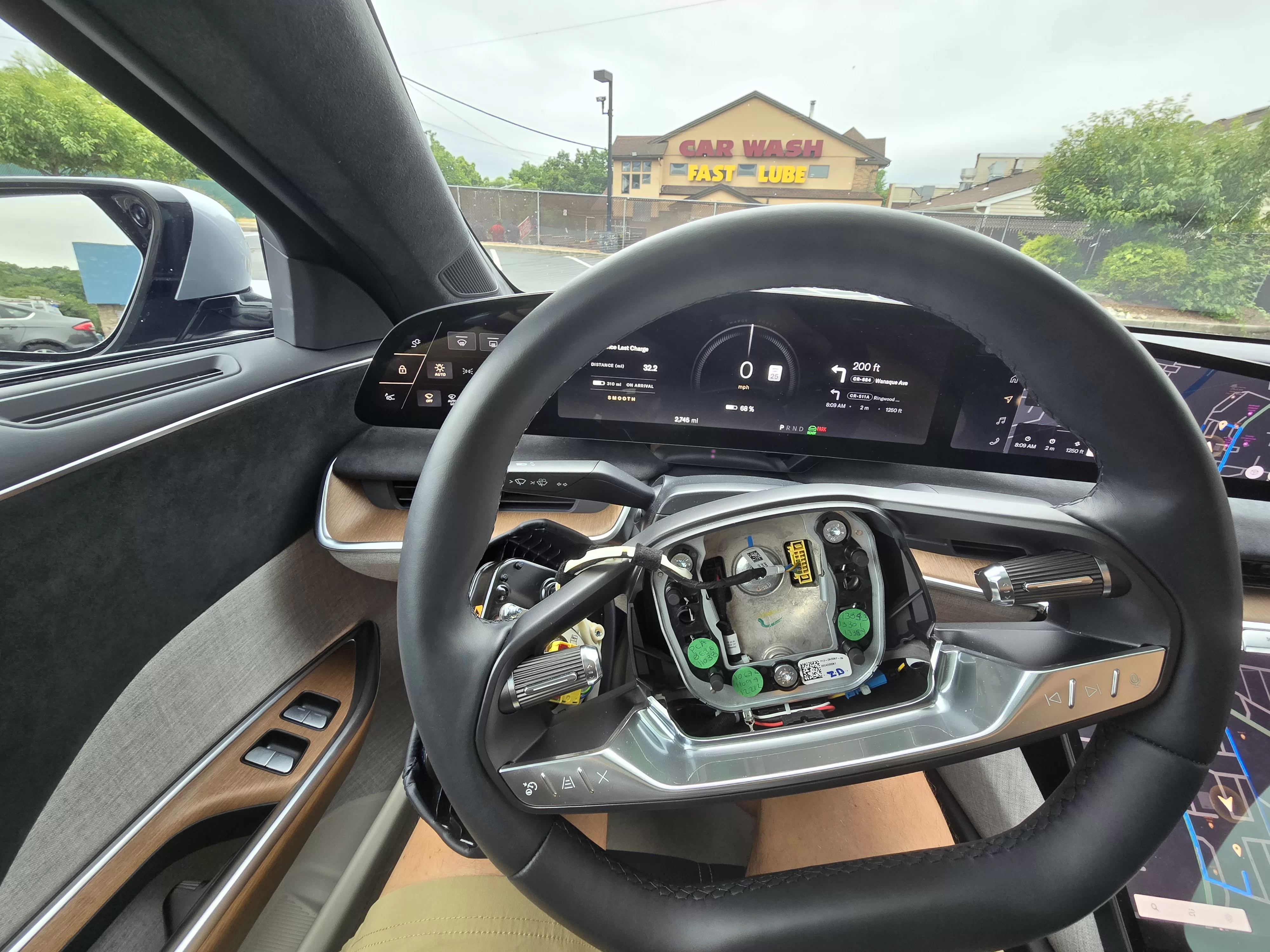

Not once, but twice in three days. It plopped into my lap while steering at low speed.
happened to anyone else?
Will advise how the service visit goes, i just sent the picture to them at KOP.

I would suggest you immediately park the car and do not drive it (until service picks it up, which they should). In the event of an airbag deployment, this could end up being extremely dangerous.
Whoa ... this could end up being something serious with other manufacturers dealing with airbag issues.
Ummm. I would not drive the car at this point. Who knows if that’s going to effect the Airbag deployment.
Definitely do not drive it. Looks like you've already done so, but if not, call Customer Service ASAP.
Just to reinforce, keep in mind you're not just driving without a safety feature, you're now driving with some small explosives pointed at your face in an unknown state.
This is what I meant by “airbags are no joke”
If I had to guess ... the airbag assembly looks like it is normally held in place by two mounting holes and removed by pulling it straight out. From the picture, it looks like a piece of plastic broke from the mounting hole the right?

Looking closely at the picture, I think there might be two metal rods which provide some sort of tension on the 2 plastic pegs on either side of the center of the unit. The pegs were symmetrical with nothing appearing to be broken. That's what made me think perhaps it was an assembly issue and that it simply wasn't properly snapped in from the factory.
Looking more closely at the picture, though, it's possible that the the metal rods aren't providing the required tension to hold the pegs in place, but that will be up to them to determine.

Btw, in both instances, the steering wheel was inverted at the time the unit separated from the wheel. The photo shows it with the wheel returned to center, but that's not when it came off either time. I was definitely uphill in the second instance.

Joking aside, there are a bunch of sensors involved in telling the airbags to deploy, but in the end, it's a circuit closing which ignites a tiny capsule of explosive gas. A spark or a short or something could presumably do the same without any involvement from the usual systems. Hopefully that's not an easy thing to do by accident, but... you know, it also shouldn't be easy for your airbag assembly to fall off by accident. Assumptions are out the window at that point.
The wiring from the car to the airbag unit is in that self-contained bundle which is still happily connected to the car and wasn't disturbed at all, thankfully. Near as I can tell, it's the physical mechanism that keeps the airbag housing attached to the steering wheel has failed to some degree, no longer providing the required tension to keep it in place in all circumstances.
Granted, not great AT ALL, however, I'm not making the leap as to how that, in and of itself could lead to a deployment.
If the dislodging COULD generate trigger an accelerometer within the unit itself, that would obviously be cause for concern, however, given that it's evidently triggered by various sensors in the vehicle, that also seems unlikely from a system design standpoint at least.

No, I'm not talking about triggering a sensor. Forget all the sensors and computers and stuff, there's still a little explosive sitting there that is triggered by electricity. Electricity gets in the wrong place (shorted wires, sparks, whatever), it goes boom (or at least pop). No logic involved, just electricity. You hope all those wires are properly insulated and held apart from each other, but like I said, you also hope that the front of your steering wheel doesn't fall off. Not by any means saying this is likely to happen either, but you still don't look down the barrel of a gun to find out if it's loaded.

New steering wheel and airbag are being installed. They weren't able to replicate the issue at all, and found it was seated correctly when I sent it back to them. I'm bummed as we're unlikely to know the root cause. Engineering has MANY questions. I'm glad they're taking so much interest and wish they were able to replicate or find the smoking gun.

Regarding the airbag, the work order says that there was likely a 'special tools removal' that took place at some point and that the bag was not correctly reinstalled. It's odd because the person I spoke to on the phone specifically said he saw no signs that that bag had been removed with any tools in the past, which is why they had so many questions for me on behalf of the Engineering team.
Ultimately they couldn't replicate the issue at all but replaced the airbag out of caution and replaced the steering wheel because it was creaking like an old rocking chair in a Spaghetti Western.
