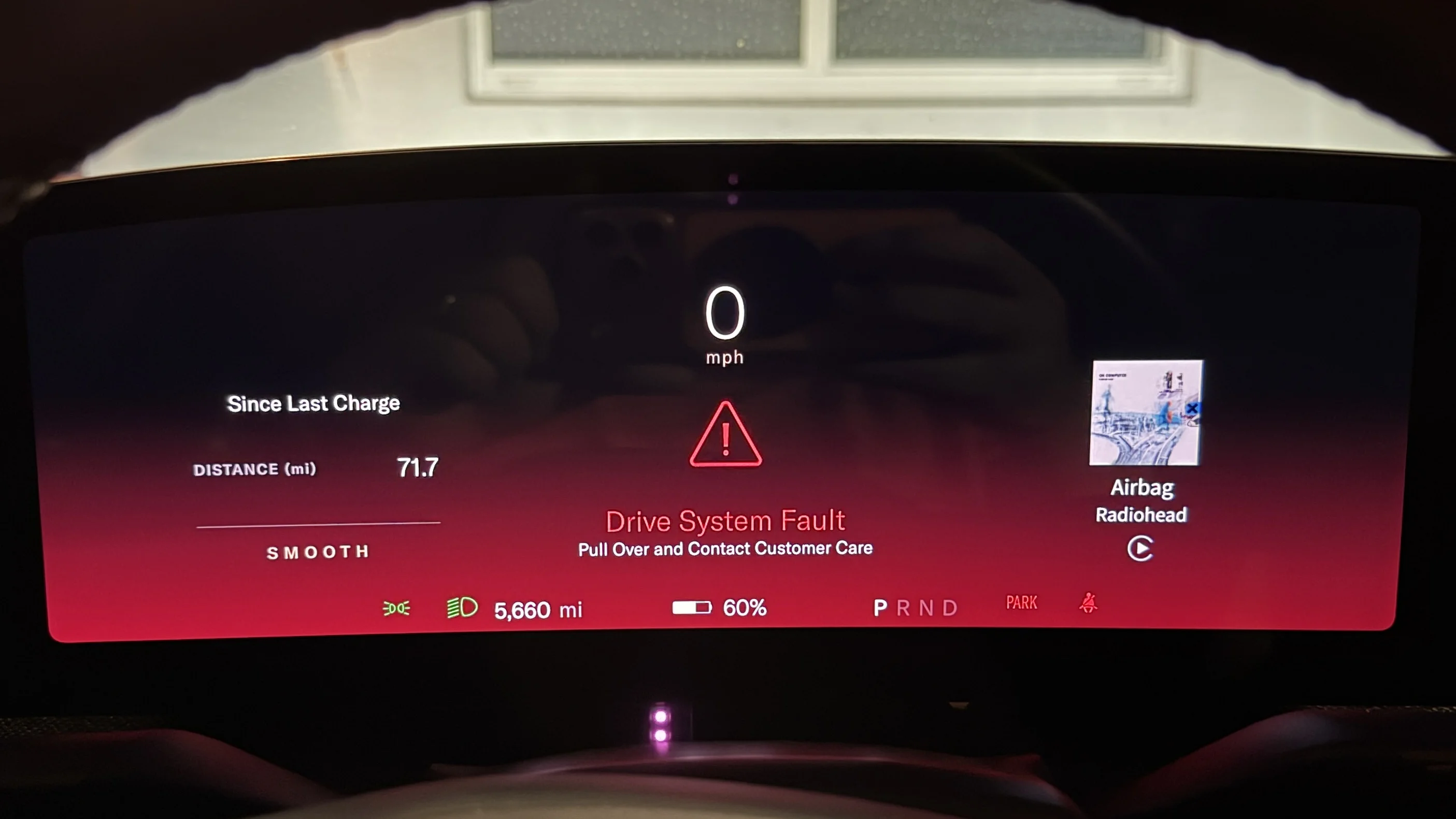

24 Pure on 2.9.2. Updated and car is fine. I hadn’t tried putting it in drive since the update but just did and confirmed it’s fine. Thank god because I’m 400 miles from home. I did see the same Low Battery emergency alerts in the app others have reported right after it finished but it cleared after about 5 minutes. Possible that was the BMS update part of the OTA.
I just got the same problem. Finished updating about two hours ago. When I went to check out the update, a “Drive System Fault” alert went up in the screen as soon as I pressed the brake pedal. Software v2.9.2
The car is bricked, wont go into gear.
For those seeing this issue, you may be safer to not interact with the car too much. Seems like there’s a good chance the car can’t engage HV meaning the 12V battery is on its own, and could die if you keep it awake too much. I have no inside knowledge on the specific issue, but fruit for thought as I do this kind of work.
