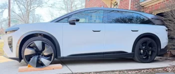

My new wheels are here! I think they look badass.
Tires (265/40R22, 285/40R22) will arrive soon.
I look forward to finding out what penalties I'll incur due to the increased wheel weight (~50lb).

That is definitely going to be a unique wheel design for the Gravity!
Here are my new wheels installed. I absolutely love how they look and fit!
Thanks to @037 for being the 1st to figure out custom wheel specs for us.
Because these are heavier wheels (+10lbs of unsprung mass),
I do experience a noticeable difference is ride comfort over bumps and road imperfections.
I am considering another set of custom forged Magnesium 22" wheels in the same style.
They'll be about 30lbs (40% lighter).
Currently, there is a shortage of 22" Magnesium blanks in China!

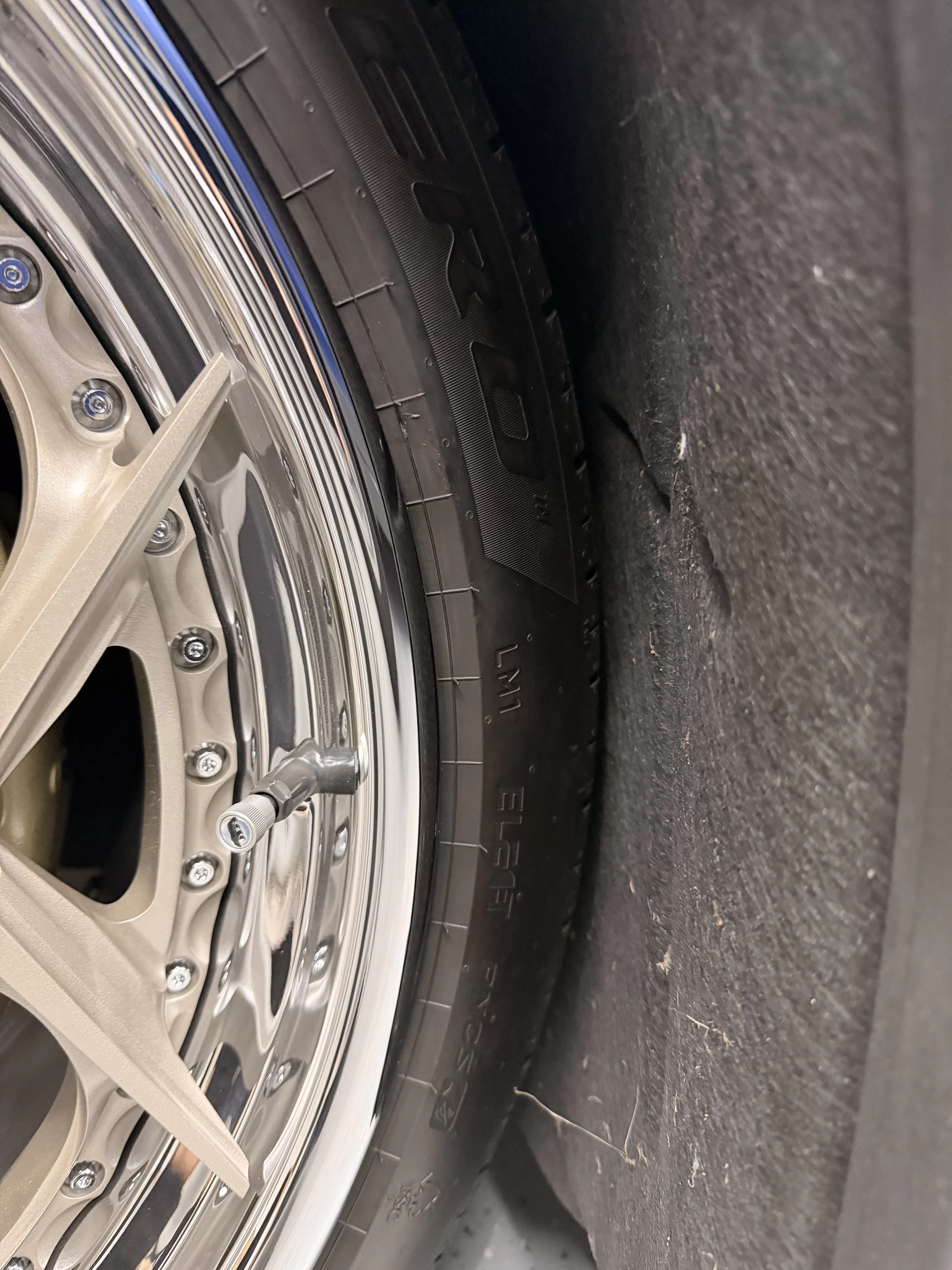

What offset did you decide to go with, front to back? 265s on 22’s generally call for 9.5” wide wheel. But I see you went 275…
Wheel weight?
Wheel weight?
Offset is ET38 front and ET38 rear.
Specs ended up being:
22x9.0 front
22x10.0 rear
5x120
64.1 CB
ET38 all around
Tires are:
275/40R22 front
285/40R22 rear
I initially considered 265s up front, but after digging into Pirelli’s recommended rim width range (9.0”–11.0” for the 275/40R22), the 275 is completely within spec on a 9” wheel. It’s not stretched & not outside manufacturer tolerances.
You’re right, 265 is commonly paired with a 9.5”, but 275 on a 9” is still fully compliant & gives a better front contact patch for a 6,000+ lb EV SUV. That’s ultimately why I went 275 instead of 265.
Wheel weights are:
32.8 lbs front
33.9 lbs rear
Forged construction.
Clearance has been perfect so far. No poke, no rubbing, no weird steering feel. ET38 keeps it conservative and OEM+ rather than aggressive.
If anything changes after a few hundred miles I’ll report back, but right now the setup feels planted and looks exactly how I wanted it to. 🫡
