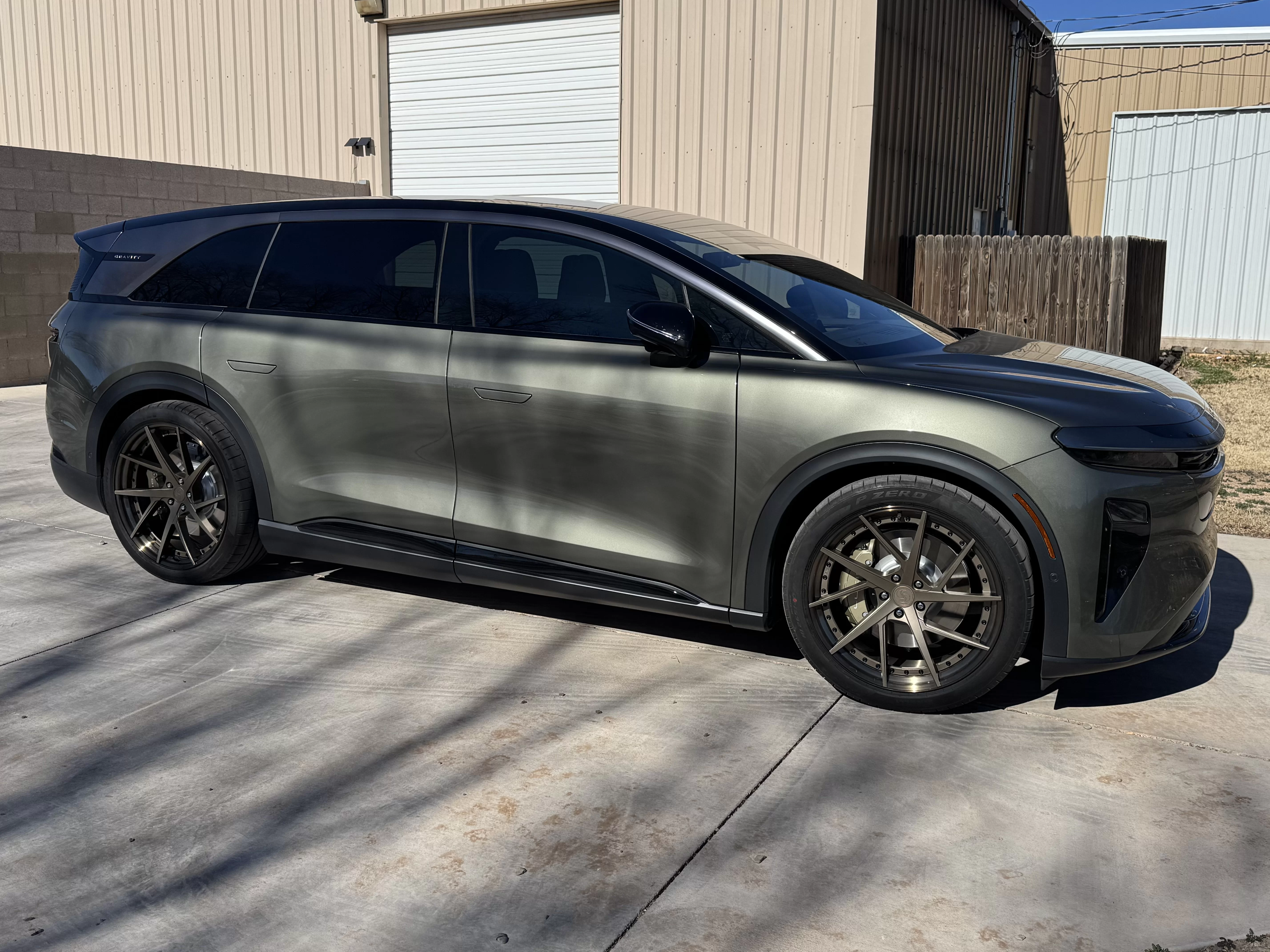

Curious your ET on these? Does it feel close to flush to you? Most aggressive ET so far looks like ET24 front / ET31 rear from Jackles post. Getting my gravity in a few weeks and looking to get some custom BBS LM style wheels and would like as deep as lip as possible 😊
Pretty sure he went factory spec.
I pushed it as far as 22x10 with 30 et and 295 front and 285 rear.
Right now I am running 22/23” with 275/295 and they fit just fine at stock spec. I am considering spacing them out by 22.5mm.
On stock et a 22.5mm spacer would put you at an et of like 21.5 front and 28.5 rear? Be curious if that is doable. More aggressive than your 30 et. Would love to see how it sits.

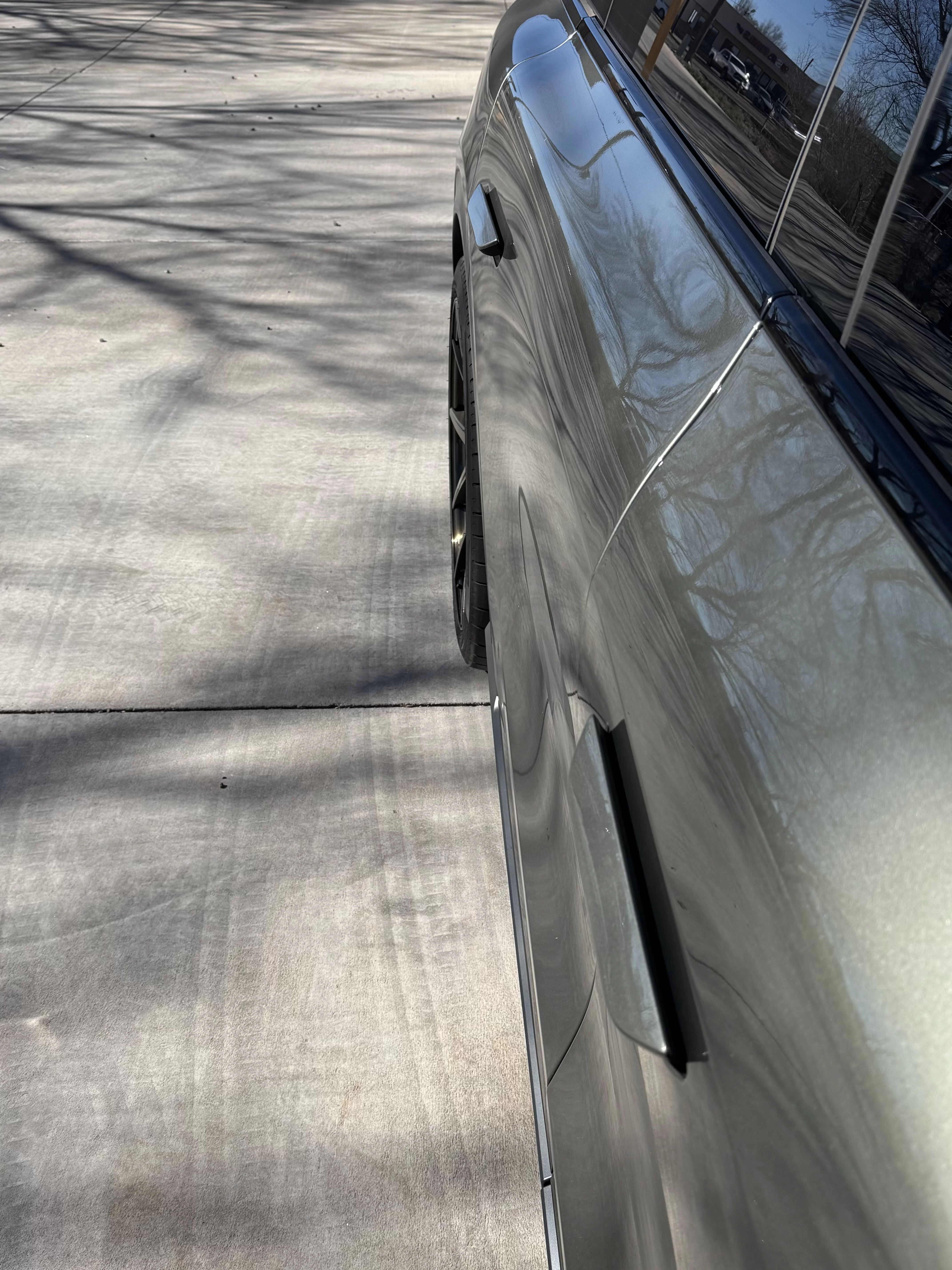

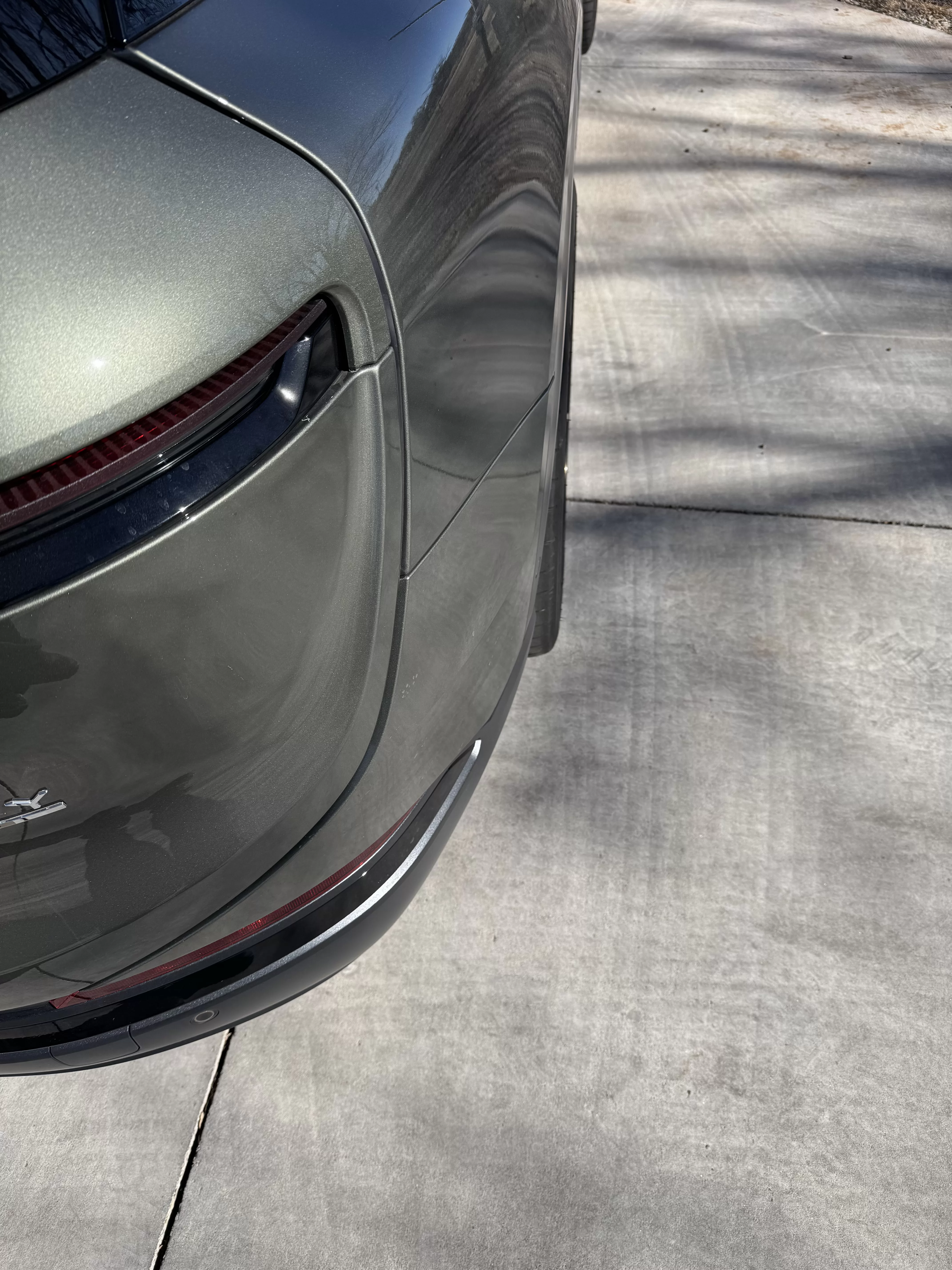

@Skywalker is correct. My final specs are
Front: 22x10 ET24
Rear: 23x10.5 ET31
This gives a flush fitment on “low” but tucks in at very low.
I went 0.5” wider and +20MM offset compared to stock specs.
An additional +2.5MM sounds doable..

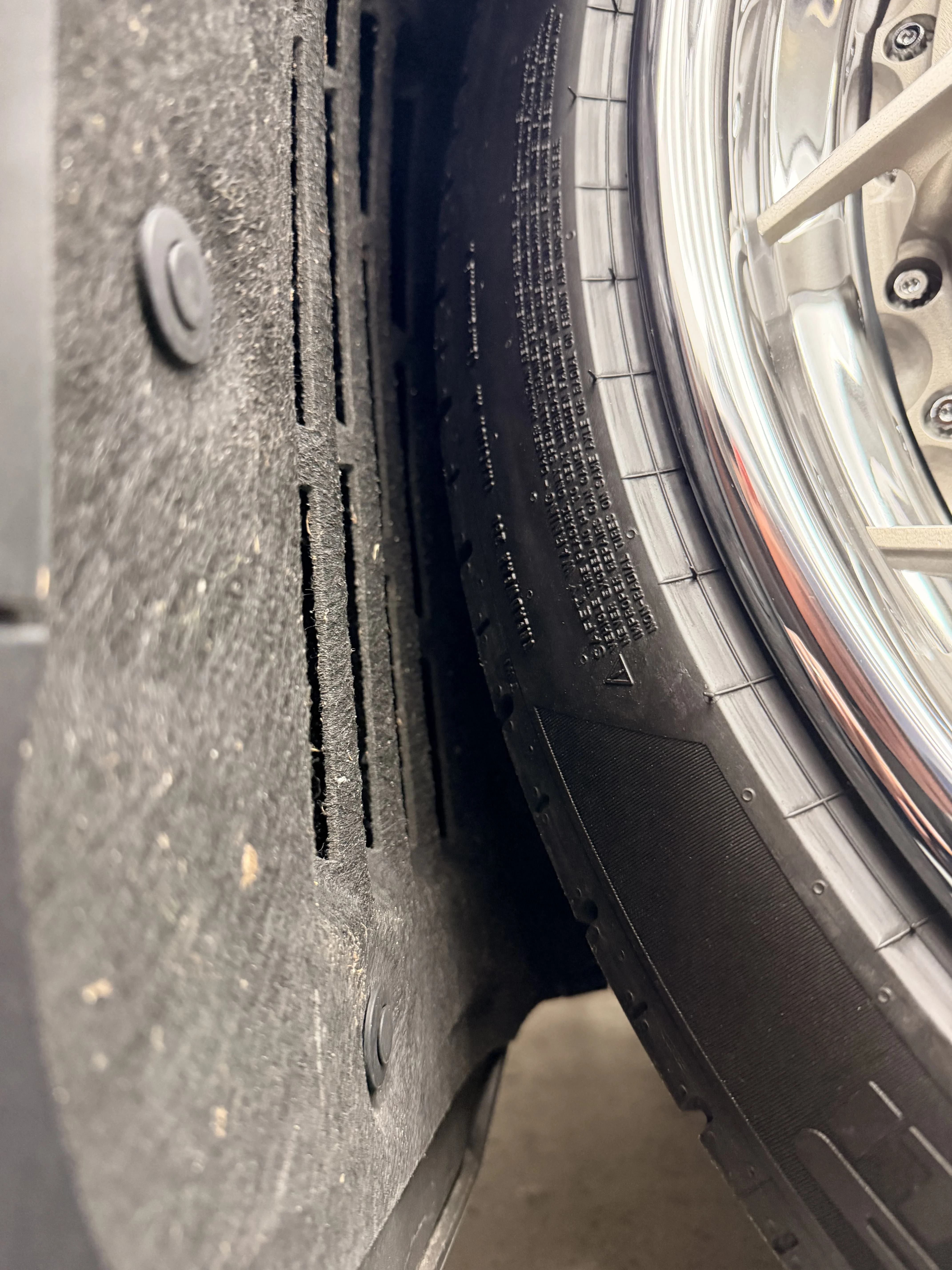

This is how close I am to rubbing on +20MM on “low”

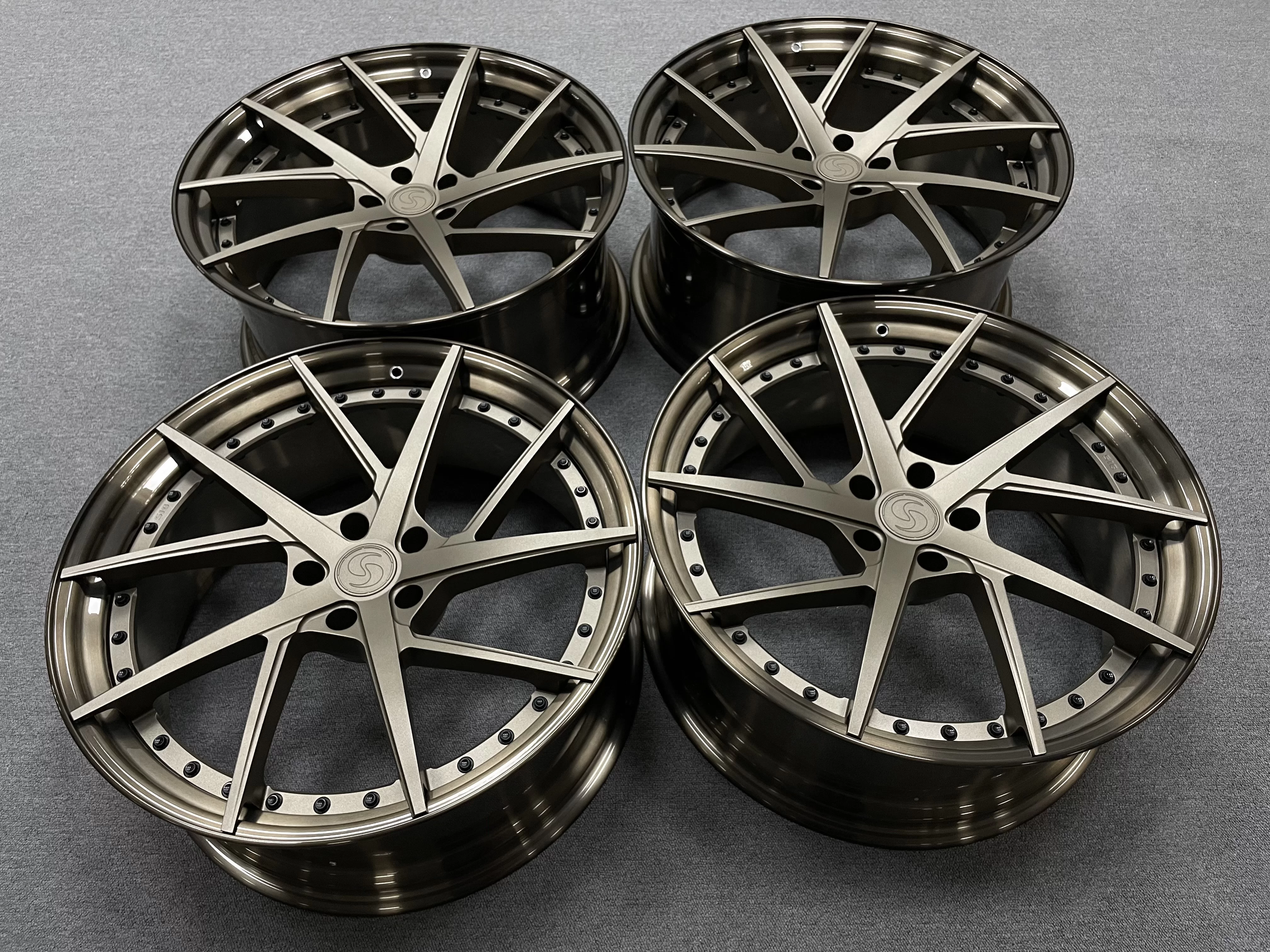

Creating a thread for those who are interested in putting aftermarket wheels on their Gravity. I run aftermarket wheels on all my cars.
Here’s some insight.
Currently having 3-pieces forged wheels being made by a local wheel company I’ve worked with before, located and manufactured in Anaheim, CA. FEA testing done to insure the wheels are rated for the Gravity’s transmission ratio and torque.
OEM 22/23” wheels sit flush to the fender when you put 20MM spacers. This gave us a better idea of how much offset we need for the custom wheels.
Specs for OEM 22/23”s are:
Front: 22x9.5 ET44
Rear: 23x10 ET51

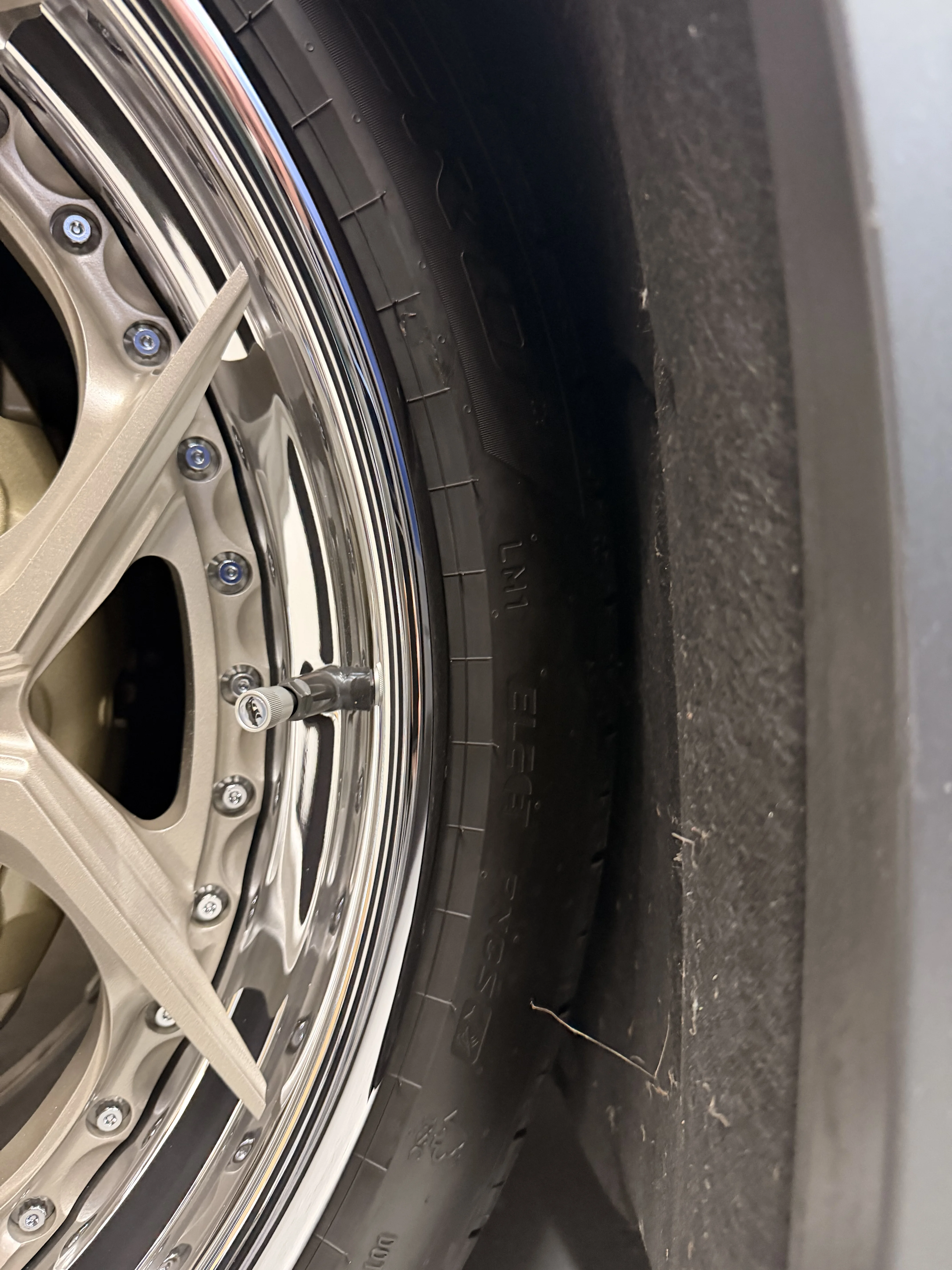

A concern we ran into when measuring offset was that the fenders protrude a decent amount, which makes the gap between the tires and fender very tight when you turn the wheels. Similar fitment challenges can happen with Mercedes-Benz Wheels as well, where getting the right offset is important to avoid rubbing while maintaining a clean flush look.
We decided to run +15MM offset on the customs instead of +20MM just in case I rub. I’ll run a 5MM spacer if 20MM doesn’t rub.
Running same 22x9.5 and 23x10 and reusing OEM PZero tires. Projected mid-December for completion. Will post more pictures as production progresses.
