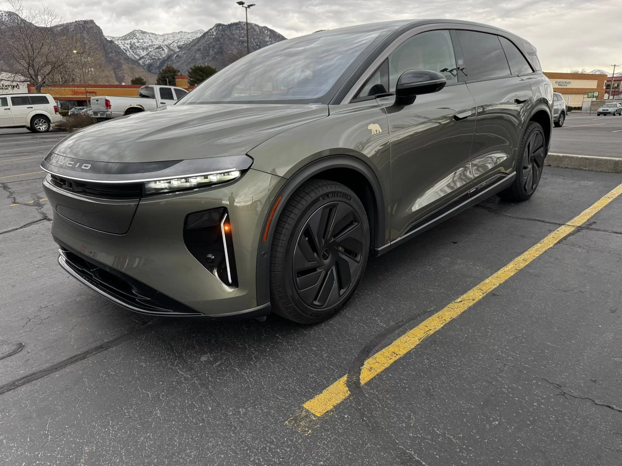

Going from stock 21"/22" wheels to my winter wheel and tires tomorrow (ordered from TireRack and delivered to Discount Tire for installation). Will take some pics of before and after. The new wheels and tires will be the OZ and Hokians for a dedicated winter setup.
before wth 21'/22" wheels:
After the OZ wheels and Nokians (20"/21"):

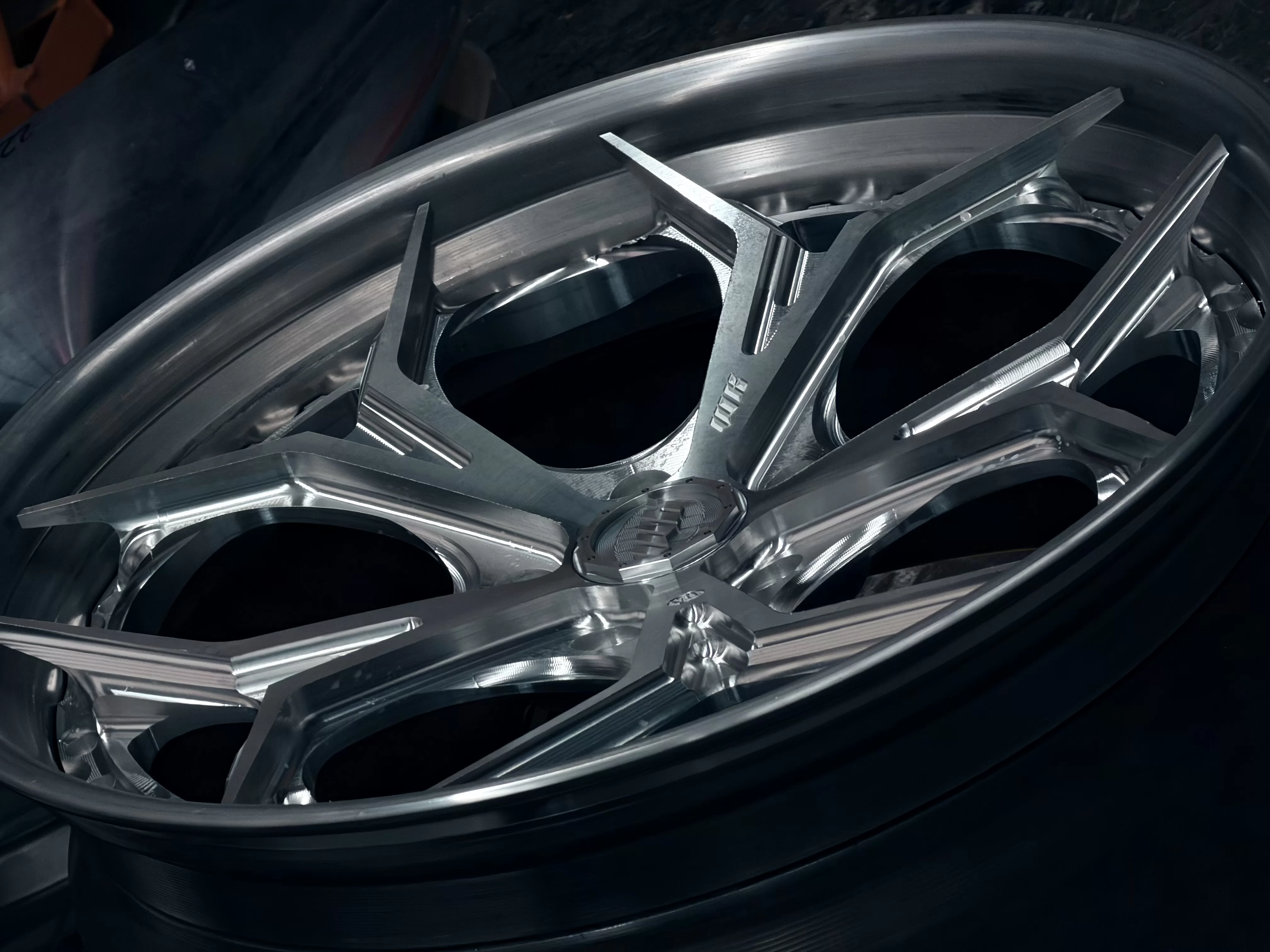

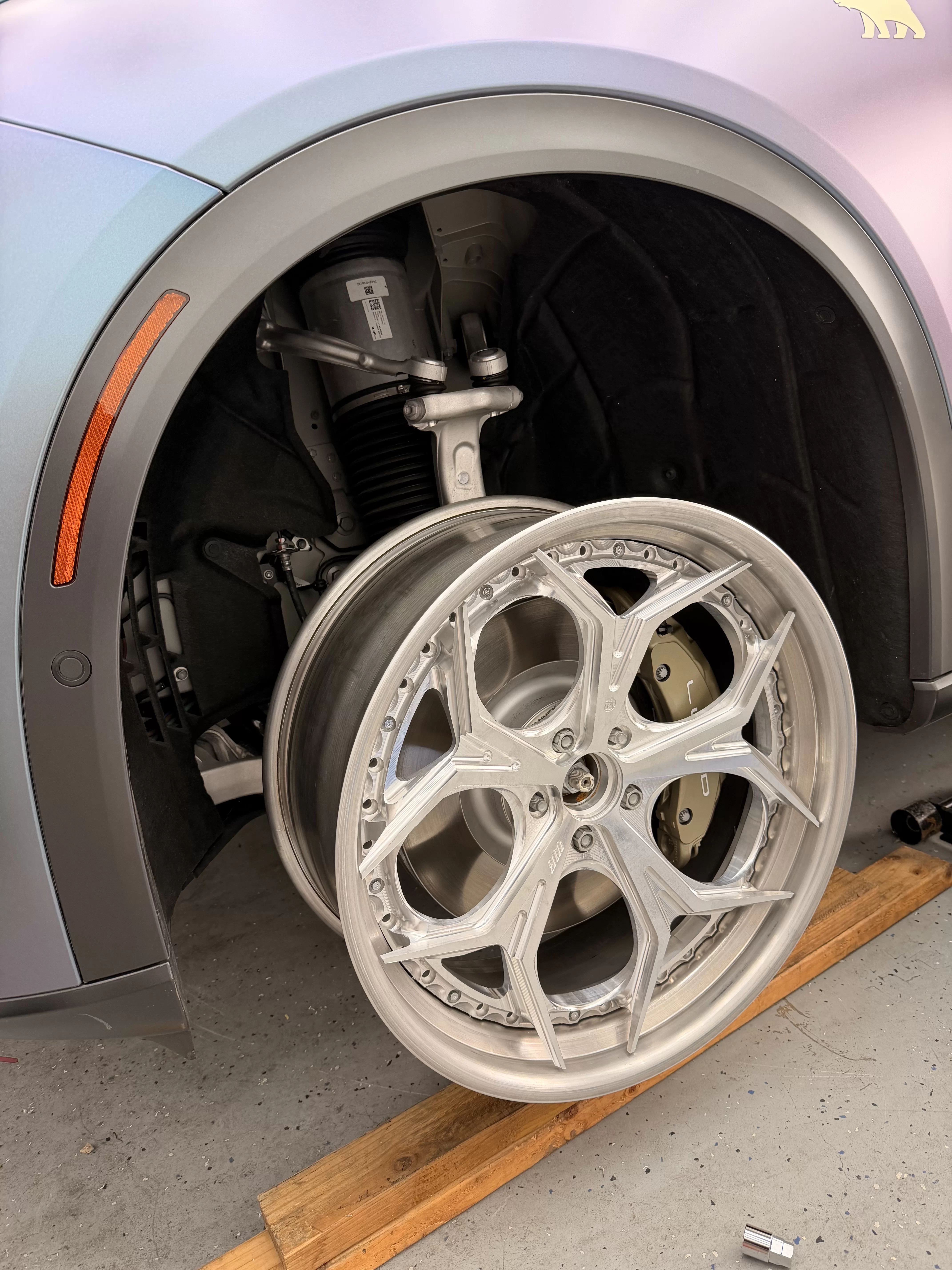

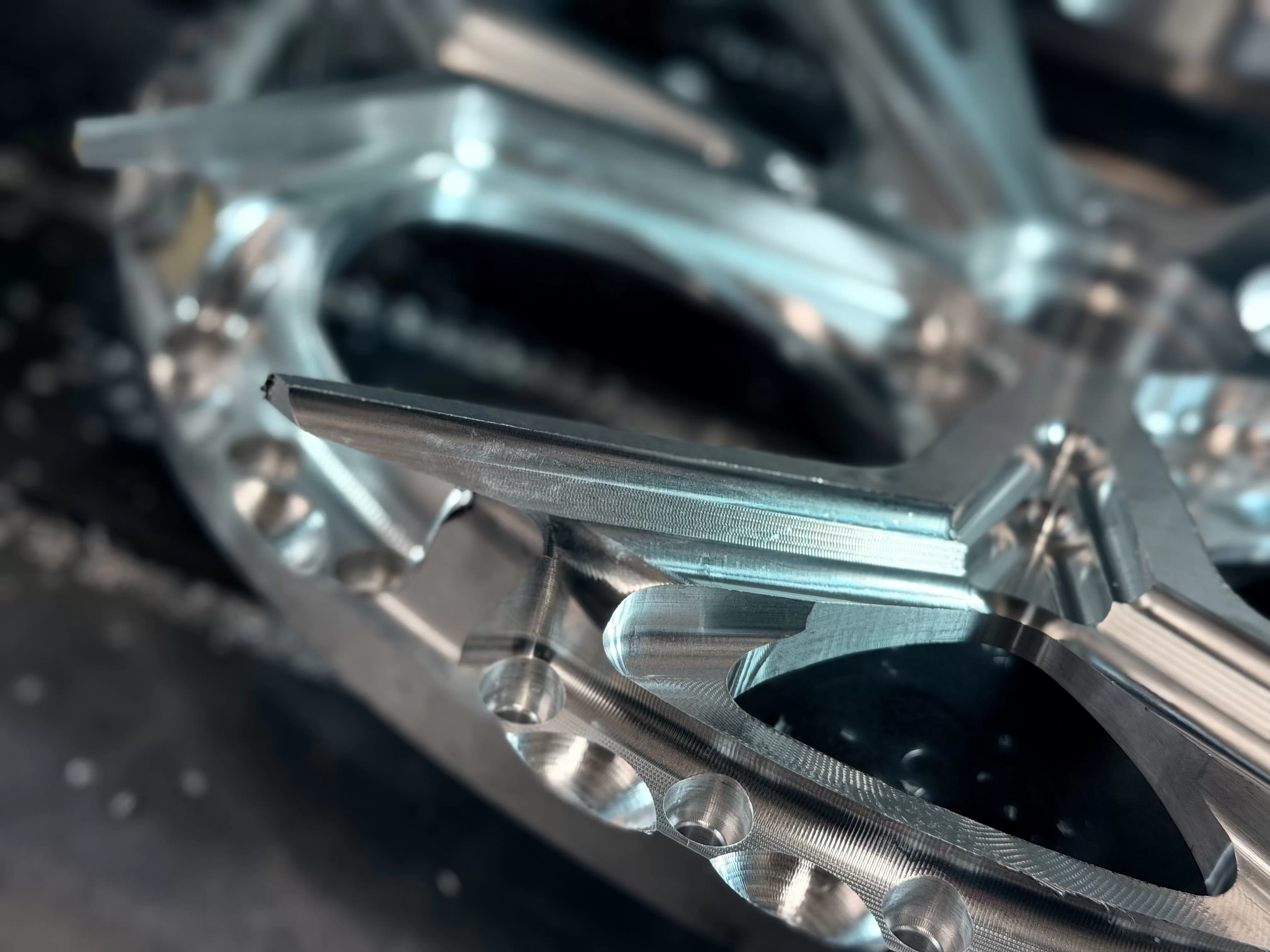

Wheels have been sent for finishing. Center will be powder coated in satin “performance gold” and the lip will be finished in chrome.
Final specs result in flush fitment at “low”:
Front: 22x10 ET24
Rear: 23x10.5 ET31

What tire are you going with?
I get that you want the wheels flush, but good chance the tire will poke well beyond the wheel unless it’s the Lucid ridiculously narrow tire choices.
Actually going to reuse OEM so stretching the tires to get rid of the bulge with the additional 0.5” width.
What’s the weight on those?
It was 33lbs without full hardware so I guess around 38lbs after.
technical details aside, they are beautiful wheels! Nothing as cool as 3 piece wheels and the open view of the calipers is awesome. Lots of curves, angles and depth on the design itself and I love the satin gold with chrome lips. Bravo!
Looking forward to the finished product. If I was to go again, I was considering 295/35 on a 10” front at 30 offset and 315/35 rear on 11” at 40-44 offset.
Would improve handling and braking and make efficiency even worse…anyway, not a today plan.

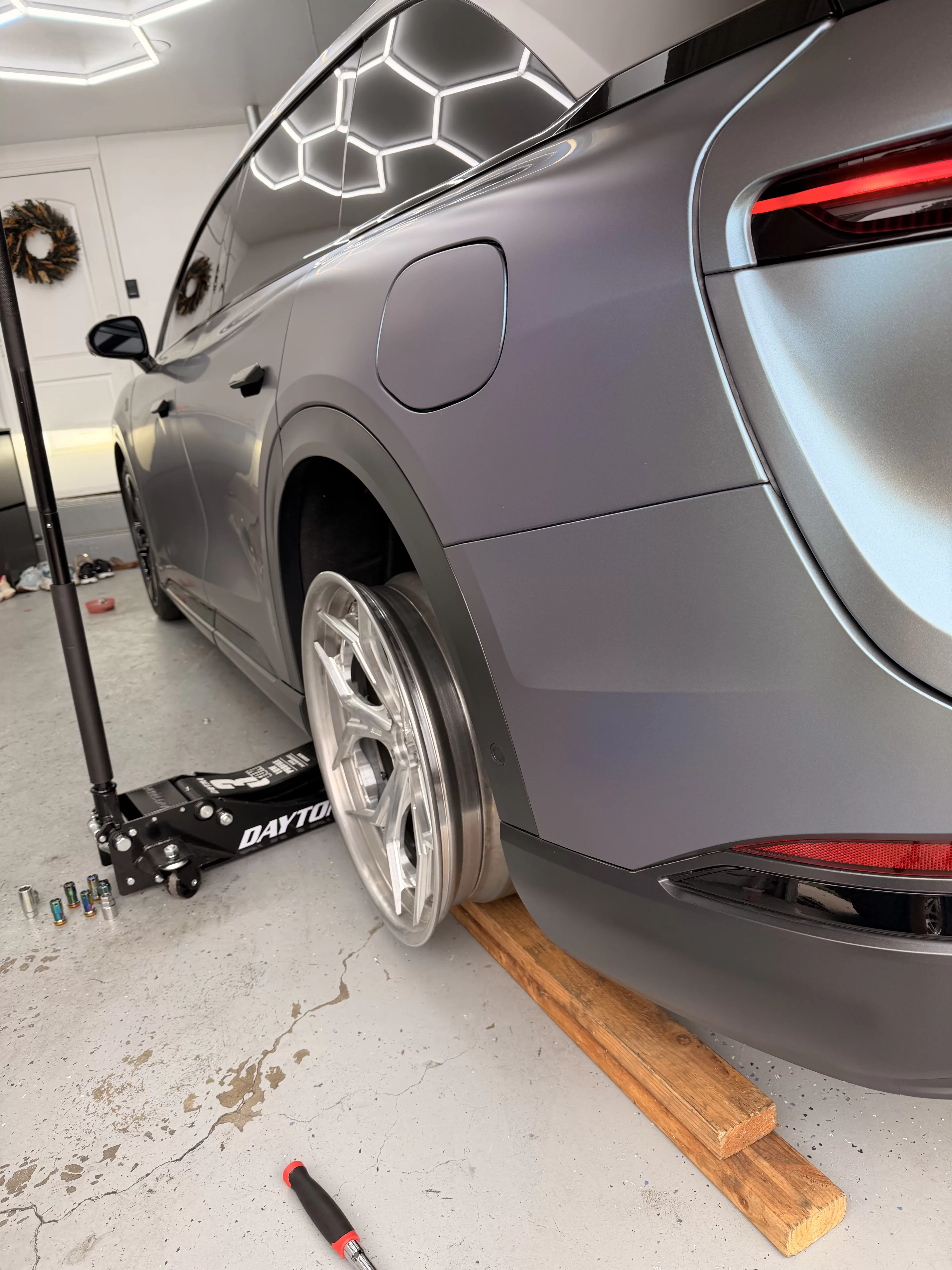

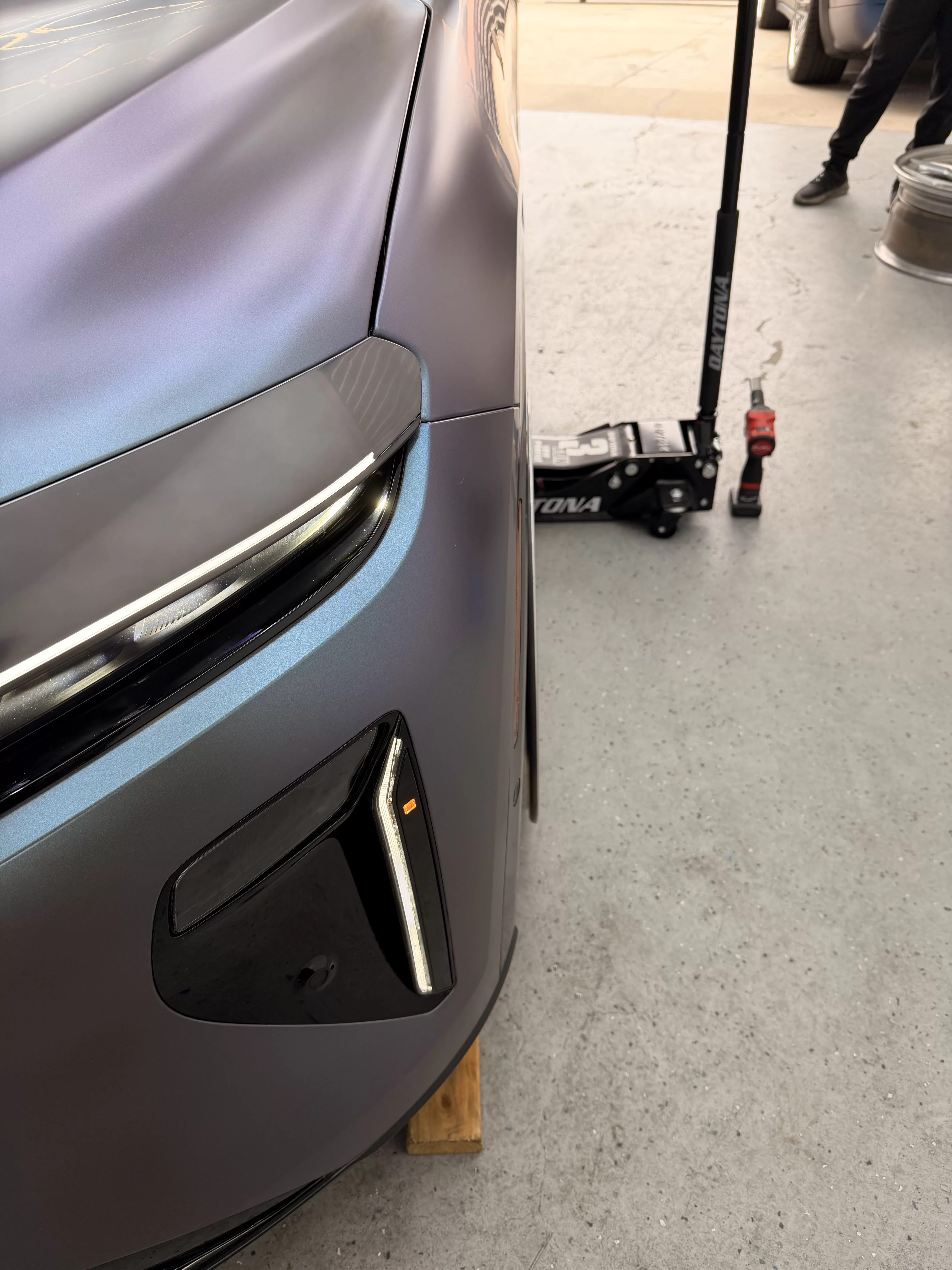

A few more photos of mine, only 2 show up out of 8. I guess photo size block…I got more in my FB group.

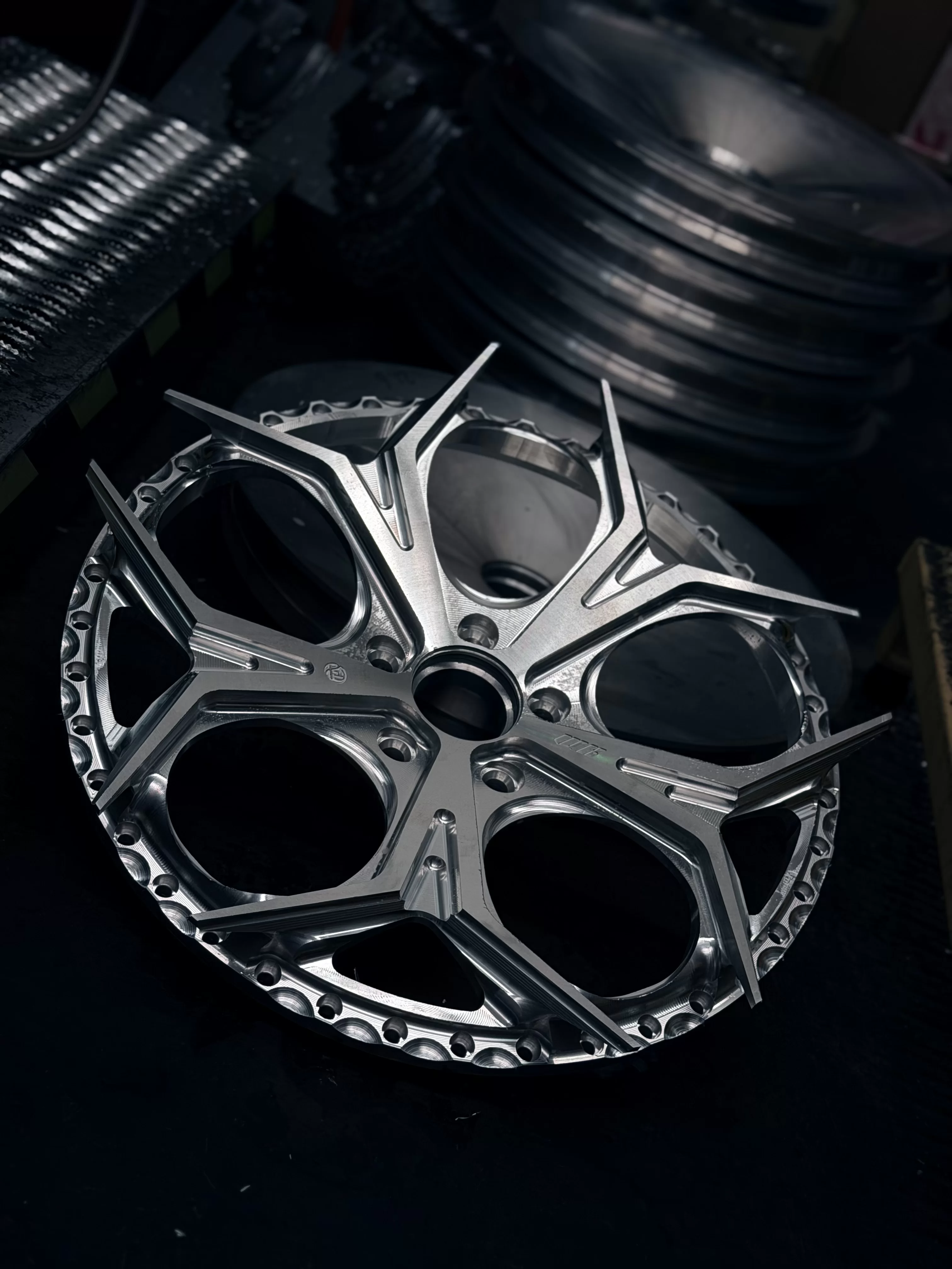

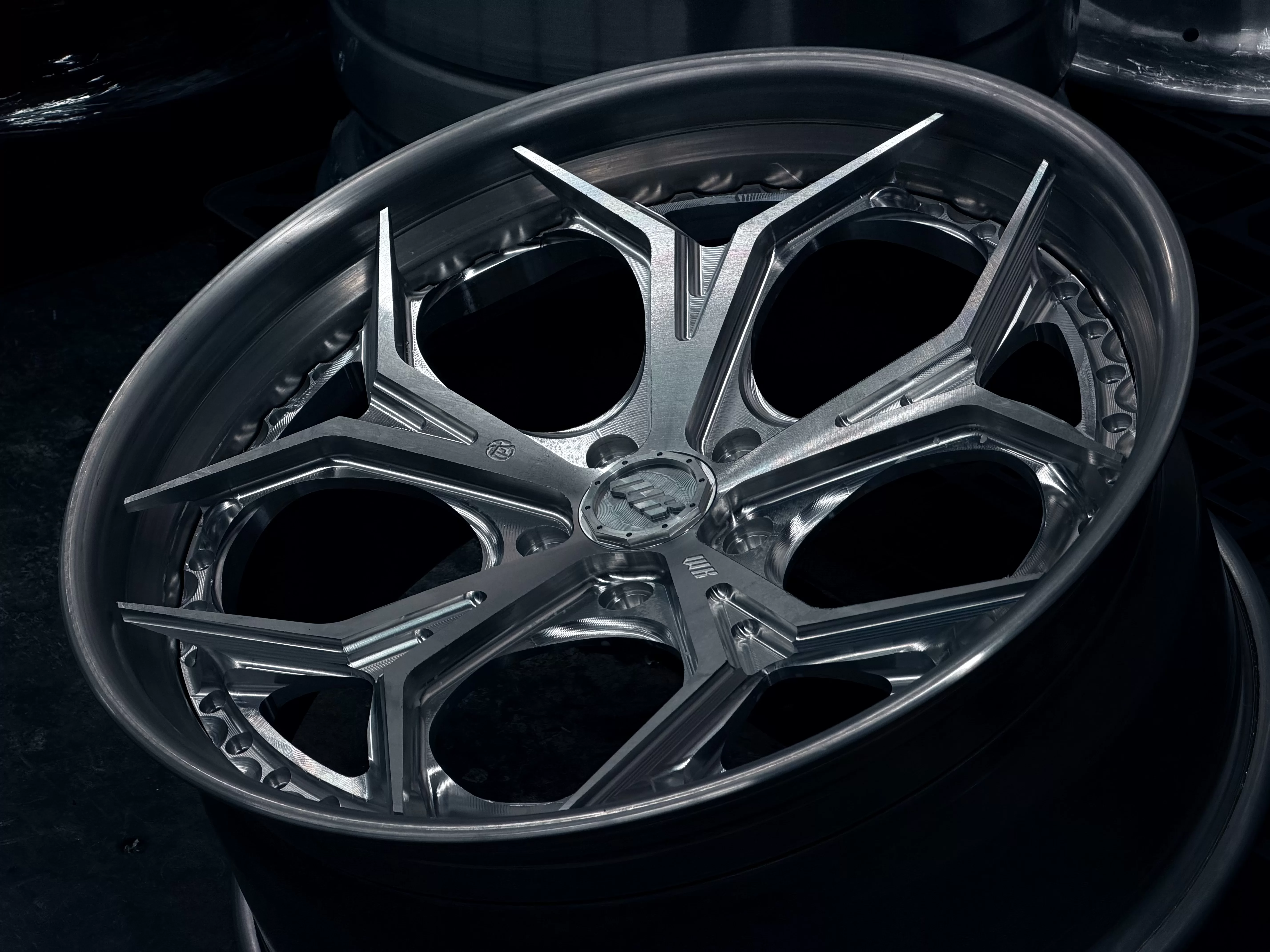

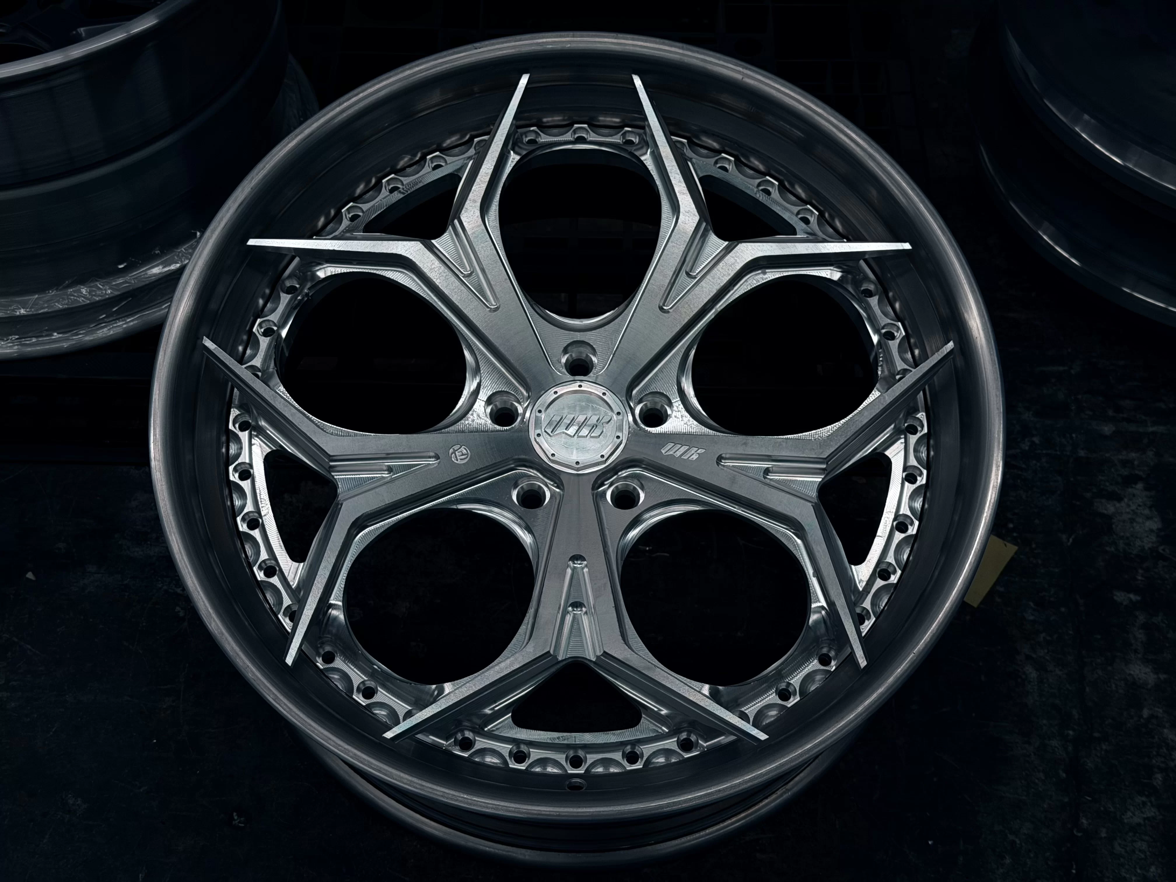

My custom wheels are ready to ship from China.
Although, the Stealth/Dark-Grey color wasn't done as in the 3D model.
I've asked the factory to redo coating to match provided 3D model.
Aside from the color snafu, they look amazing to me.
Cannot wait to install them.
They are now listed on their site.

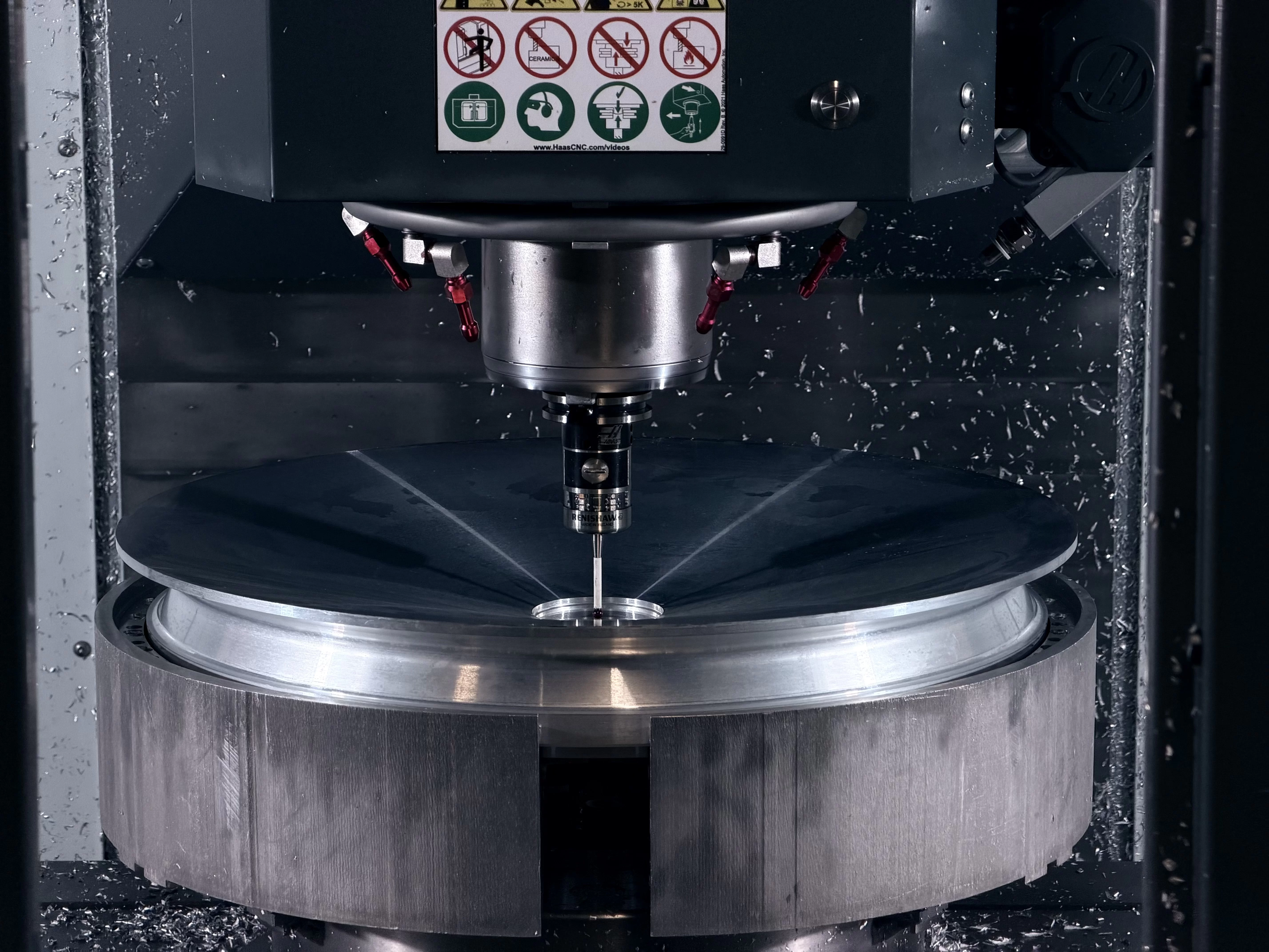

They are 50.5lb (22.9kg)…YIKES!!!
That’s at least 10lb heavier than OEM 22/23”.
The extra black aero-effect Aluminum parts definitely threw off the weight. Oh well, that was the wheel design I wanted.
I am not concerned about the range penalty.
It’s the handling and driving dynamics that I am worried about because of additional unsprung mass. Hopefully not too perceptively negative. We shall see in a few weeks.

That’s heavy…did they mention if the load rating changed? Not obvious if this made the wheel stronger or weaker.
