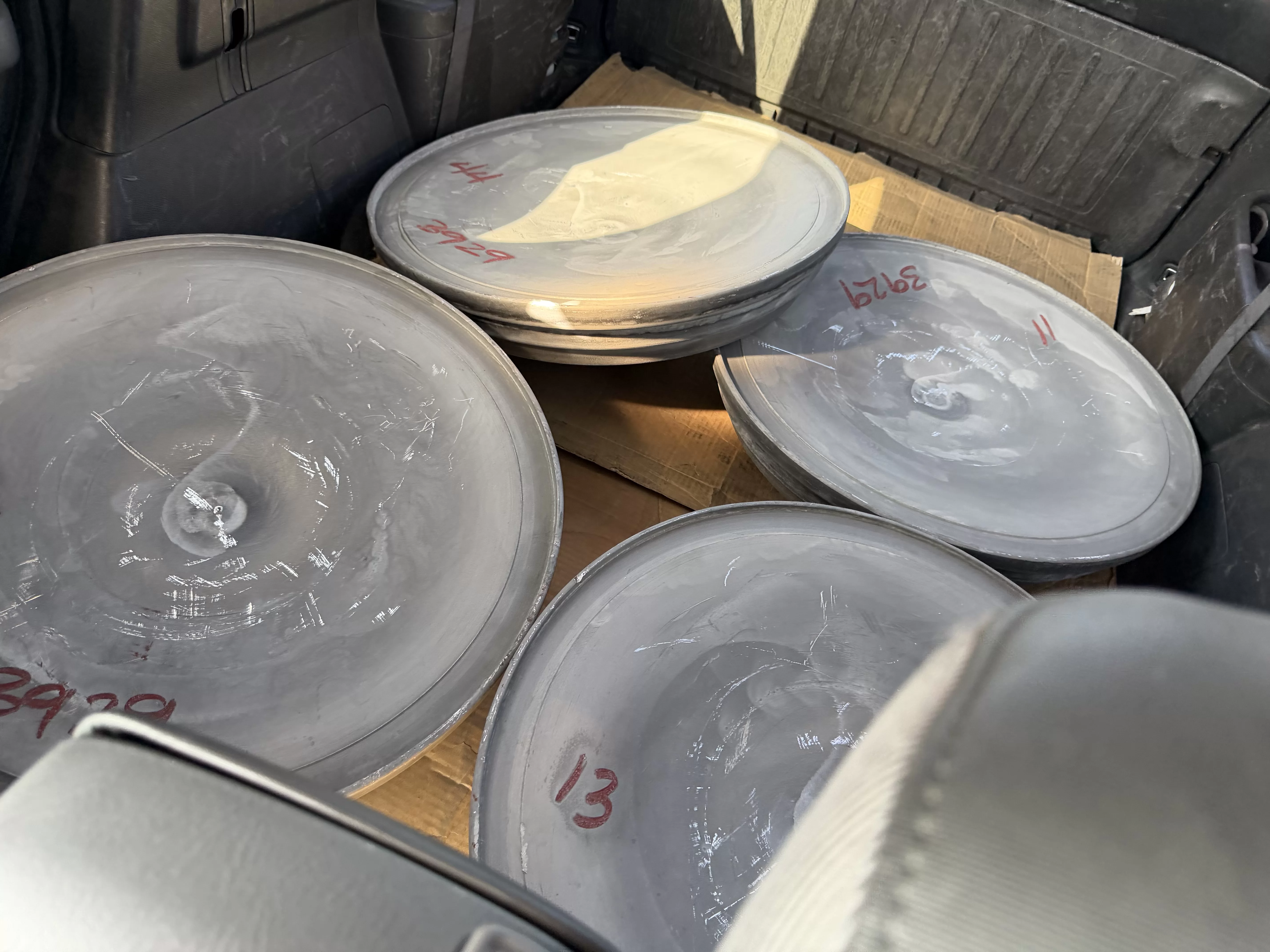

Forging materials for the center has been picked up. They’re 150lbs in raw material before they’re machine milled!
Guesstimated end product weight?
CAD weight is inaccurate. I’ll weigh them when production is finished. It’ll be lighter than OEM.
